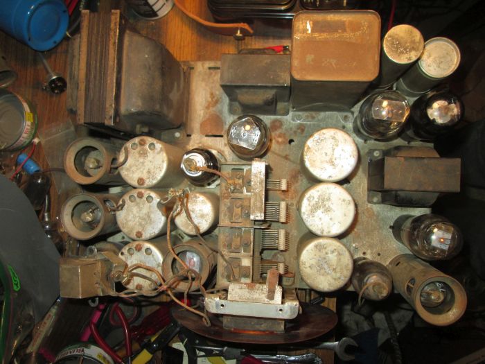

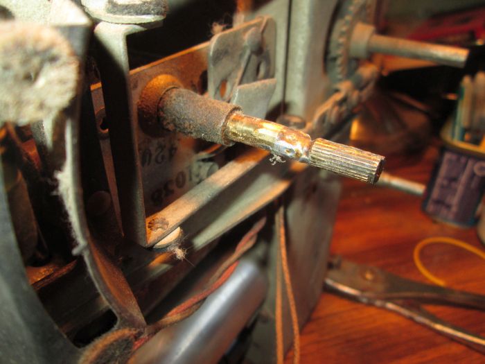

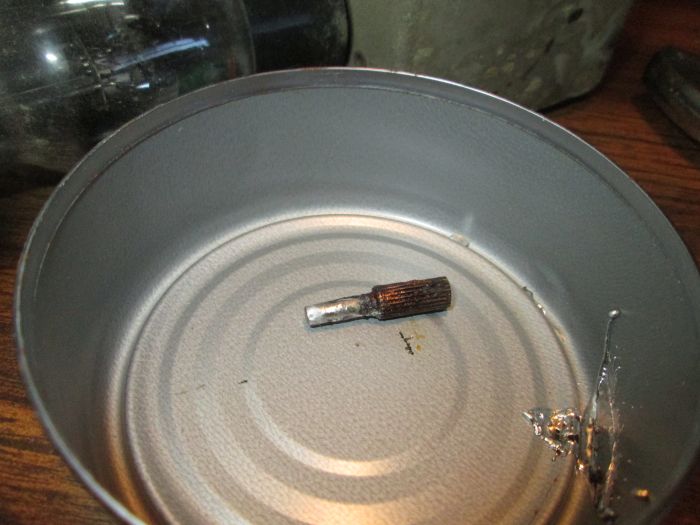

I think I my have posted a little about the chassis of this set but I'm back at it again. Received a parcel which contained the much needed dial drive. I have had the project up on blocks till I got a suitable replacement. Ed H came thru again in my search for 16B spares. Got the torch out and unsolder  the extension that was protruding out from the tuning condenser. Feels good to get that wart off of the chassis!
Glad to see those parts find a good home Terry Icon_smile

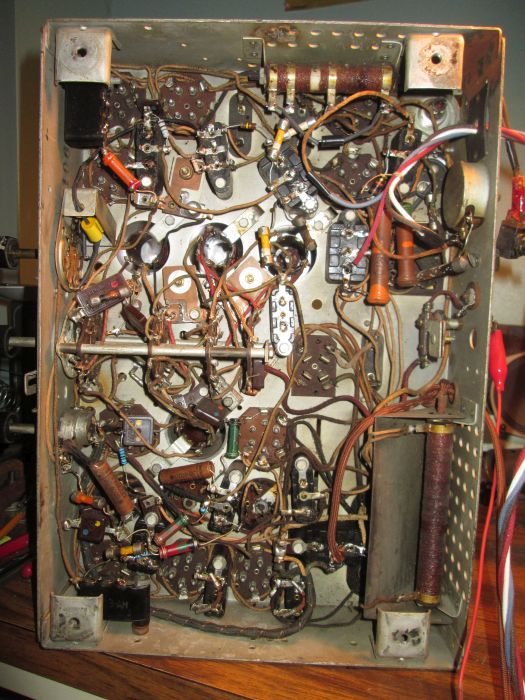

I put the little fuzzy glides on the bottom of the 38-17F and call it done for now and back to the 16B. Over the last week or so I've restuffed the bakelite caps, found one that had a cap and a 250 ohm resistor in it too, cut open the ecap and fitted it w/2 10mfd caps, checked the carbon resistors, rebuilt the five section bypass cap, and a bunch of other stuff...
The coneless speaker got a small pm speaker connected to it for test purposes and made up the speaker cable. Couldn't find a Philco speaker socket to add to the chassis at this point. For now it's just temporarily connected as it will be headed over to Sound Remedy.
Had everything wired up and the 80 in place flipped the switch and voltmeter swung up to 300v but no sound. Hmmm no plate volt on the 77 1st audio missing resistor. Fixed that had audio but no signal. Measured some random voltages and found the screen grid voltage for the mixer and IF amps was 30v hmmm seem lowwwwww. Put a pin in it and warmed up the generator and aligned the IF. It passed a signal but wasn't overly sensitive.
Now for the rookie mistake. I assumed that the set was working more or less when it was retired. I didn't pull all of the tubes and check them out. Someone had swapped a 6C6 for the 77 mixer, bad move. They have the same base connection and electrically are similar but didn't work at all in this set. Replaced w/a 77 and started playing fine. The 30v then up to 80v.
I did find one common thing that I was wondering about. On both of these 16's the 1st position of the tone switch seems to have some level of treble cut. Sound just a little muffled. I was fooling around with contact and sound brighten up. I'm thinking that there is leakage at that contact.
Still lots to do. Shadow meter bulb holder is broken, grommets for the tuning cap, a good clean it's filthy, fix up Rube Goldberg dial drive, remove the IF transformer covers and clean/replace grid wires, do like wise w/the rf coil covers, and maybe give the choke and driver transformer a lick of paint.
It's been playing for abt 4hrs and hasn't burst into flames or set my domicile on fire. Transformer is warm but not hot so all is good.

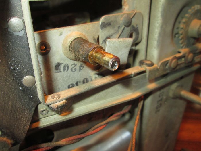

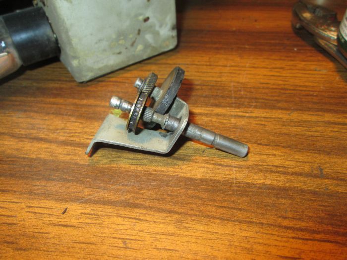

Replaced the tires on the dial drive. Two of them were made from neoprene parts. The tire behind the dial was the most difficult.  My next door is a plumber and I told him about my dilemma. He came up with this for me.  https://www.fernco.com/dimensional-drawi...56/1056-22  Was made from made of neoprene. Cut off a slice about 5/16 wide and it fit great on the back of the dial. Only one problem too thick GRRRRR. Made a jig to mount it and spin it to sand it down about an 8th or 3/16 of an inch. Was a trial and error process. Shifts from low to high dandy.

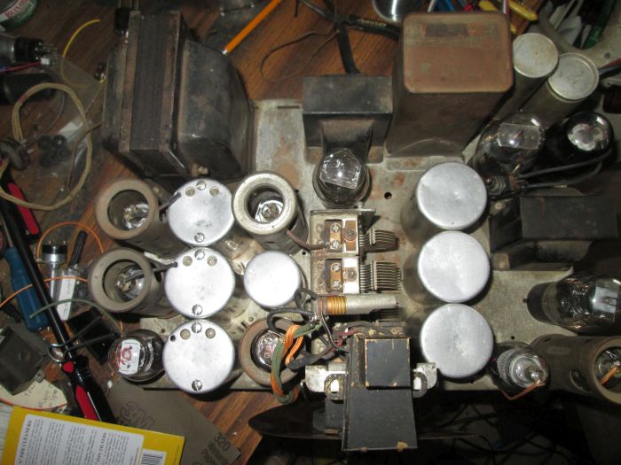

Next adventure was cleaning up the top of the chassis and the tuning cap. Removed the cap took apart the trimmers and give it a wash in mineral spirits then a spray of tuner cleaner. Added new wires. Removed IF cans to clean and replace wires. No broken ceramic this time. Clean rf coil covers. Put it all back together new rubbers under the cap. BC alignment went fine along with bands 2/3. 4 and 5 were a problem SURPRISE!!!! Trimmer all the way in dial was about a mc out. After fussing with it for a few hours I found the problem. It was not a good problem but is guess that's it's called a problem!

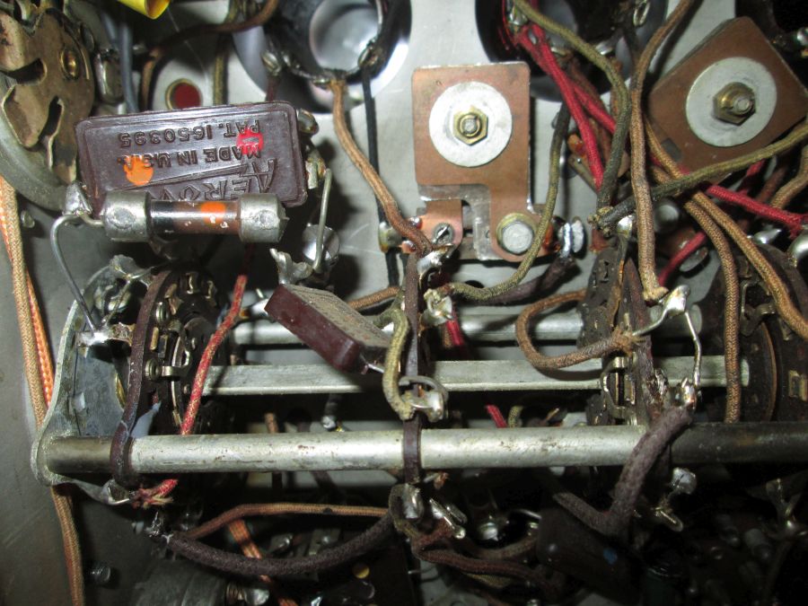

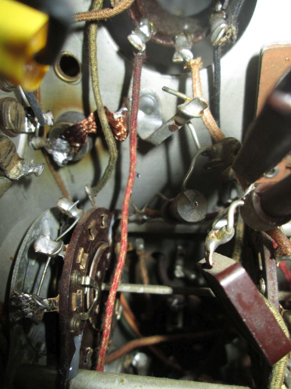

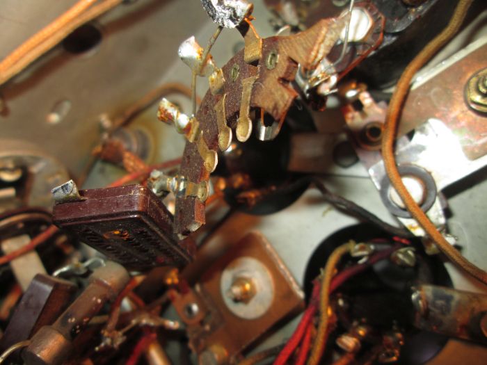

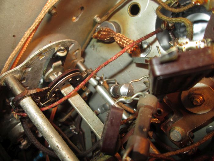

Here's some pic's. I think I broke the the band switch when removing the front hex screw that holds the tuning cap in place. It's kinda tight there and a somewhat large 3000 mmfd mica & 10k resistor are soldered to the switch. If you bump the cap you can break the wafer. Trust me on that.
Fortunately it didn't break at  the spacer and there a bit of wafer left on both sides. Access is good once the mica cap is cut loose. It's 3000mmfd 3% I searched online and found a 1% job, I may bite the bullet buy one as it's abt 1/5 the size of the original.
Next have to read up on the do's/don't on JD weld. Cleaned up the wafer last night. I have some of the Kwik setting weld (6min) cures in 6 hrs. Don't know that I believe that I would let it go for a few days at least. If any of yous guys have any comments please do.

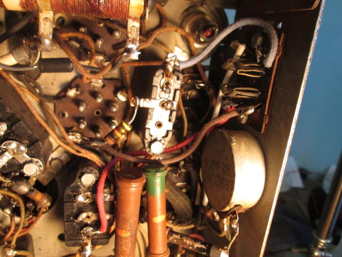

Still have the two fastenstock clips on back to fix, all bent up. Add plug for spk. Found one on my 200X chassis I've decided to part it out it's just missing too much stuff that particular to the 200. Probably can render some parts for the 201X but the rf and if sections are pretty different. Recone spkr and finish cabinet and it will all done!!!!

The bandswitch is back together and connected. Started to do the oscillator alignment and it's back to it's old tricks again.

I know all yous guys like pics so here's one of the bs all wired up and working.
