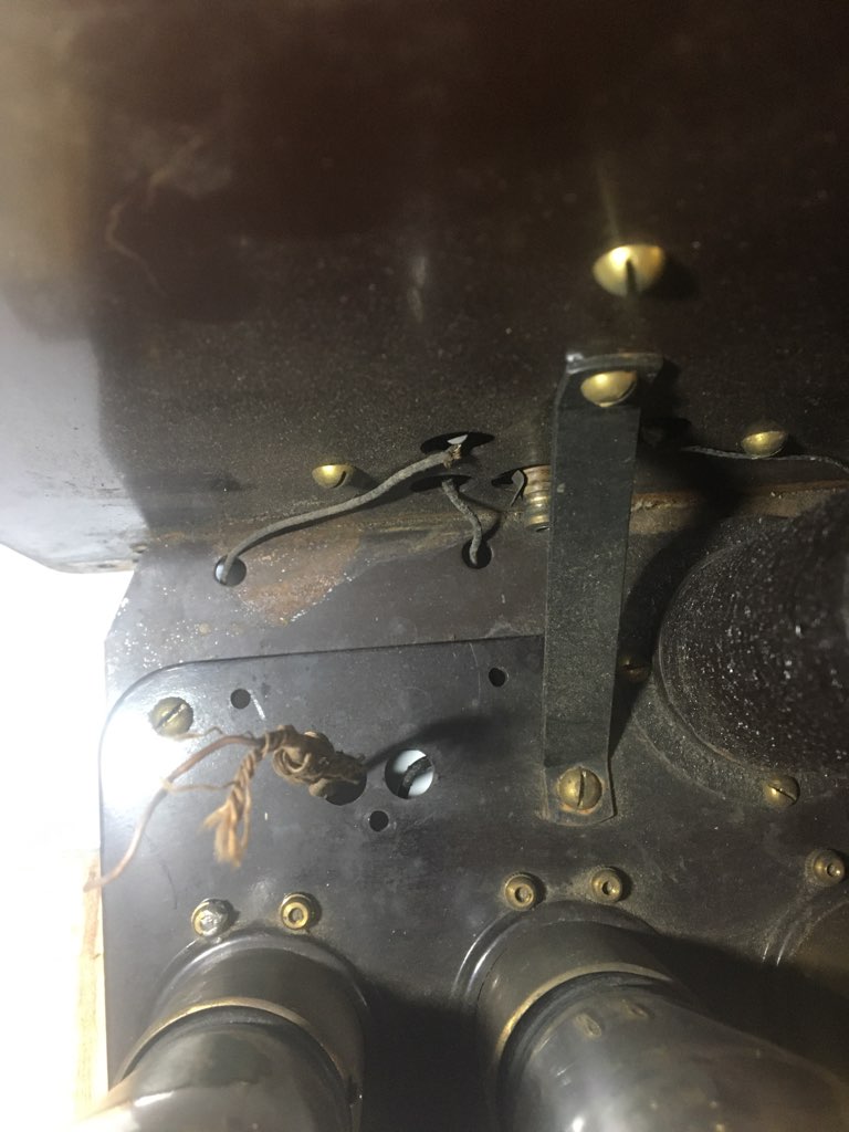

Thought the added tail might be for strain relief, but could find no point of tie off in the speaker base or radio case. Am making a 3/4" wooden speaker base extension since my mason jar mod. is a bit taller then original. Could easily mount a tie off hook there. Same with the radio case.

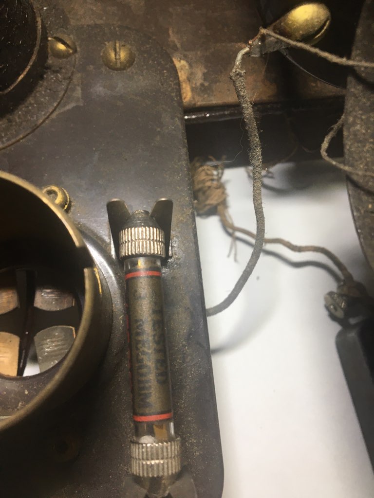

The grid leak resistor is labeled AEROVOX,  fixed grid leak, Tested 3 Meg ohms, but tests 6 meg. now. When it comes time to fire the radio up was going for giving it a try as is and see what happens.

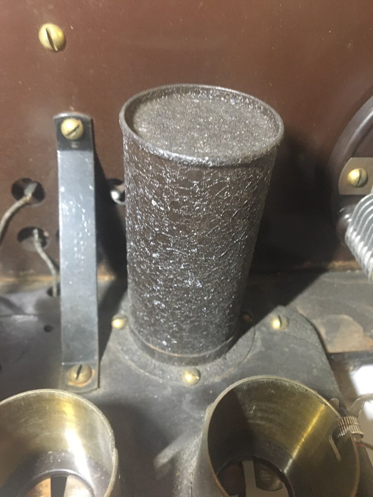

The "markings" on the radio chassis for the missing audio transformer indicates it was physically the same size. At least as far as the mounting holes drilled through the chassis  and case diameter shadow left in it's place. Have noted all your recommendations for replacements in the future . Would be nice to keep original look and function.

FWIK the A-K grid leak uses a holder with a smaller clip O.D. more like fuse clips. The A-K leak has a shoulder on the inside edges of the metal electrode ends that co-inside with the spacing of the electrode clips. The A-K leak is a smoked glass rod within a hollow glass rod "soldered" into the ends of the electrodes. I have not been able to determine how the solder grabbed the glass, but it does... The A-K leak can be "re-built" the ends are de-soldered and retained. a length of borosilicate glass tubing is prepared by torching the cut ends to smooth the glass. The electrodes are cleaned of solder and a twist drill is used to ream the ends to remove all the solder and a small amount of the brass, enough to allow the new tubing to fit, re-cut the glass tube to make the exact length as the original leak. A 1/10 watt 2.2meg axial resistor will slip inside the new tubing. Drill a hole at each end of the electrode to accept the resistor leads. Solder one end of the resistor to center it in the combination of electrodes and glass, the complete by soldering the opposite end. A touch of super-glue will firm up the electrodes to the glass. The resistor can be blackened with a sharpy to disguise that it is modern. A lot of work for appearance sake.

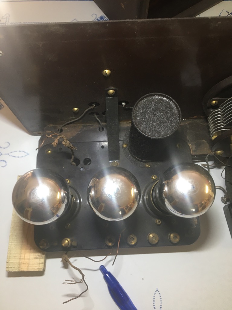

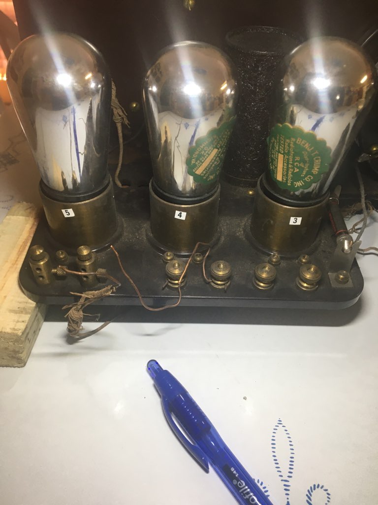

I wanted to see a pix of the three tube island not only to see the transformer location but if the OEM A-K grid leak clips are still in place or have been broken or removed so the Aerovox leak could be installed.
BTW that value of 6 megs leak is still O.K. the detector will not be cut off just more sensitive.
Post the diameter and the height of the A-K transformer existing and take resistance measurements of the two windings, post as well. Use an analog meter if you have one. I will look and see if I have a suitable transformer.

Audio transformer diameter measures 1.65 "
Height of canister 3.34"
Height of canister from top of canister to bottom of mounting flange 3.38"

Not sure, but this is probably as good a match as you will find. If you have the original can and windings. You can remove the original windings, and mount this on your iron core. Read the reviews of the product, and contact A.E.S. with your information and see if it will serve. If you do not have the original can and iron core, just order the whole transformer and mount it as best you can. You won't be the first...  https://www.tubesandmore.com/products/tr...bly-p-t156

If you decide to melt out to save the old can be aware that the A-K core is a group of iron wires. It would be best to use a transformer complete with its modern, low loss lamination core, both will fit into the A-K can. Wound bobbins should only be used where the entire OEM frame and laminations are exposed.

I found the A-K transformer, unfortunately the dimensions are wrong,
It is 2-1/2" diameter and 3" high, ratio is 5:1 at 2khz, DC resistance is 1k primary and 8k secondary.
This is a good 1st audio transformer but the physical diameter may collide with the detector tube socket.

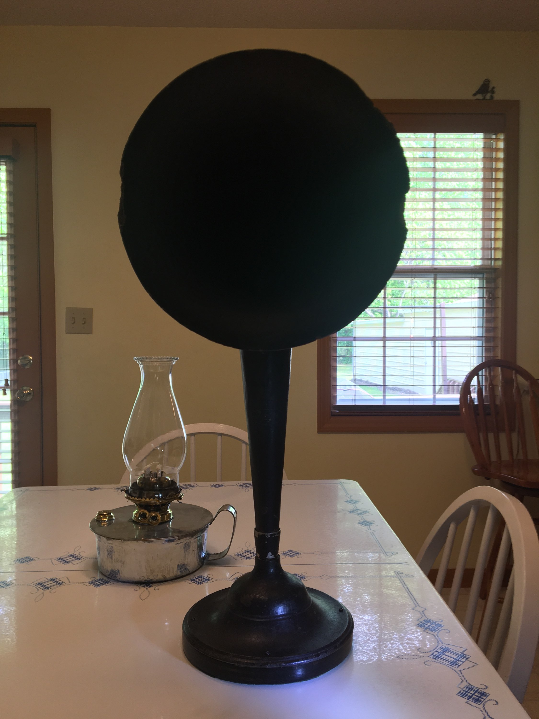

Pic of base with 3/4" wood extension added so base doesn't rest on cord or mason jar mod. If it's not very noticeable that was my goal.
Nice work!

This one also. Have a brown paint thats not quite dark enough. Will add just a touch of black for a better match to the neck of the base. My youngest daughter of many talents is also an artist. She will watch my feeble attempts for a while then say something like, try a drop of orange,and it will be near perfect.
Who knew??
There will come a time to address the rough edges of the horn. But for now just happy it works.
