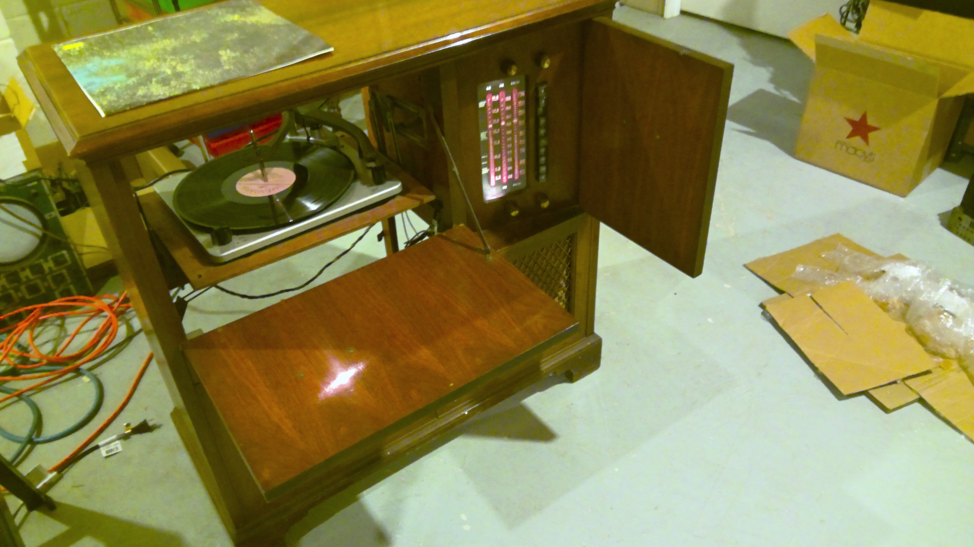

Today I rewired the cabling to the turntable.
I realized that the shielded cable that had two wires in it was not shielding them well: when the wires were cut flush with the shield there was still a significant hum when the cable was attached to the radio input.
I took two well-shielded wires, ran them as a dual cable, used the two centrals as the signals, one coming to the GND, and then the shields bringing GND to the turntable's chassis.
It quieted the whole thing down quite a bit. The hum (at maximum) was not overwhelming in the first place, but what I did reduced it quite a bit. I also pasted copper adhesive foil over the wires that go from the switch (that disconnects the cartridge from the cable) to the tonearm (about 2 inches or so, so it was picking some noise) and soldered a short wire that I also attached to the GND I brought to the turntable's chassis.
I think I will stop my further attempts to reduce the hum as now it is not really pronounced anymore even without the music, and when playing, even not loud, it cannot be heard at all.
Time to put it all back together.
#78
Have put most things back. Putting the chassis is a bit involved, especially top inner screw. I wrote about my knuckle hurting when I was unscrewing it - now it hurt when I was putting it back. Hole alignment, considering wood-to-wood rubbing, the chassis weight and the play is also a bit tedious.
But it went back where it came from.

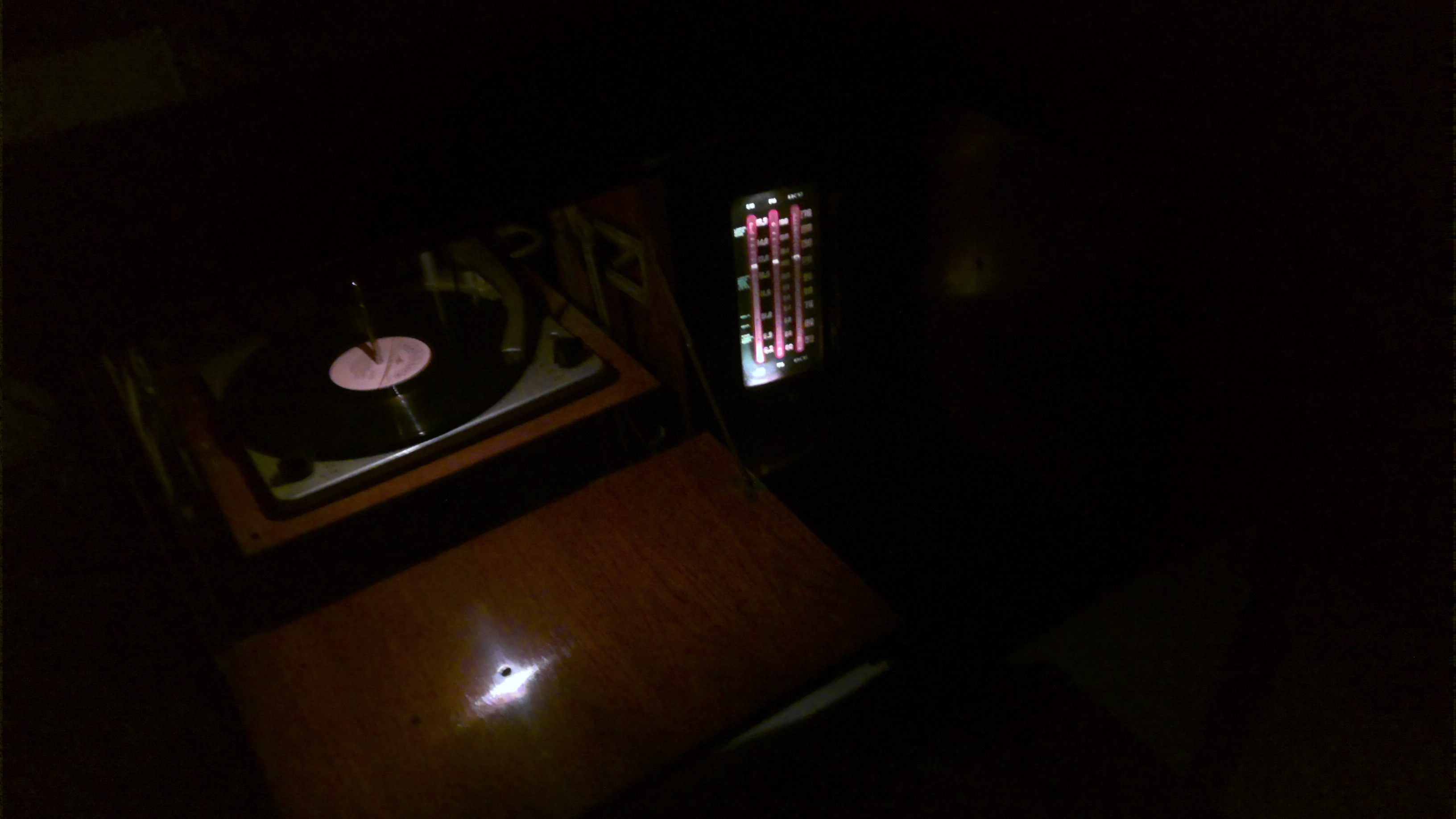

The cabinet added depth to the sound and it sounds very nice. The phonograph also sound pretty good as again, added base helps.
I have found out before, the base regulator does not work with the phonograph. And this is not a bug, it is a feature. When I used a tablet as a source of music, it was the same exact result. However the base works just fine when the radio is playing. This tells me the Frequency plot of the phono amp would probably show real dip in the low frequency area.
I have a few lights and a switch to mount back, and this will hopefully be it.
