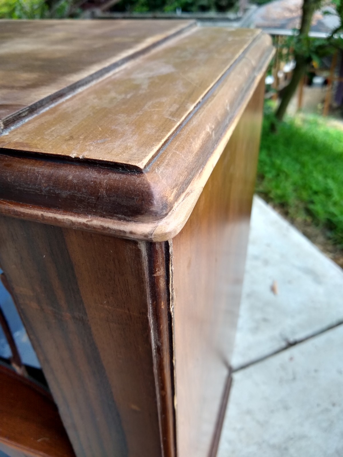

Cabinet work this weekend. I don't object to some patina, but chunks missing are another matter.
The surface was carved and worked flat, to enable gluing of a repair piece.
Careful carving and sanding restored the profile. Staining and detailing will ensure a match. I'm pleased with the results so far.

Lots of things getting in the way, so I haven't made a lot of practical progress on the radio, save for a bit of experimentation with toning/staining the cabinet.

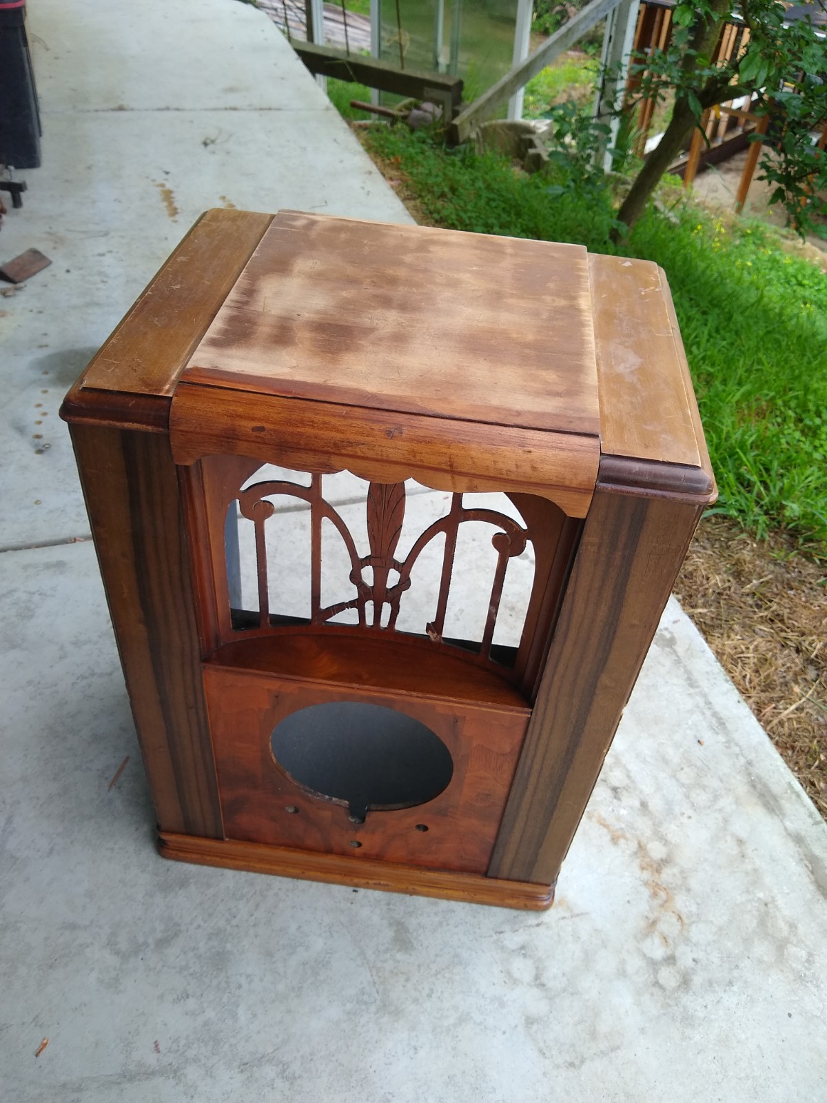

Here's the latest view of the cabinet. Yes, I still need to repair the grill, and will likely work on that this weekend. I have a section of material cut to shape, and on some similar material, tested the wood stains I have and found one that provides a nice match.
#33
Ed;
  Don't bother with the wood stain, the only type that works is penetrating stain or wood dye. Shading lacquer, such as what Mohawk or Deft sells, is what they used originally, and will cover up a multitude of sin in terms of stains, and repairs.

Arran - good advice, thank you. I'll look into the products you mention.

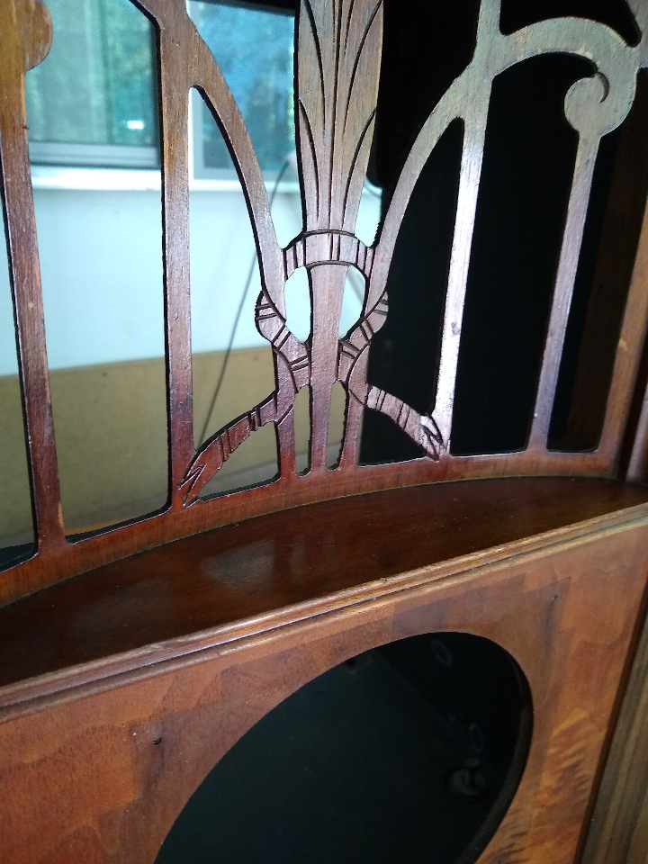

More progress today, and I think I have the repair to the grill to a satisfactory standard.
Here's the repair piece glued in. Where it joins the vertical bar on the right, I have marked out the carving required. At this point, there was still a littl shaping required to match its counterpart on the other side.
Very carefully, I completed the shaping, and carved the groove details
Then a little stain on the new wood, plus a little shellac, just to see how things are going to work out.
#42
It will never be perfect - or original - but I feel this has turned out well. The damage to this area was something that almost saw me walk away (but of course I couldn't in the end) and so it becomes a challenge. Then again, I have a hard time seeing 80+ year old wonders like this meet their doom.
