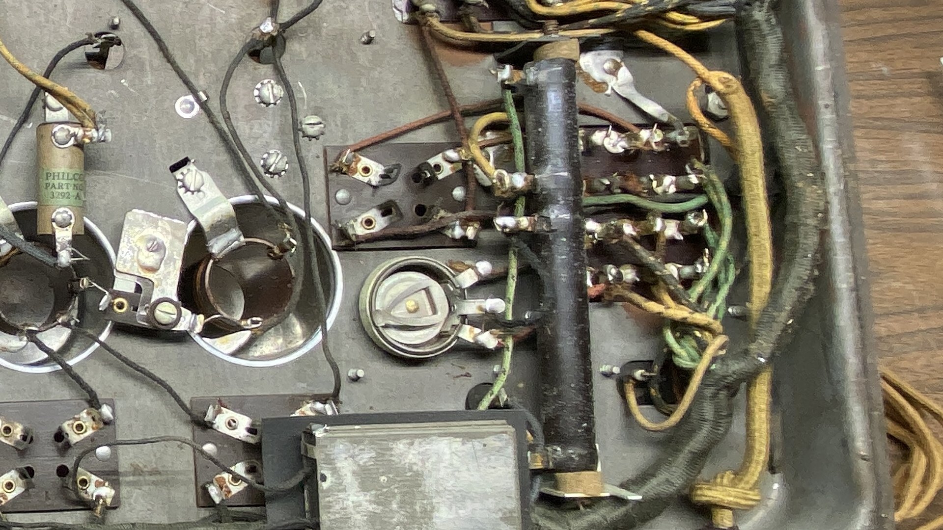

The resistor's sections are 3785, 157, and 640 ohms.
The 3785 ohm section is open.
A friend suggested that I scrape off the resistance wire of that section (only) and add a resistor across those terminals. However, the resistor is coated in ceramic, making that impossible.
Any suggestions? Since this is a cylindrical power resistor mounted by a screw and nut, it looks like this may be difficult to replace.

You don't want to just put a resistor across the open section as you mentioned in your blog. So if you did not use one of those terminal lugs but instead fashioned a separate lug epoxied to the ceramic so that it has no chance for a potential reconnection of the open resistor you could put a new resistor across to the new lug. Just a thought...

There is a tip that I've heard of but haven't tried. The theory is that the nichrome wire oxidizes at point of contact on the solder lug. Chip away a small amount of the enamel to gain access the oxidized area. Clean up the connection. Not sure how you reconnect nichome wire short of crimping or spot welding. Use a bit of JB weld to replace the missing enamel and color to match.
About the same time the 87 came out the National Company out of Mass produce a receiver called a SW-3 which a similar problem. Have serviced several of them have used Ohmite Divide ohm resistors. They have a side that the nichrome is exposed and slider that can be adjusted from from one end to the other. If more taps are needed add more sliders.

I have always thought it to be a combination of corrosion and mechanical movement. The nichrome can get super hot. Expansion rate is 14.0E6 + or - %10 (so says google) but the contact point with the tinned copper terminal, while being a heat sink, is probably going to have some ware/ expansion in that contact area. A crimp with some plyers SOMETIMES fixes it.

Here is the resistor in question.
I tried the crimp with pliers - no joy.
I then decided to do something else.
I'll be posting this on my blog in the near future, but you can see it right now.
Using my Ryobi "Dremel" tool - the best $5 I have ever spent, and yes, I bought it new on closeout, about 25 years ago - I ground through the outer coating and removed part of the resistance wire as shown. This way, I will be able to connect a new resistor (or resistors) to the original terminals, without worry of the original resistance suddenly becoming "active" again.
(H/T to Ed Locker for the idea.)
I will likely coat the ground-off area with J-B Weld before reinstallation. And, in case you were wondering, I did the grinding on the bottom side, where it will not be seen once reinstalled in the radio.
Ok. If you have followed this post thus far, I now have another question for you.
Given that Mouser Electronics has suitable power resistors in 3600 ohm and 180 ohm (which would add up to 3780 ohms, very close to the original 3785 ohms) and in 3900 ohms -
Would you replace the 3785 ohm section with a 3900 ohm resistor or with two resistors, 3600 ohms and 180 ohms?

I wonder if you could actually put 10W resistors inside of that sucker. The mounting bolt would have to move/change. Then drill holes out to the terminals.
My thoughts previously, were more inline with candohm construction. I would think that these would be subject to less corrosion.

Ron, I think I would go with the 3900 ohm, it would be within 5 percent of the original.
M R Radios C M Tubes
Thanks Steve. I'm going with 3900 ohms. Resistors (this 3.9K plus a 68K, 1 watt to replace the 70K resistor) have been ordered from Mouser.
Russ, the only problem with putting resistors inside the ceramic tube is that then you lose the ability to attach it to its mounting brackets. It depends upon a very long screw, with bolt, to hold it in place.
