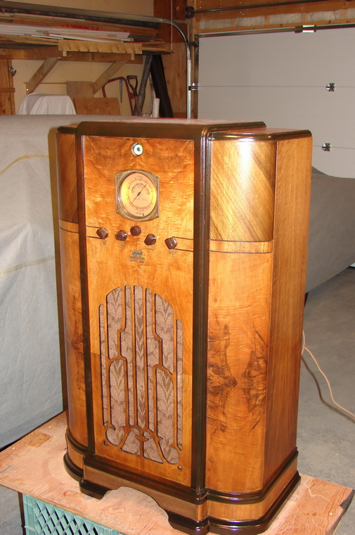

Actually, the very first thing I attended to was testing all the tubes. What do you know, they all tested GOOD, some in the lower end of good, but good none the less. The only one missing is the 6E5 magic eye tube. I already have two replacements in stock, and have 4 more on their way to me from Thailand, of all places, old Japanese stock. Eventually I am going to have to make a clamp to hold the 6E5. The original seems to be missing from the radio. No big deal. Just a little play time with sheet tin. That's what old cans are for. Now that the tubes are tested and out of the chassis, tomorrow I will begin some major cleaning up of the dust on the top and in the tuning condenser. Looks like another job for Dill's pipe cleaners. Then, on to those chewed up wires. I am pretty sure it was a chipmunk's nest. I found beech nut shells in among the debris. Chipmunks LOVE beech nuts.
Posts: 405
Threads: 108
Joined: Jul 2011
City: Calgary, AB, CA
Posts: 1,824
Threads: 114
Joined: Jul 2014
City: Sneedville, TN
Wow, Dan, Pretty radio !  Yes, it IS very similar to mine. You did a beautiful job on the cabinet too.  Thanks for sharing !

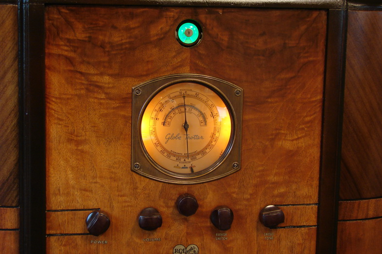

I did notice a problem with the "magic eye" It did not seem to be responding when I tuned in a strong station. I went back in, double and triple checked all the connections both in the radio chassis itself, and also inside the remote socket and socket cover for the 6E5 tube. I finally saw some loose strands from bad soldering IN THE REMOTE SOCKET which I hadn't touched until then. It appears that this was a problem waiting to happen since the day it was made ! I removed the stray strands, redressed the wires inside the housing, put it all back together, and the "magic eye" now works as it should.
