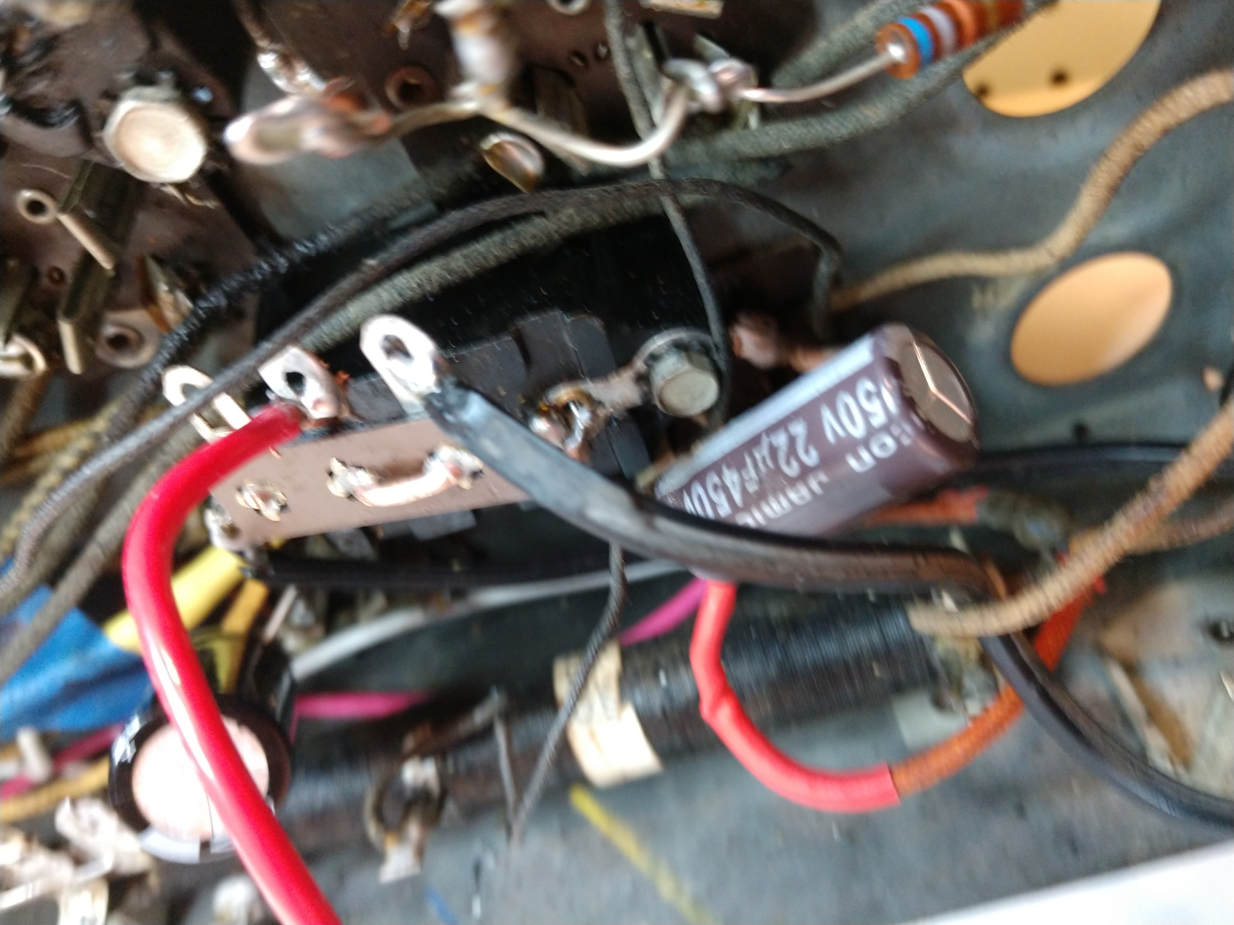

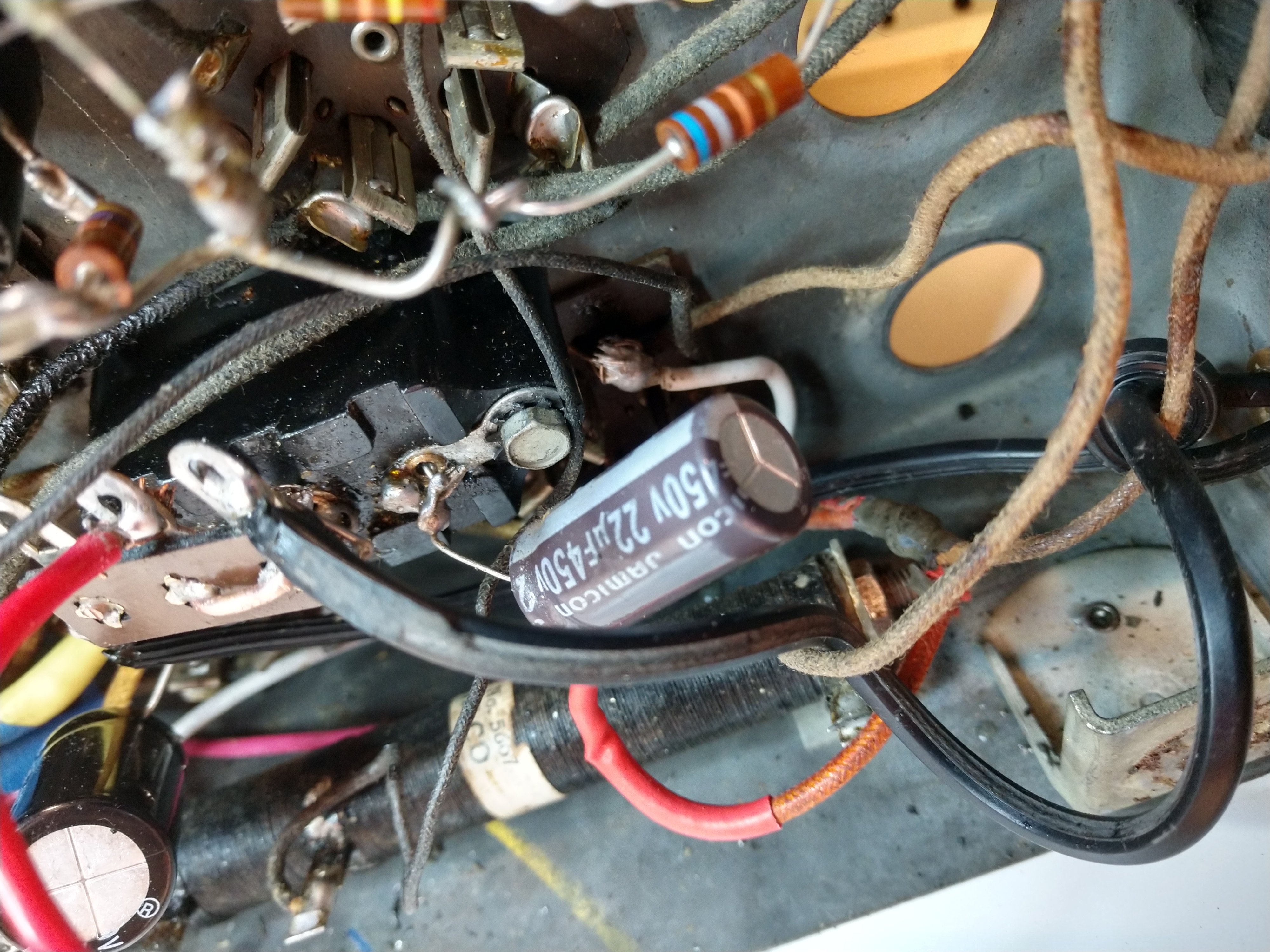

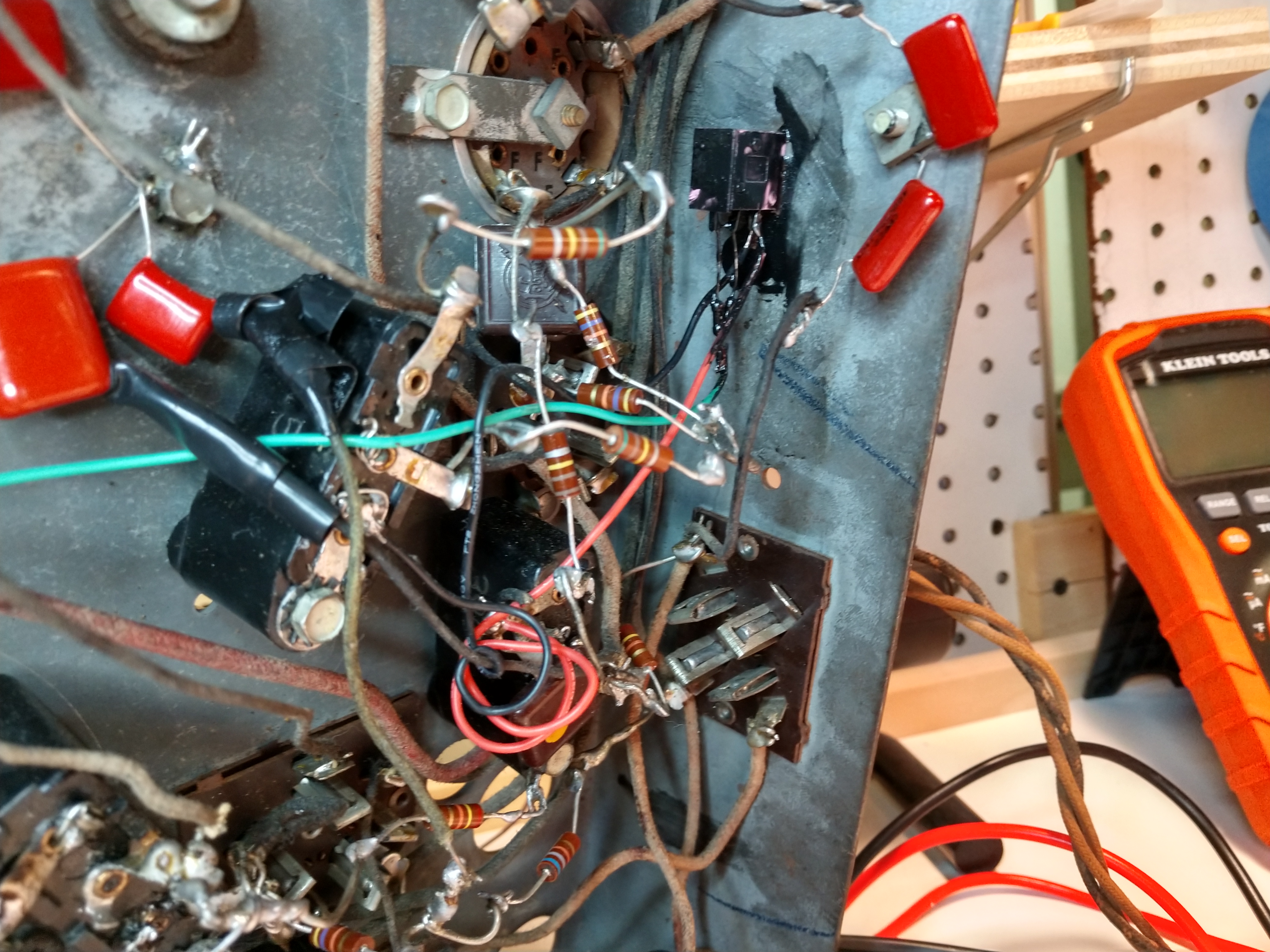

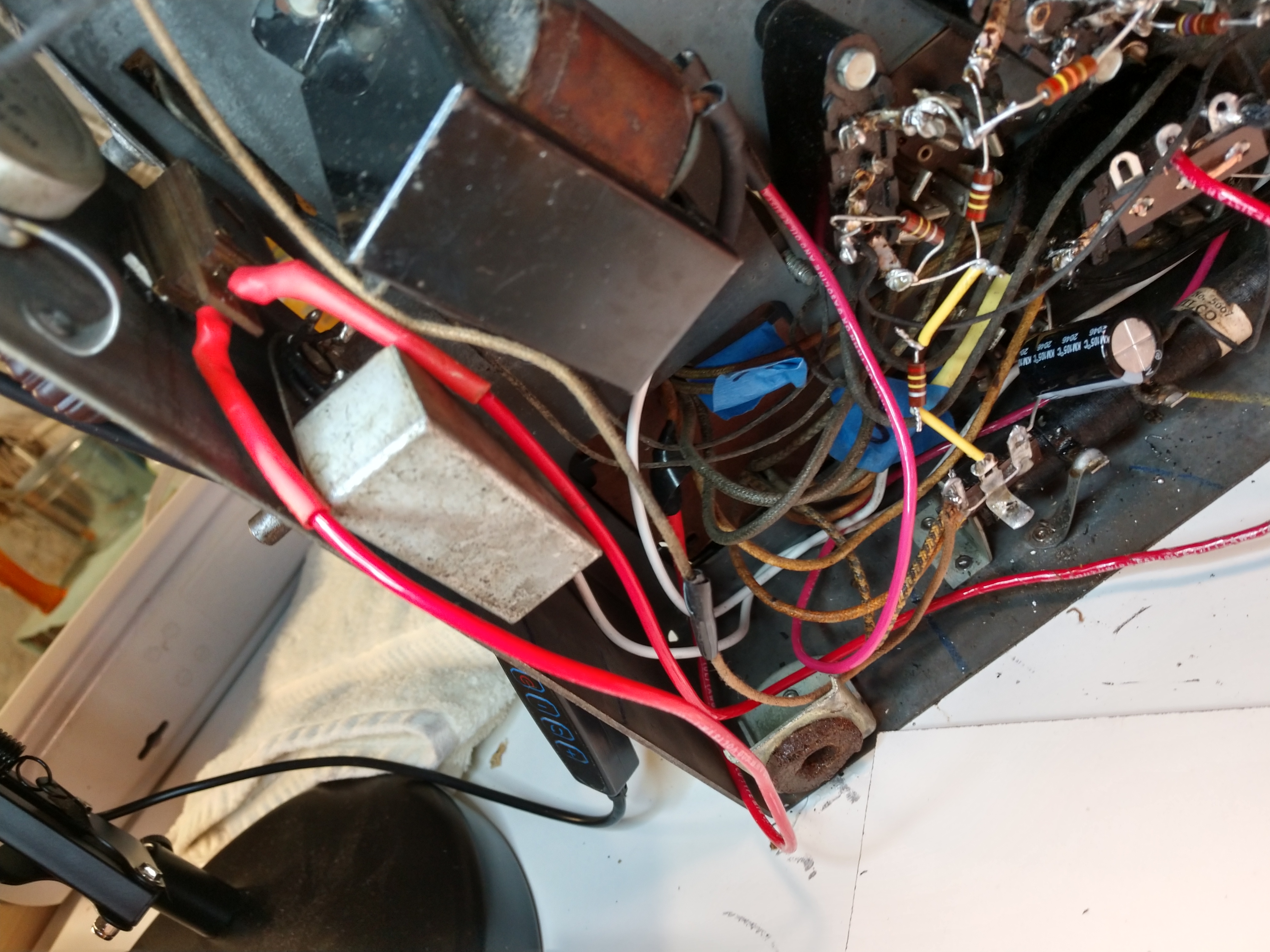

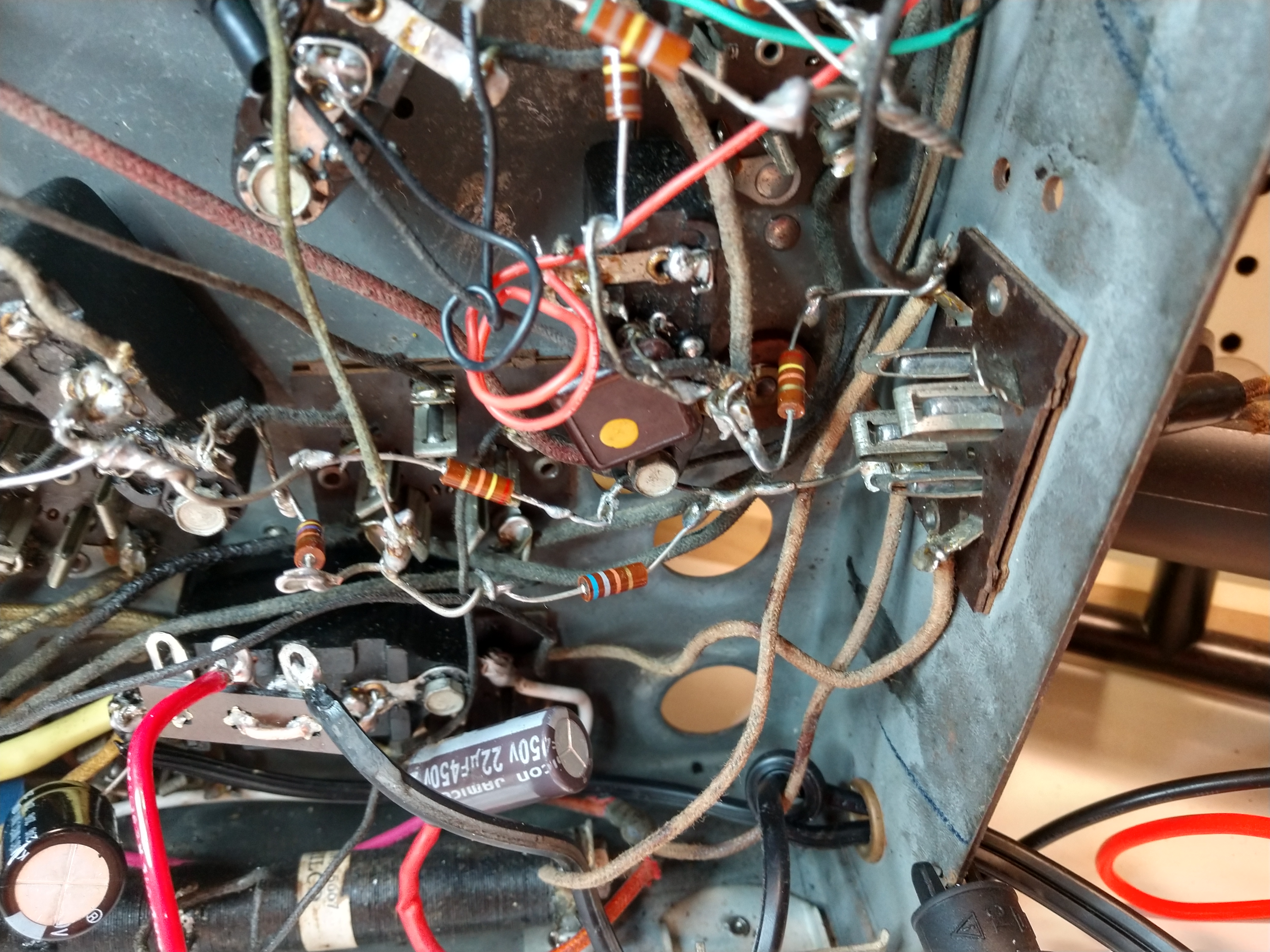

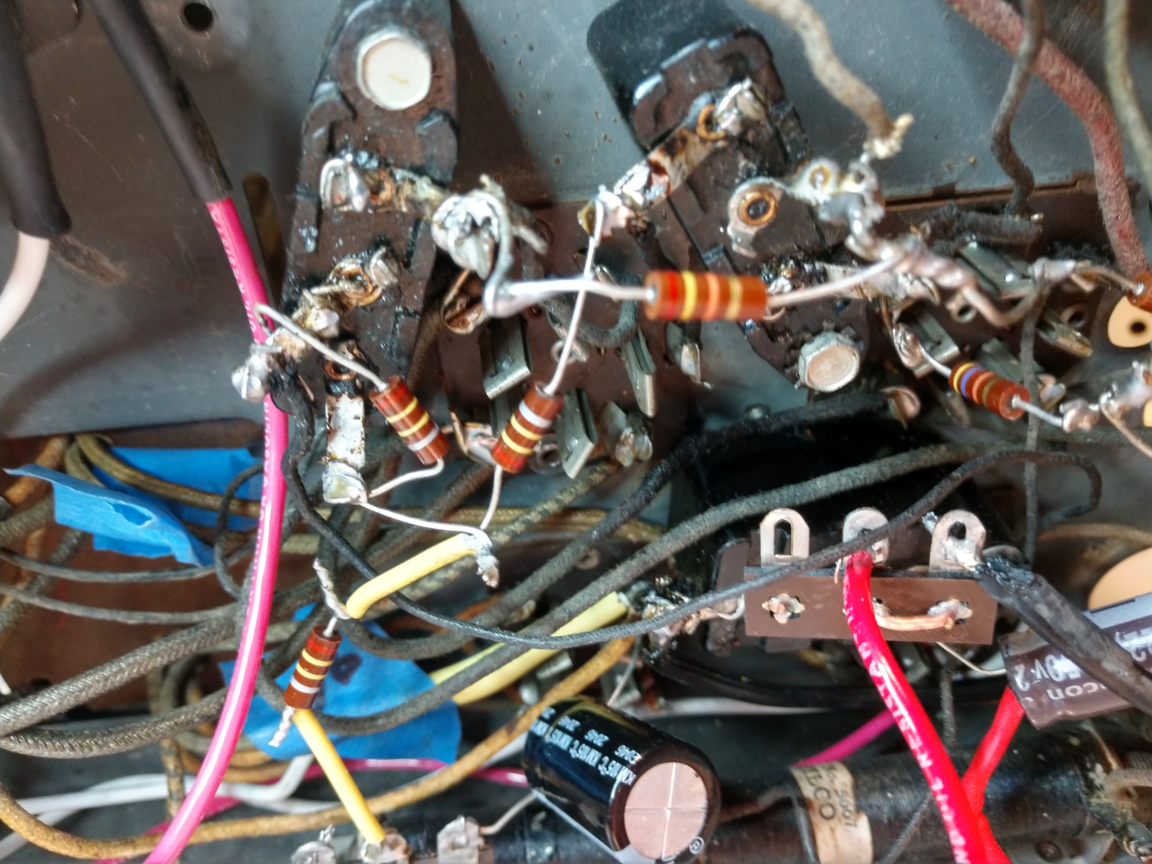

Here are a few more pics of the "work" I've done.  All are from the orientation of the short length of the chassis at the base of the picture.

For the H**l of it, I put a 10uf 450V electrolytic between the 80 tube and the first terminal post on the voltage resistor and in 20 seconds it vented.
The original caps were only 6 mFd. You really don't need much since there is both a dedicated filter choke and the speaker field coil.
Might you have connected the cap that just vented between one of the 80 plates and the resistor ?
Also check the resistance between that first terminal and the chassis.
Looks like you used all 1/2 watt resistors for replacements. Four of them should be 1 watt.

Develop a plan. And go by it. The photo of the chassis you put here looks horrible. I sincerely hope this is what you are trying to fix, and not what you think you have fixed.
Find out what parts to use, what not to use, check the wiring. Do not just turn it on: I've been fixing these for over 10 years AND I am an EE, AND I will never ever turn a radio on UNTIL I fully checked everything.
Hi Chris - To measure continuity you want to measure zero or low ohms from one point to another. In this case measure from Tab 1 of the resistor to terminal 4 of the power transformer. Same with terminal 12. If you don't get zero, then why not?
Thank you Bob and Morzh. Bob, I ordered the resistors according to the original parts list but I'll go back and double check. The electrolytic that vented is connected between that first tab on the resistor and, when you look at the 80 socket from the bottom with the radio in the position I've been referencing, it's connected to the upper right tube socket tab. Is that correct?

Was the rectifier tube removed at some point? If so, it could have been reinserted with the wrong orientation. Sometimes the socket holes become wallowed enough a tube can be inserted more than one way. By turning the tube one quarter turn, the tube filament will connect the B+ line to the HV winding of the transformer.

Tube 80 is inserted fine but continuity is not. Zero ohms on terminal 4, 200 ohms on terminal 1.
Something connected to terminal 4 is shorted. Trace the wiring connected to that terminal. Unplug the speaker and remeasure terminal 4.
