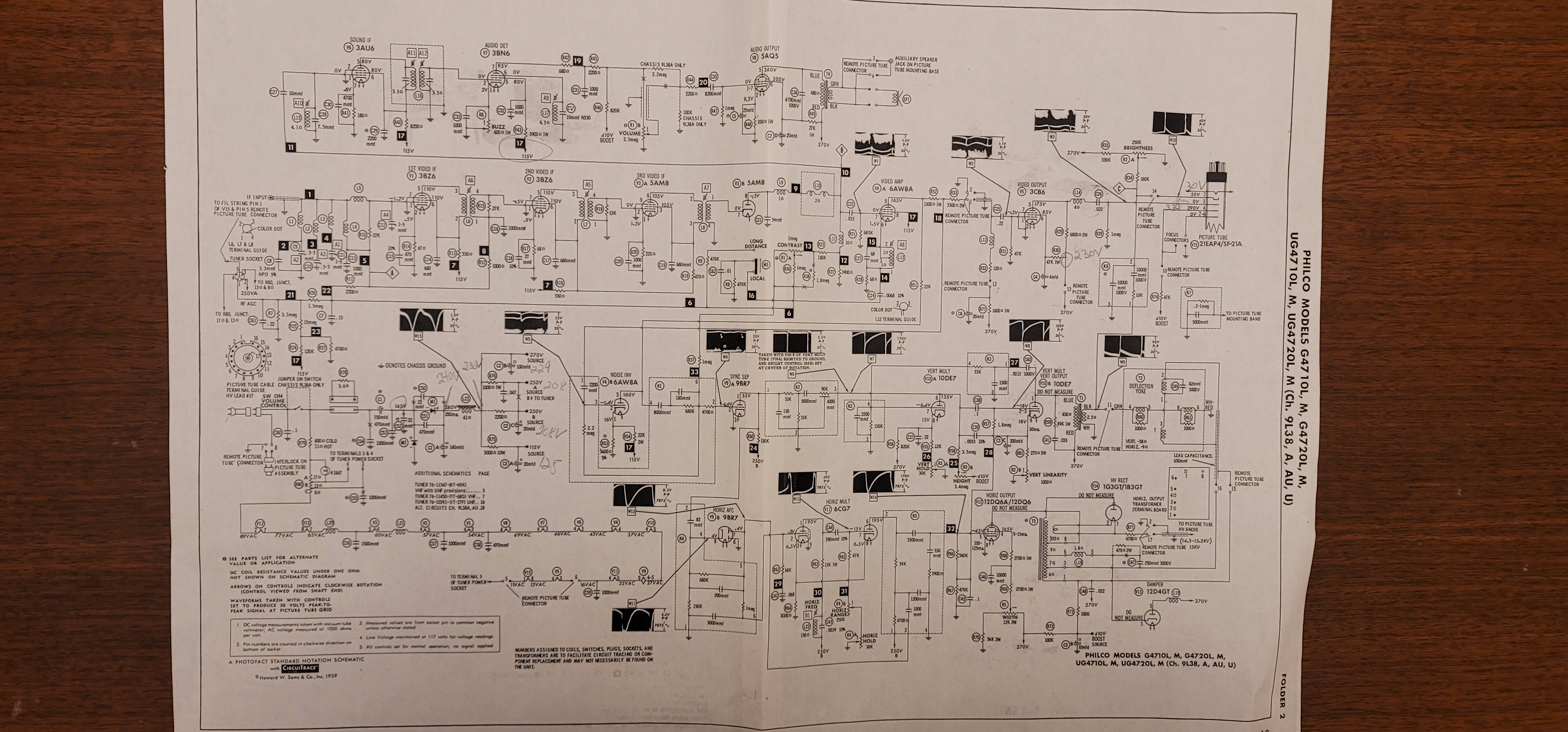

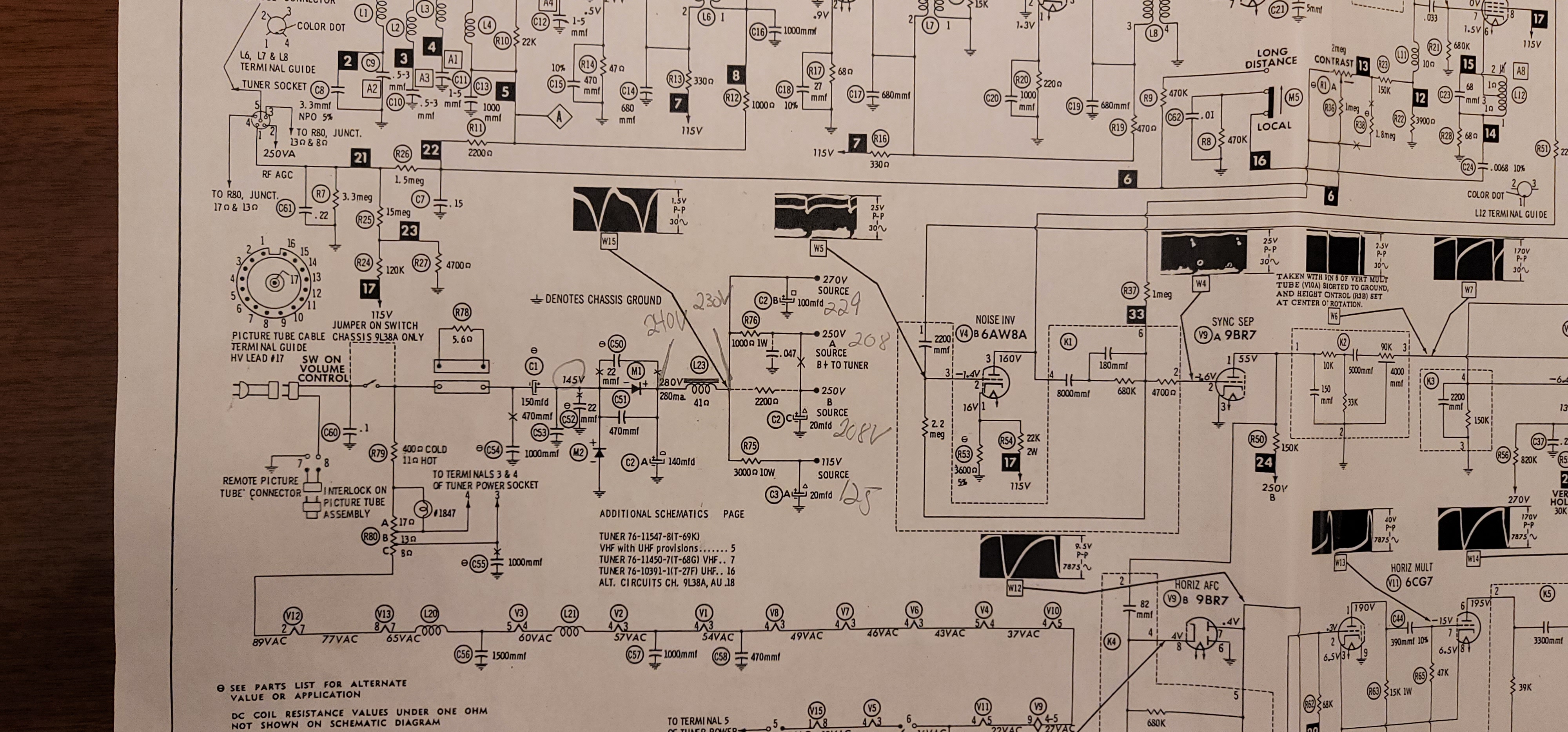

The bad news all my voltages are low. I followed the schematic from the switch to C1 the voltage is good leaving C1 145VDC exactly like the drawing. It looks like it goes through one diode and a micah cap then into the choke. The voltage should be 280VDC I have 240VDC. I checked the resistance on the choke it's dead on at 41ohms like the Sam's says. The voltage leaving the choke is 230VDC. At that point I checked the voltages at C2 100MFD it Should be 270 I have 229, 20MFd should be 250V I have 208V, C3 20MFD should be 115 I have 125. Also the 250VDC to the tuner is at 208VDC. Is it possible the (C50)  Micah cap is bad and it's bringing the voltage to the choke down?

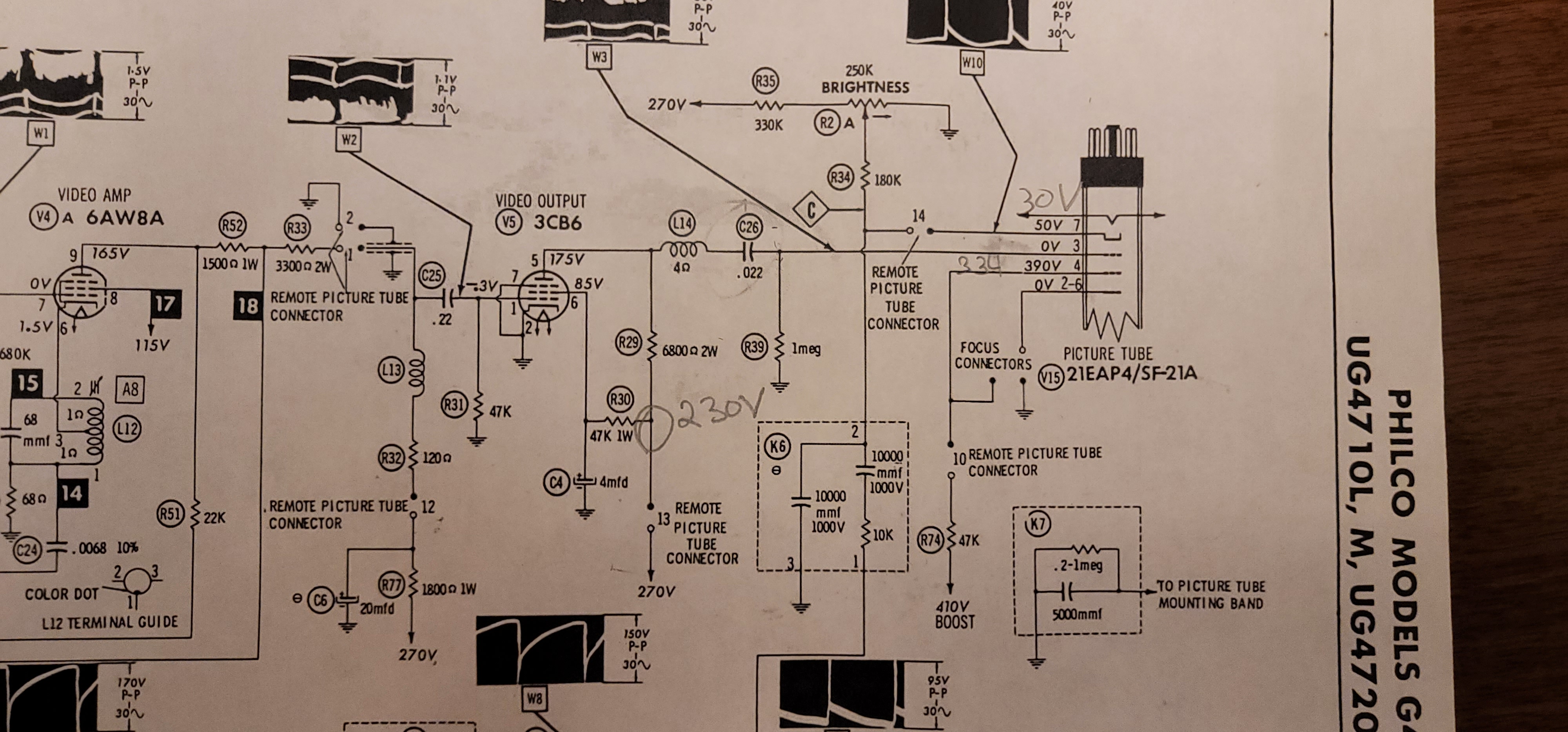

Also at the Picture tube Pin 7 should be 50VDC I have 30VDC, pin 4 should be 390VDC I have 334VDC. I also checked the junction of resistors 29 and 30 on the Amp board and got 230VDC instead of 270VDC I'm guessing its all caused by the low choke voltage?

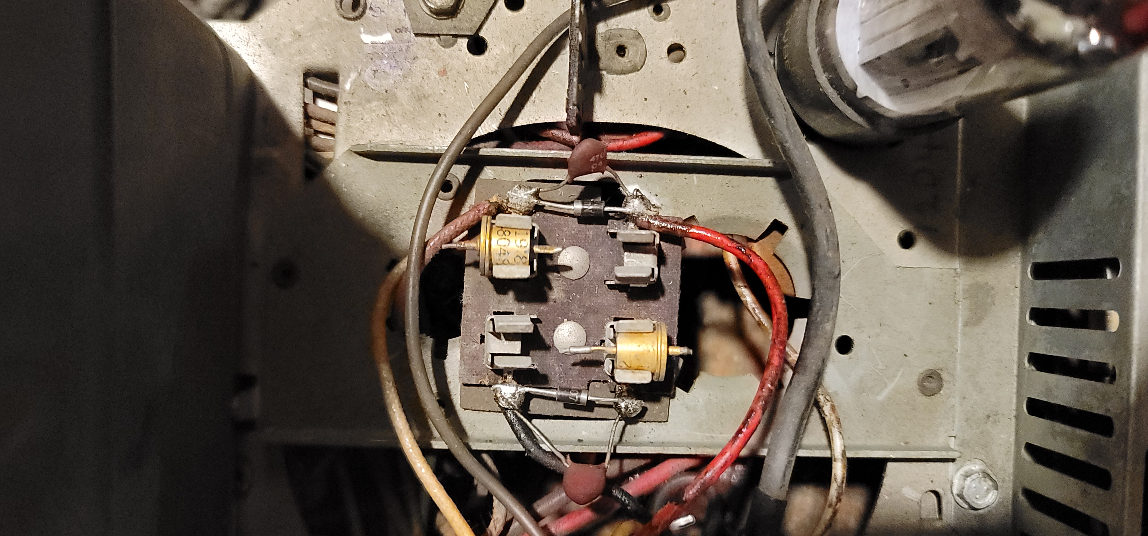

BSQ, what kind of diodes? Selenium or ? I know a lot of sets used selenium rectifiers in that era and they get bad. I don’t know if your set uses those or not. I can’t tell for sure in the pictures. Might check. That 270v feeds both your vertical and video outputs as well as the horizontal. Your 410v boost is low too. Note that this power supply is a voltage doubler circuit.
Tim
This model uses silicon power diodes for the voltage doubler. Did you replace them? I suggest 1N5408 diodes.
Those are ceramic caps, not mica across the diodes. They are there to suppress transients when the diodes switch on and off. Moden diodes are "tougher" than the early ones.

DC voltage on Pin 7 of the picture tube varies with the brightness control.
Side note: Keep in mind that there is no voltage regulation so your readings may vary from what Sams published. Something else to consider is the way Sams created their service info. They would just buy a TV and reverse engineer it. The original manufactures service info will have slightly different voltage values.
For example, Philco service info has +275 for B+ and +265 going to the tuner.
I  had my electronics store Cross over the old part number and they said 1N4007 exceeds the original diodes. So I have 1N4007's in there, I did notice that the picture was slightly better with the original diodes, but the voltage was the same.

TVMAN the original diodes were silicone, but I have modern 1N4007's in there now I left the old ones just laying in there disconnected. The originals had a Philco part # of 34-8048-1 with replacements made by Federal having the part number HF504, international brand is SD-500, and Sarkes Tarzian part# M500. Those are the numbers we used for cross referencing them at the store.
I attached a picture of the setup below. If those ceramic caps shorted could they be dragging my voltage down? I've been checking my choke voltage on that read wire that's leads to the choke.
No. If one of those ceramic caps were shorted, you would have AC on the electrolytics and they would blow. What line voltage are you running the set at ?
