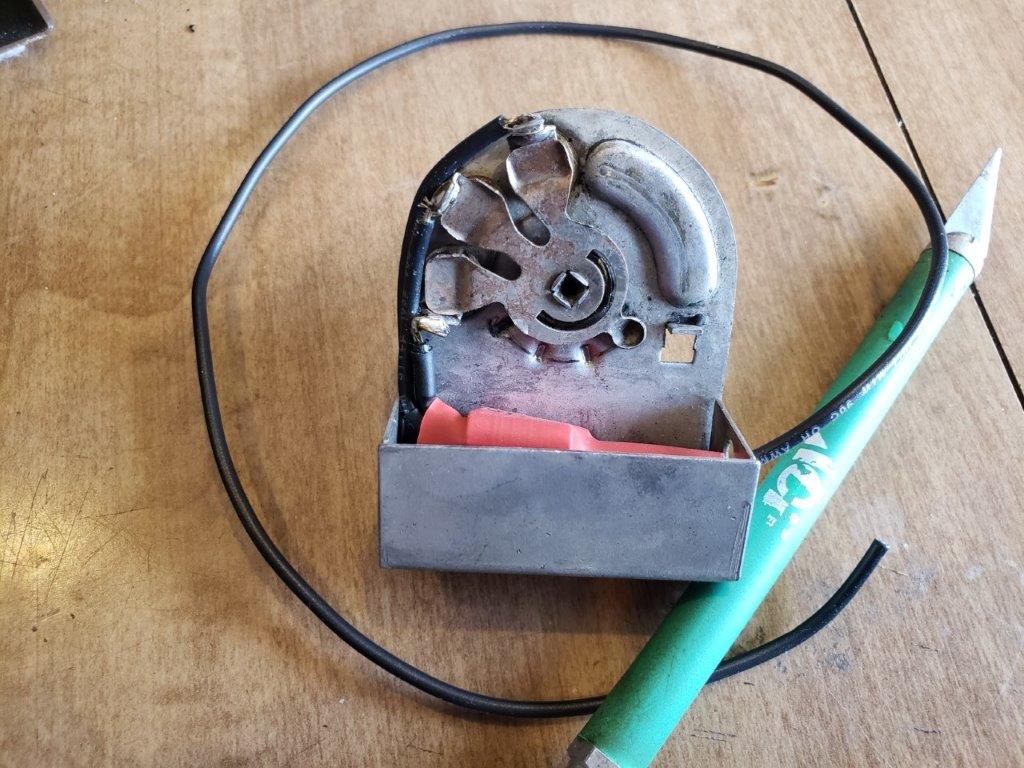

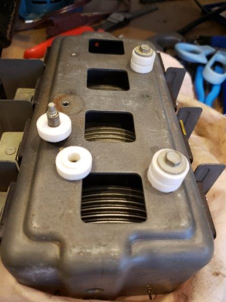

Rebuilt Tone Control

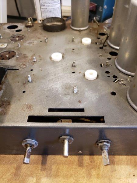

I removed the Tuning Capacitor, and installed 2 pc. Grommets that I 3-D printed at work. here are the glued-in upper halves.
Here are the grommet upper and lower halves before installation. Still using the little metal tube like original.

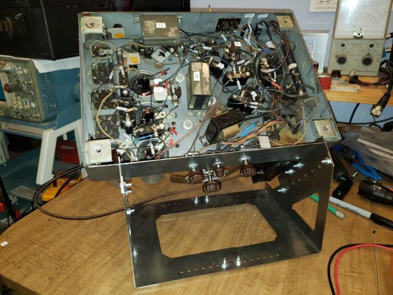

Long story short, all the bakelites are rebuilt, resisters replaced, electrolytics, bypass, and filter caps rebuilt. This picture is before the BC resistor flamed out and I installed the aforementioned 10w unit.

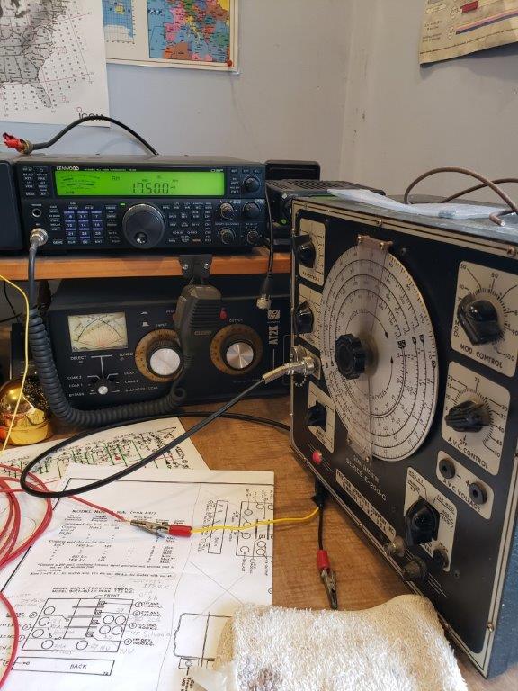

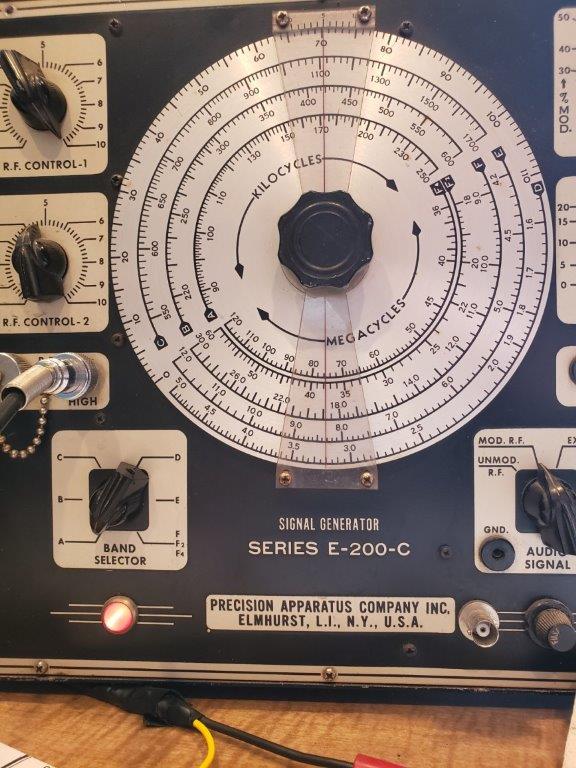

Comparing ye old signal generator with Kenwood 590s, we see 172.5 kc on Band A
I understand that 175 is the correct IF peak for this unit (Model 90 1-47)
Now, I know I'm doing something stupid, because I'm not getting signal thru the IF; the instructions say
"Remove grid clip from 1st det." (which I did), sig generator connected to said tube grid (thru a .1 cap), ground going to chassis; I just get weird noises....I did short stator and rotor of Var. Cap. RF section and have an AC voltmeter reading output of 2nd AF.
any suggestions?

There a a few things to try. First connect your signal generator output to the grid cap of the 24A IF amp tube and see if you can receive the signal. This will eliminate the possibility of a problem in the first IF transformer blocking signal from the 1st detector tube.
Try tuning your signal generator above and below 175 KC while listening for output. Perhaps the IF is way out of tune which is why you are not hearing anything at 175 KC.
Removing the cap wire from the 1st detector tube and feeding signal through a 0.1 uF cap sometimes may present a problem. With no DC path to the control grid, there is no bias on the tube and it may assume any random plus or minus voltage depending on grid emission or gas content. I usually leave the cap wire on and force signal to the grid across the input tuned circuit. If the tube is operating properly, you should get IF signal through easily enough.
This is assuming that the !st detector and IF amp tubes have the proper cathode, screen grid and plate voltages applied and have been confirmed correct.
Mike, WA2YGA

Thanks Mike, I did as you suggest, leave the grid cap on and also tuned sig. generator up and down. I may not have went far enough the first time, because I found the signal way up at 216 ! Strong signal too, definitely not a birdie!
I thought maybe not having the 3-tube shielding might affect, so I faked it with tin foil. No difference.
Dial isn't off by much, but is off.
Perhaps I caused the IF Peak to move by removing and cleaning the Var. Cap.
I will attempt to move it back to where it belongs 175 kc.

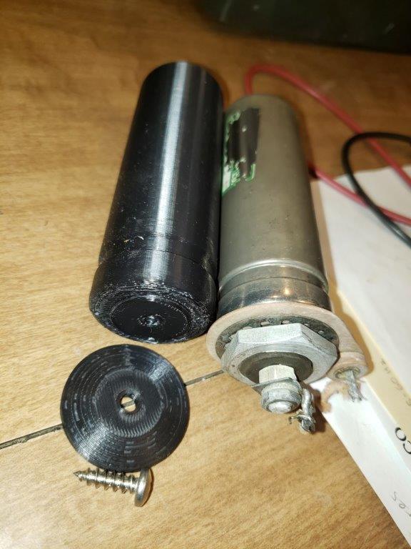

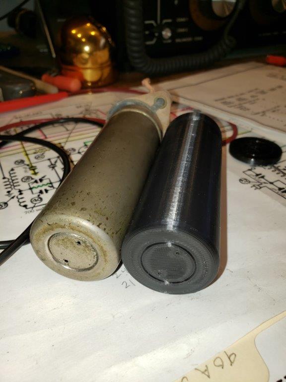

On another subject- I suspect this old (nickel?) plated electrolytic was original since it wasn't even hooked up. And, since no one here has one I printed one.
Right now, color is black, but I intend to find some paint and make it look a little bit more like the real one. Just for show, since I have the workers under the chassis.
-Simon (I'll try anything once!)

very nice! What material did you use and what will you paint it with? Curious because I just did my first foray into 3-D printing to make a bezel.

Bob, it's just "PLA" plastic filament, the most common for 3D printers. We recently bought an Ender 5 Plus here at work, and I took advantage! paint- not sure what I'm gonna do there. probably pretty tough to duplicate so I might just do a gray or something....
Yes it would be cool to print bezels and knobs and stuff like that- probably never look exactly like the originals but sure enough better than nothing.
Simon
Wow, I am impressed with the 3-D printing!
You might consider painting it copper, like a Mershon condenser. Then print another, paint it copper also, and you'll have a matching pair. It's easier to come up with copper paint that actually looks like copper than it is to find something that looks like polished nickel.
