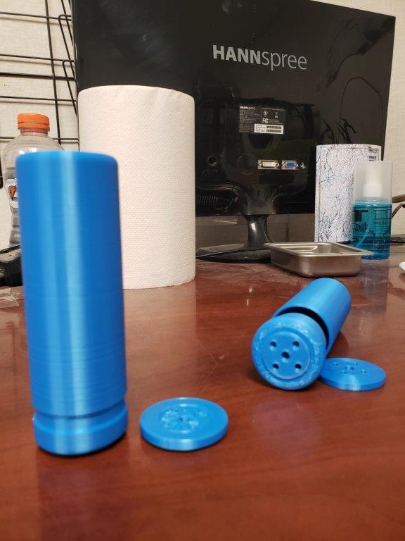

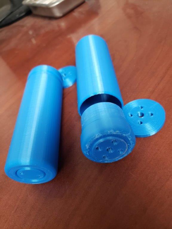

I took you up on your suggestion, in fact I made it telescope together and added holes thru the bottom so wires can pass....
now we have 'stuffables'
I see that you can buy silver or metal colored filament.  I think we shall try that next, and maybe not have to paint.
hmmm....wonder if resistors are to small to print....

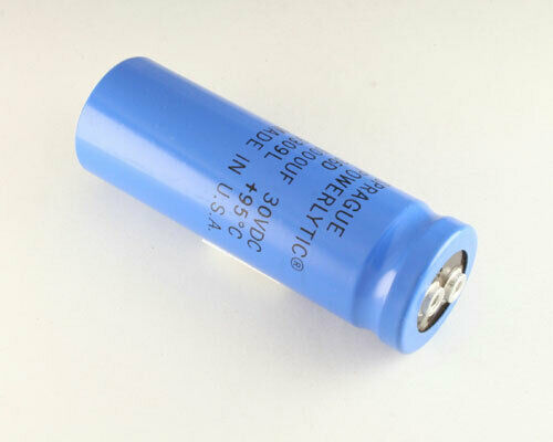

Those 3D printed replacements look great. With the blue color they look exactly like modern Sprague 36D electrolytics!
Interested to see what they would look like made from metallic filament. Also nice to see the latest design is easily restuffable and really applicable to almost any radio.

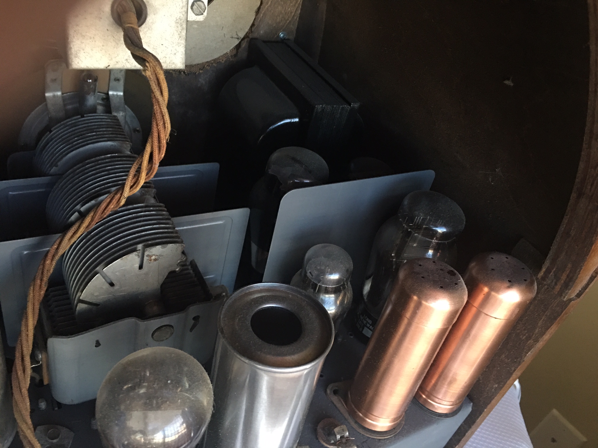

Thank you for the Tube Shield, hope you are enjoying your chassis fixture.  I made a video with some observations on the shield(s), as you will see if this link works.
I wonder if I have an uncommon variant of Model 90?

Yes, I've used the chassis fixture on several projects now with great success. You shield observations are very odd. I've seen a number of model 70 and 90 shields and they all have that screw hole. No clue about that second shield clip.
Something else odd I've noticed in both my 90 chassis and yours is the proximity of the 80 tube to the transformer. They almost touch when using an ST type and definitely touch if a globe is used. Didn't these come with globe tubes when new?
#36
Yes, I'm sure they were all globe- that is what is pictured on the tube shield label, and I only have one remaining. The RF amp...
Maybe someone will recognize this particular shielding configuration

That is a fantastic stuffable replacement can, Simon! Rustoleum makes metallic gloss copper and aluminum paint that would possibly work for visual correctness instead of different filament. I don't know how much filament costs, but the paint is about five bucks. Just don't try to second coat with clear coat after painting with the metallic - it totally wipes out the gloss metal look. Don't ask how I know! Take care and BE HEALTHY! Gary
#38
I'm gonna try that, Gary next time I get to the Lowes store I'll pick some up....

Simon, some Philco 90s used a flat plate shield, about four inches square between the 47 and 80 tubes.
M R Radios   C M Tubes
#42
Ah! that's what I need- I can easily have on lasered out. And, I see that 90 only has a 3-gang variable cap (mine has 4). Plus I have to admire your electrolytics, which are quite different also

Yes, this is a late version 90 with two 47s and a three gang tuning cap. The 90s that didn't the flat plate shield, used a round shield on the 27 tube on the left rear of the four tube group. The early Philcos came with either Mershon or Sprague filter caps, these are the Mershon. These have been re-stuffed with film capacitors.
#44
The early 90 with two 45 tubes had no metal plate between the four tubes closest to the electrolytics.
Early production of the "middle" 90 with one 47 tube used a round shield over one of the 27 tubes in that four tube section.
Later production 90 sets with one 47 tube, as well as all late 90 sets with two 47 tubes, had the metal plate.
