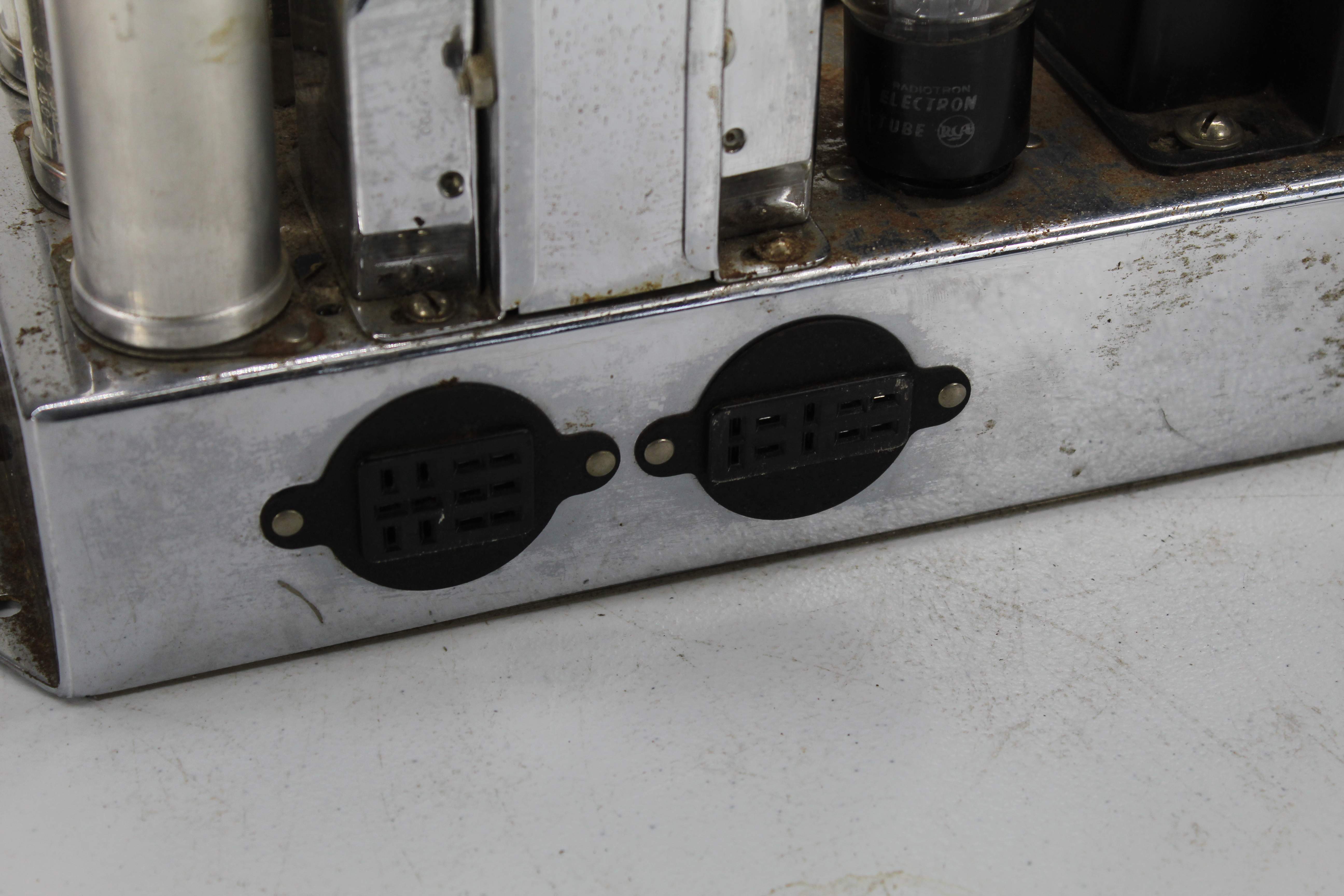

I picked up a E.H. Scott 800B Radio and it came with this amp. After doing some research I discovered this amp is not for the E.H. Scott 800B Radio. It appears to be off a E.H. Scott Philharmonic. I attached some photos below, I kindly ask for anyone's input and information as I am not very knowledgeable in this subject.
Not an amp but a power supply, a robust one indeed...
May have had a problem in the past, the black painted transformer does not appear to be OEM, if it is correct is another guess...

I think Chas may be right, I see a screw in style fuse holder under the power transformer, I'm not sure what Scott used, if any, but that looks like one from the 1950s or 60s.
Thank you everyone for the input, I really appreciate it. Someone on another forum helped me identify it. It is a power supply for a Scott Laureate from 1941.
