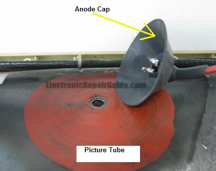

No pic but have sound. Do you have high voltage? Ground a good, insulated screwdriver at the blade to the chassis with a long wire and carefully hold it near but not on the CRT Anode connection. Work with one hand; keep the other hand in your pocket. You should be able to draw an arc about 1/4 to 1/2 inch or more. If no HV, don't go rushing to buy a CRT. Look at the horizontal output tube (the fat one above the HV cage). If the plate is glowing red, SHUT DOWN fast. The Horizontal Output tube depends on a signal from the Horizontal Oscillator. If the coupling cap is shorted, The Horizontal Output tube will draw too much current and burn out, possibly taking the flyback along with it.

I will definitely try that tonight. So just having the wire near the anode connection will draw an arc even with the rubber boot on it?? Thanks for the tip! As always its appreciated

Yes, it will, think of testing the spark on a lawn mower or car. Do remember to GROUND the screwdriver shaft to the Chassis! and use a screwdriver with a rubber handle and that the shaft does not extend out the back of the screwdriver. Don't directly touch the anode clip, but if the circuit is good, you should get a nice blue spark at between 1/4" and 1/2". If no spark, shut down and perform the same test at the plate cap of the HV Rectifier in the cage. Again, BE CAREFUL! Use the 1 hand in the pocket technique and ensure that the screwdriver is well grounded to the chassis.

Appreciate the follow up TV MAN. Yes I figured with the wire breaking off that the tube is toast and have posted on numerous sites and classifieds to hopefully find a NOS piece. I checked for high voltage last night as suggested by Mr FiXIT and yes I have a strong arc when brought near the anode connection. I guess patience needs to take over and hopefully as I continue to look ill find a replacement CRT. You all have been such a big help in working my way through this and cant thank you enough.

That's a very good sign, means your horizontal is working, good flyback, probably good yoke. Do you hear the vertical running? It'll produce a 60 cycle buzz in the yoke and output transformer. It could be off frequency so it might be faster or slower. You can turn the vertical hold control and listen for it to change speed. It it possible to get a close up of the connector on the tube itself showing the damage and possibly the broken wire? Is it lit up (yellowish orange) in the neck when on?
