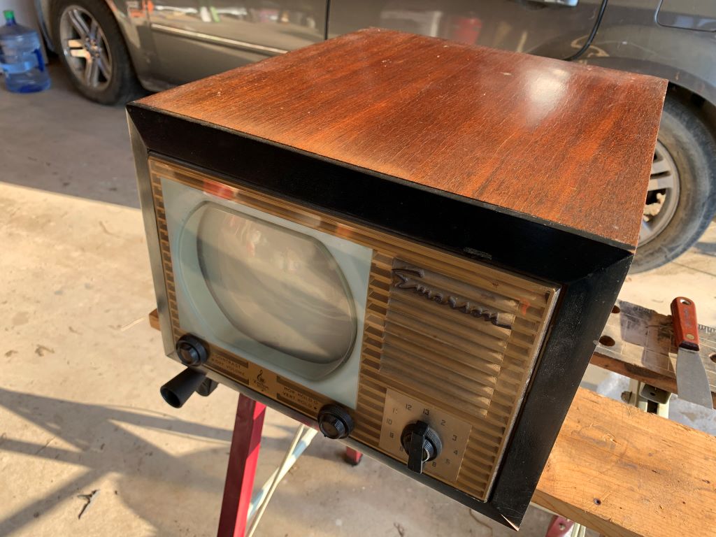

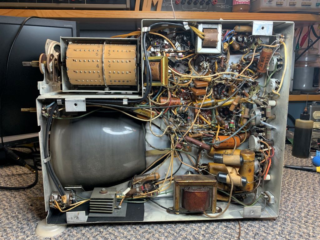

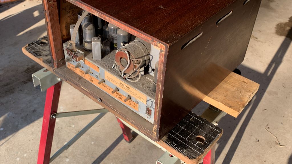

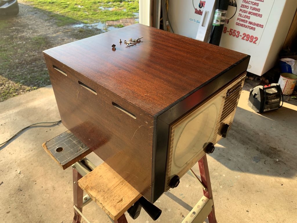

Here it is, a 1950 Emerson 7" TV model 639 resurrection/restoration attempt. It was an eBay find, not cheap but I thought very unique. I hope I can get this finished before I "retire" Icon_lol

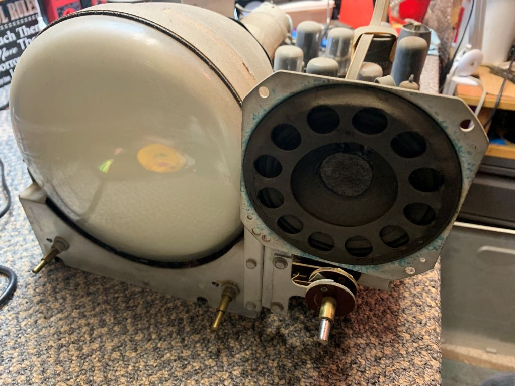

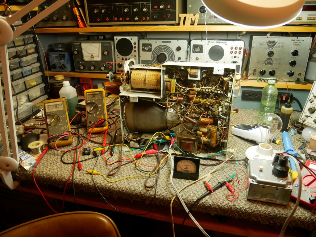

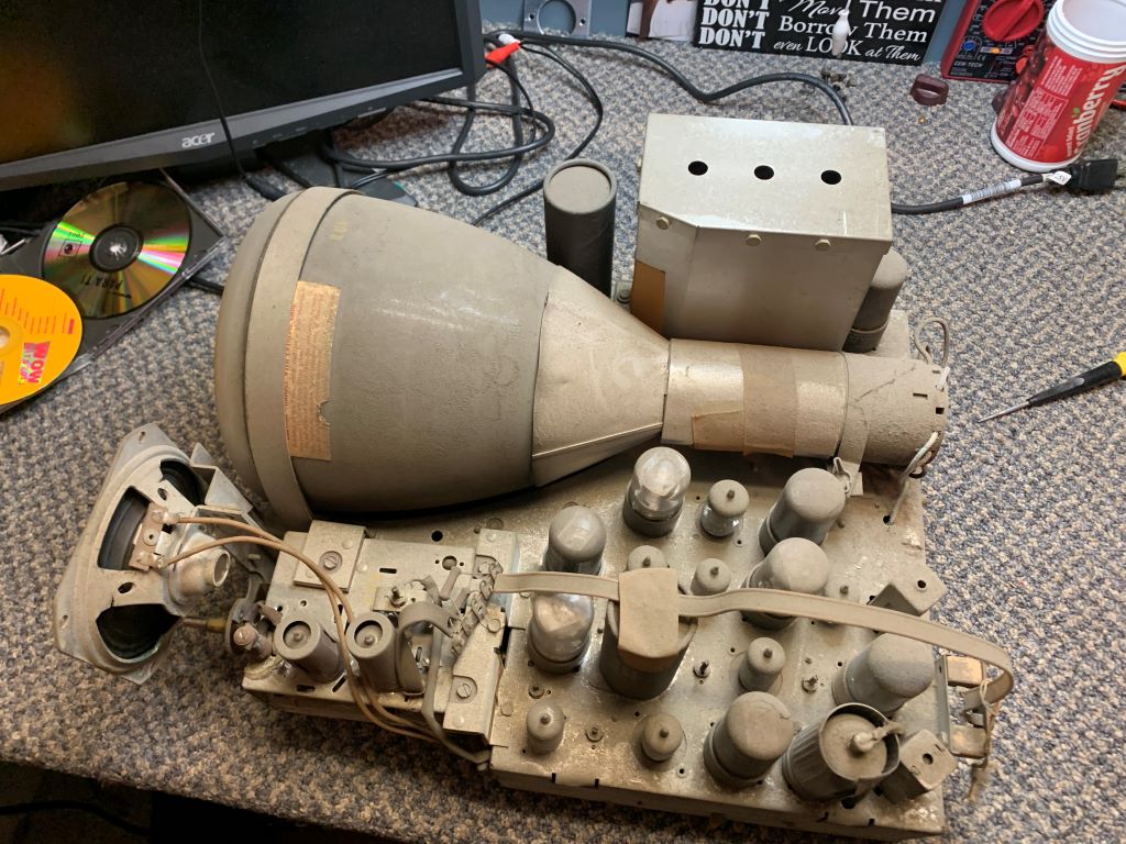

It looks to be in very good condition visually and has almost all original tubes. It is series strung using mostly a mix of octals and 7 pin tubes. It uses a 7JP4 picture tube which is electrostatic deflection. It looks largley unmolested, and seeing almost all original tubes, may be a low hour set. It could also have failed the picture tube or something that put it out of service. I need to test the big tube and hope it isn't shorted or has an open cathode or heater. It's full of leaky paper caps and some bumble bees but isn't a recappers dream. It kinds resembles a large radio with a picture tube. I kinda liked it because it is a little different than what I have seen around. So far I have found an open fuse/resistor off the selenium rectifier. I bypassed and am beginning a slow power up using a dim bulb to see of the caps will reform or anything shorts. Here a few pics of the project so far:

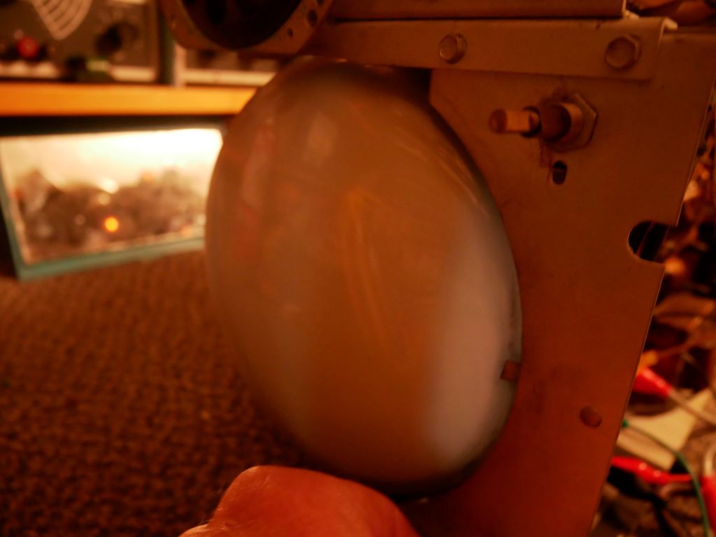

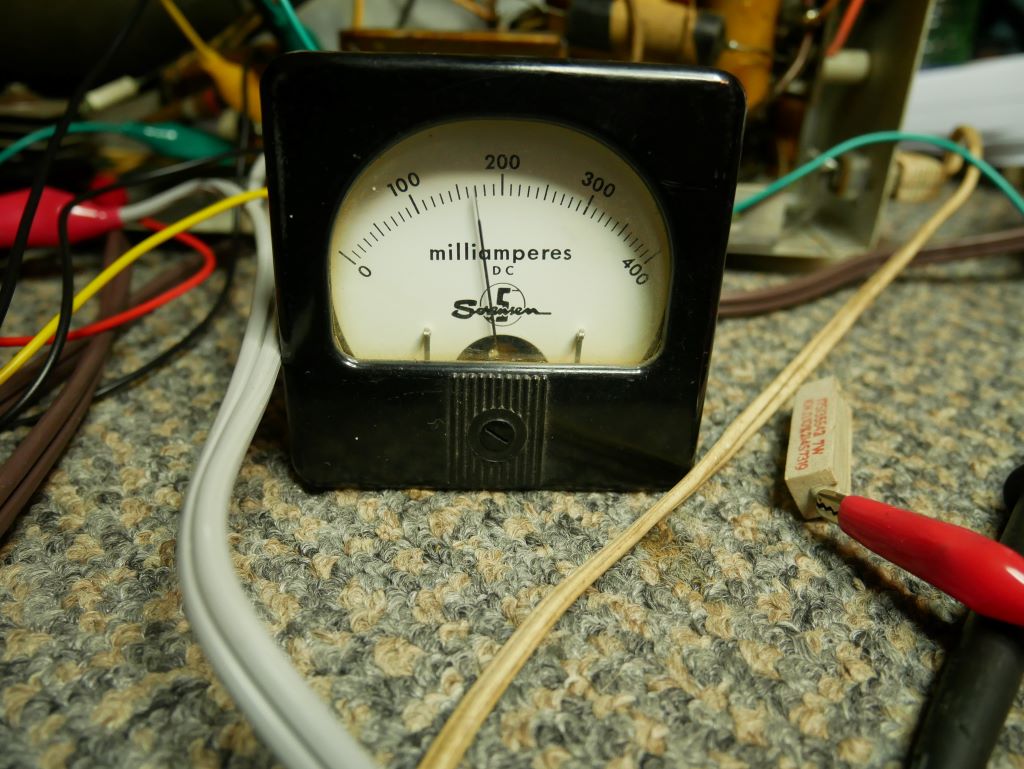

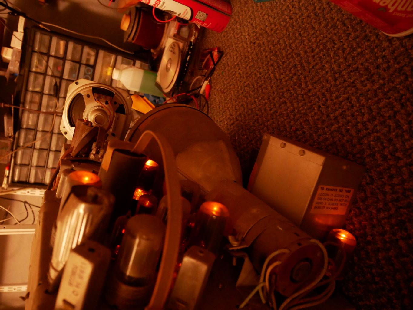

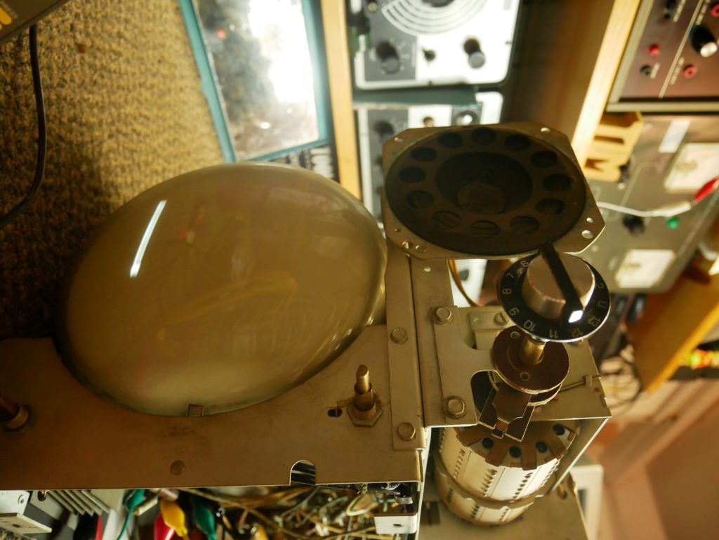

I had a rare opportunity to stay inside this evening so I headed to the radio room and decided to see if there was any life in this 1949 Emerson TV. I connected the tube filaments to full 120v and the B+ through a diode off my variac. I brought it up slowly and I could get a little light on the screen (1st pic). On the 2nd attempt I could only get a vertical line. I was quite surprised I had a full 5000 volts on the high voltage, some sync but in the 2nd picture I can clearly see the horizontal died. I'm sure the output caps are leaky or shorted. I do have sound (I can buzz it from the detector cap) but no static or signs of it passing a signal from the tuner. I had to add a couple filter caps to get my power up enough, the originals are dead) but I think this is stunning for a 74 year old TV do do this with very little help! I'll get some parts ordered and see if I can bring this old set back to full life!
