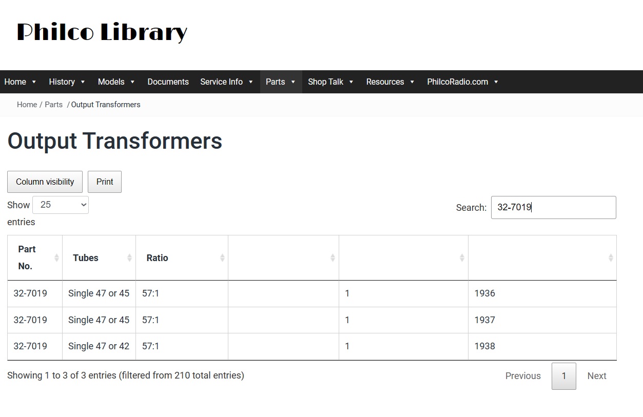

One thing confuses me.  In the Philco library for the 32-7019 output transformer (57:1) it list tube single 47 or 45 under heading "tube".  That's different than the 6F6.

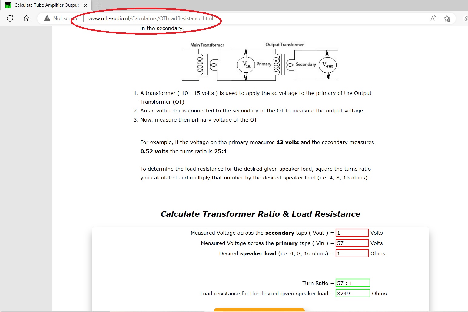

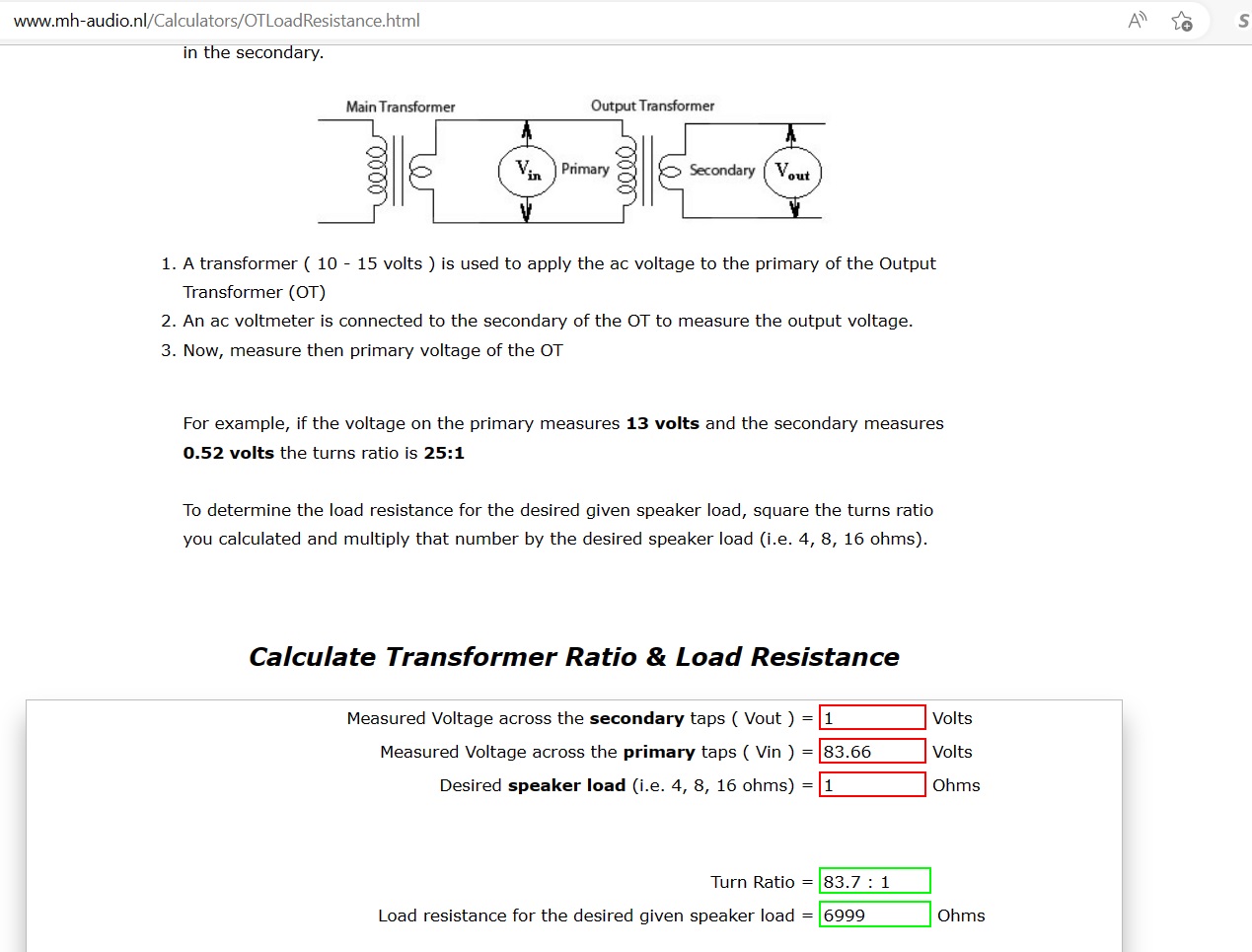

Chas -  another question is about the article & calculations. The 6F6 tube date sheets indicates 7,000 ohms.   Data for the 37-60 radio says an S-7 speaker with 1 ohm voice coil.
57:1 ratio for output transformer would equal 57 squared or 3,249:1 impedance ratio.  A 1ohm speaker would present a load of 3,249. That doesn't match 6F6 tube's 7,000 ohms.
Looks like the voice coil should be 2 ohms, or the transformer would be 83.6: 1 turns.  (Square root of 7,000).

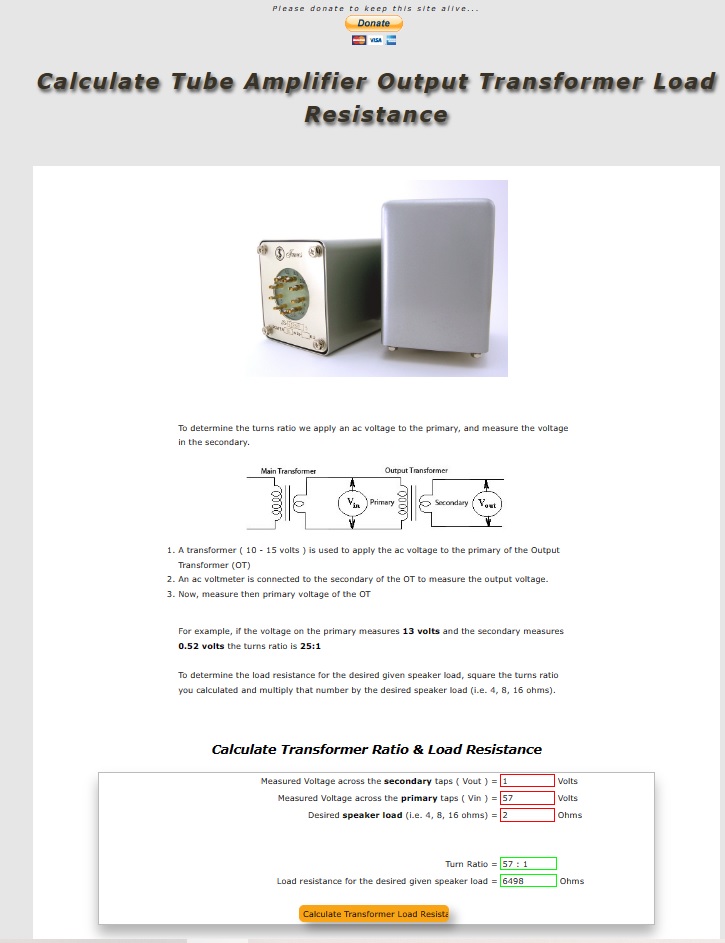

And last thing, I'll probably be out today.  Found this neat site later that verified my math.
So what is going wrong?  S-7 is not 1 ohm as listed?   Variable impedance according to frequency?  32-7019 not 57:1 ratio?

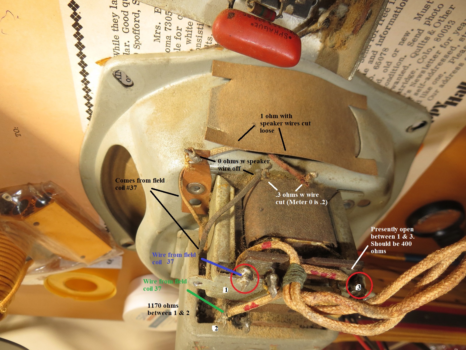

Little more time and the wife hauls me off to shopping.  I tested the speaker voice coil and other connections with the speaker coil wire cut loose. Figured I'd be replacing the transformer anyway. Voice coil is 1 ohm.

Thanks.  Sometimes I forget about the impedance vs resistance thing.  I did measure 1 ohm resistance at the voice coil itself with my meter.  The output transformer chart was from the Philco library.  In my radio is a 6F6G.  Would assume would be shooting for 7,000 impedance.
Just trying to find what ratio a new transformer would be.

Chas - Wasn't planning to run the speaker that way. I knew I'd have to at least replace the transformer, so I cut the voice coil wire at the terminal, then measured resistance with my meter. Got 1.1 ohms.
If I were to find an output transformer (single not push/pull type), it would have to be 7K impedance primary, 4 or 8 ohm (impedance) secondary rated 3-5W and hooked up to a NEW 4 or 8 ohm speaker (8 inches diameter mounting holes)??

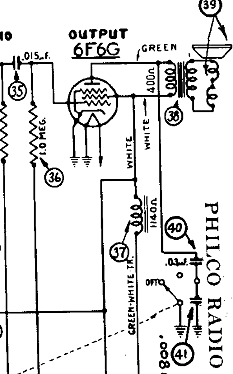

3.  I see the 1140 ohm field coil (hum buck, etc) in series with the output T (open 400ohm terminal 1 & 2).  How would I take this into account when choosing/connecting a NEW replacement output transformer? Piggyback the new one on top of the 32-7019 and series connect the 1140 ohm section?  Icon_crazy  Icon_e_wink   I don't have a deep understanding of the theory.   I need some answer like "choose this XX value of output transformer instead, and connect wires 1,2 & 3 like this ____.  Or buy 2 different parts, one XX impedance to replace part 37, and one output transformer of XX value.
4. The output tube is 6F6G, it won't change. Capacitor 40 is .03 (will it need to change if I use a different transformer & speaker?)

I have posted this snip of the output area, I want to post more from the power supply for reference but I don't want solutions to get carried away...
Look to the top/right corner, see the cone icon, immediately below represents the voice coil, below that is the hum bucking coil... It is that common junction that must be restored to "help" reduce the likelihood of having to swap "voice connections" to reduce hum. In other words this is a proper connection leave it alone. The hum buck coil is mounted on the same pole piece next to the field coil. Therefore, for this speaker, the "voice-coil" impedance is the sum of both coils for determining OPT output impedance
