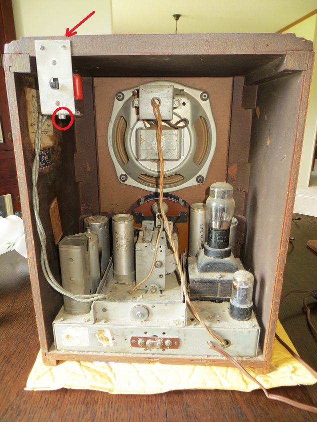

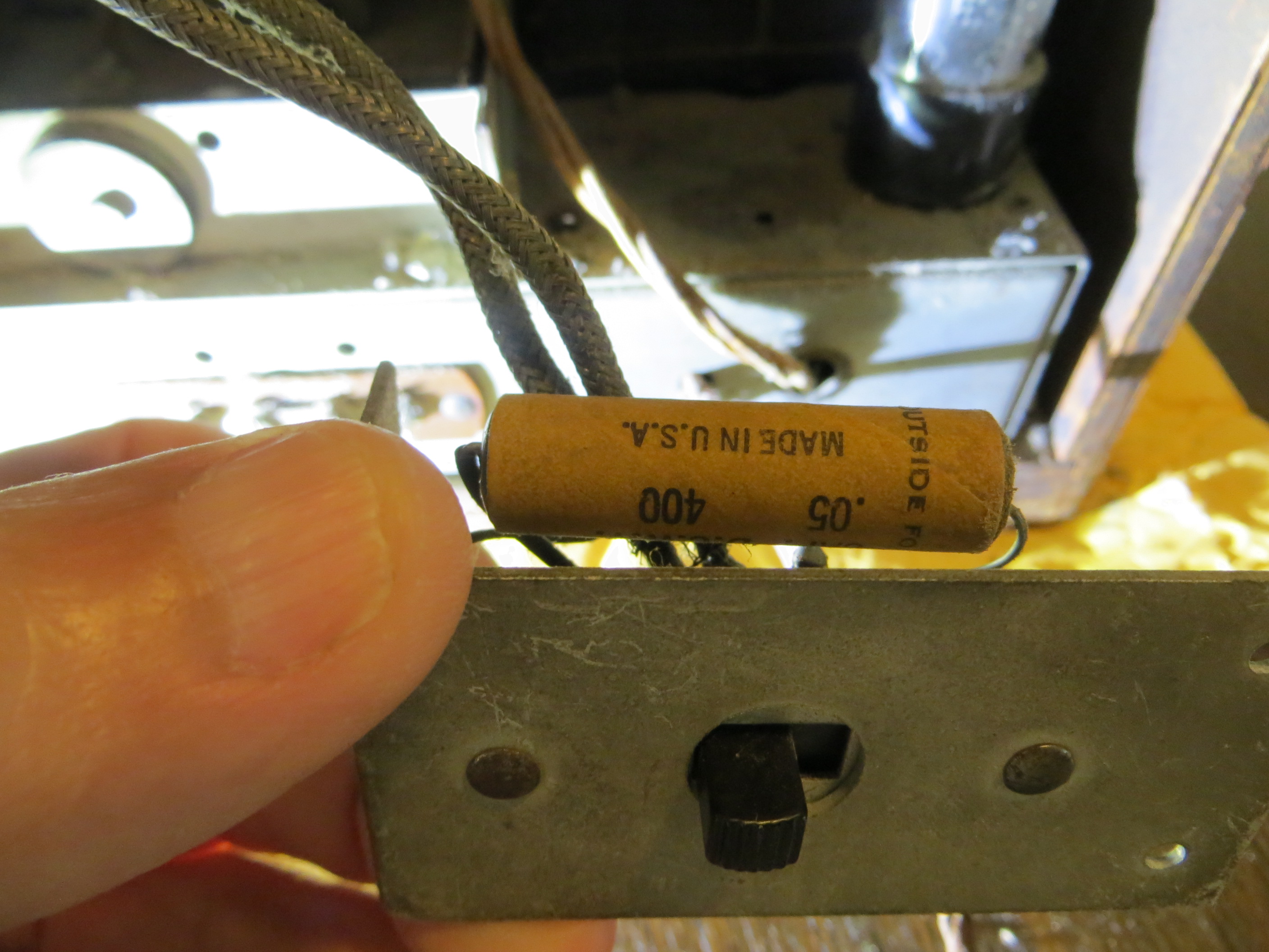

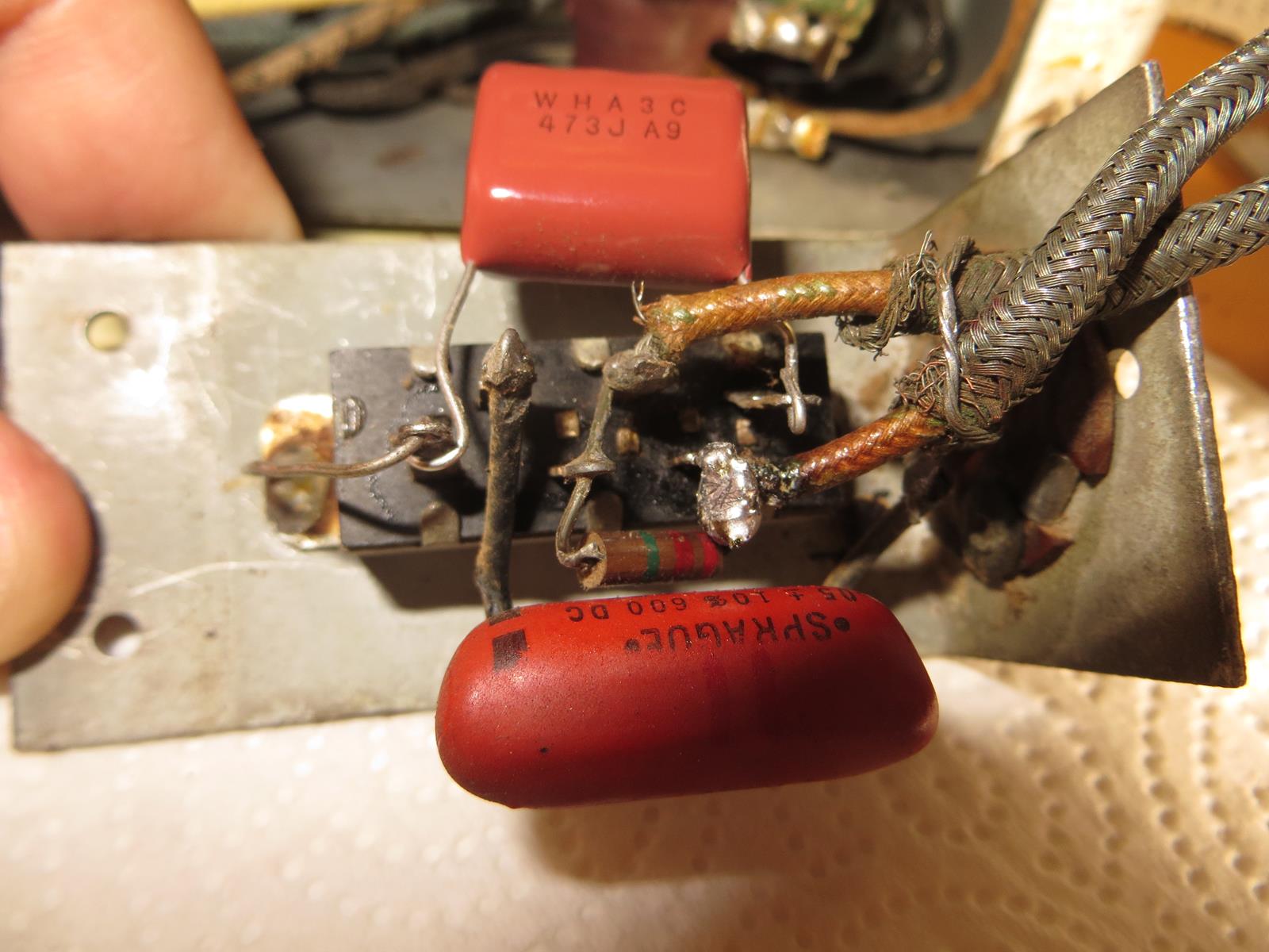

Somebody added a phono jack on my Philco 37-60B. Doesn't show up on the schematic. Afraid to try it out.

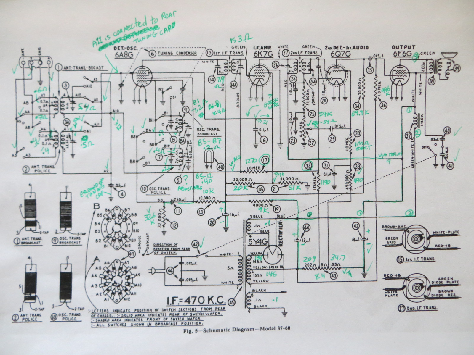

Here where I stand with my 37-60 Philco.
I have a long 15ft wire on antenna terminal 1. Strung near the ceiling of my room. 2&3 are jumpered. 3 is grounded by a single 12 AWG wire to socket ground, same socket 2 prong plug is in.
Speaker is sitting separate about 3 ft from the radio.  Doesn't have the tin shield box on it. Would not fit the new output transformer.
Have a shield on 6Q7Gtube. Shield wouldn't fit on the 6K7G tube. Tube too wide at top.
Replaced all electrolytic caps and paper caps. Replaced most resistors per previous posts.

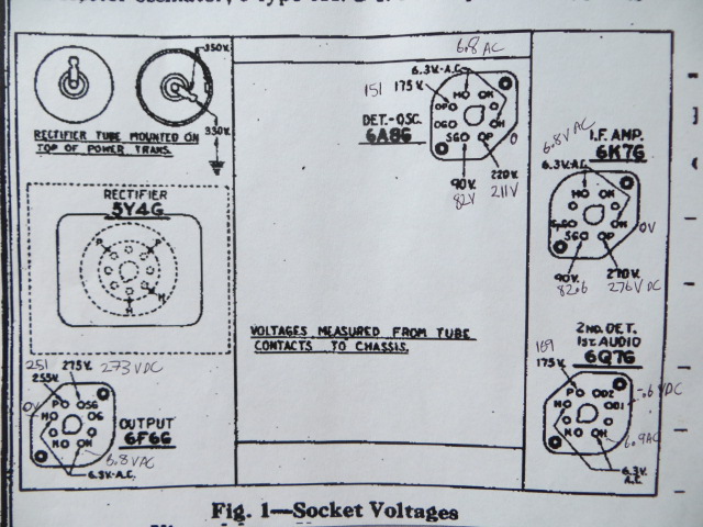

Voltages seem okay except 6A8G, it's a little low.
Presently shortwave is better than AM, but I can only pick up strong shortwave at night with clear voices/music. SW during the day is weak.  AM is nonexistent during night and day. Can barely hear a few positions where AM stations are. A lot of background noise, white static.    I have checked the resistances of coils as shown on schematic a 2nd time. Did this before.  I have not checked any mica caps
Have not done any alignment yet, don't have a sig gen or oscilloscope, just a DMM.
Here's what I measured.

Is there a switch with the phono connection? Is it an "RCA Jack?"
If you can, post a pic of the jack and the underside of the chassis. Although Philco did not put phono or "phono - television" jacks on this radio, it was not uncommon to have a Radio Shop install one back in the day, either from a kit (RCA sold a neat one) or individual parts. Some had a switch, some relied on the user to tune the radio to a dead section of the band.
+1 on Morzh's comments. The phono input is usually isolated from any voltage by a capacitor of approximately 0.1uF. Sometimes, this is added, but most of the time, the mod uses the cap between the center (wiper terminal) for the volume control and the grid of the first audio tube (a 6Q7 in your case).
In troubleshooting radios, if it has a phono jack, I will use it to inject an audio signal from the computer, a CD or MP3 Player, etc. If the phono connection is the RCA type yu can get a 3.5mm TRS to twin RCA adapter cable) It would have 2 RCA plugs because the MP3 / computer / CD Player is stereo. For teting purposes, you can use just 1 of the 2 RCA plugs. You will be missing a channel but it willbe good for testing.
'If you can't get good, clear, loud audio from using the phone jack to inject a signal, then you have a problem with the 1st Audio or "Power Amp" circuits. Alignment will not solve this. The Audio circuit is relatively simple.

Yep, has an RCA connector and a switch. I'll try it out with my modern turntable.
