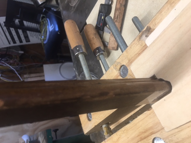

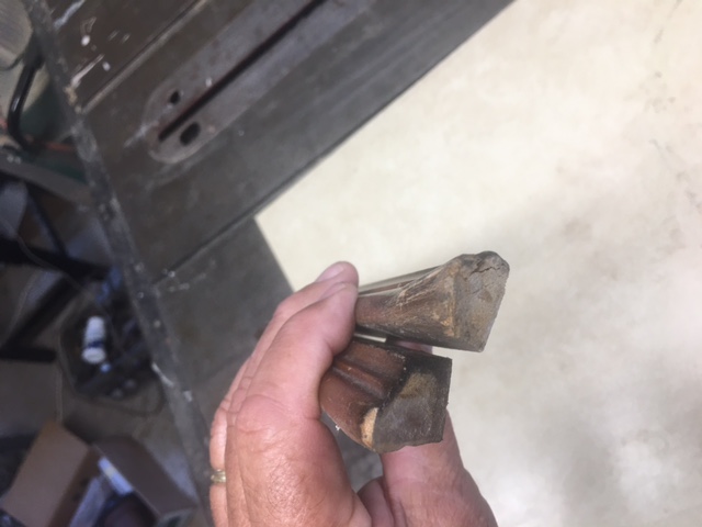

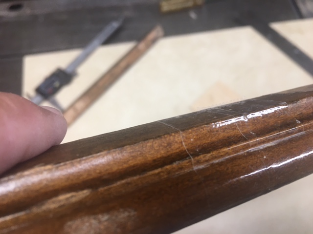

Badly damaged original base.

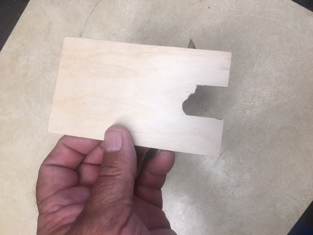

I start by making a pattern using 1/8 ply. First a notch is cut roughly the shape of the original trim but, a little larger.
Cellophane tape is applied to an undamaged section of the original trim to protect it.

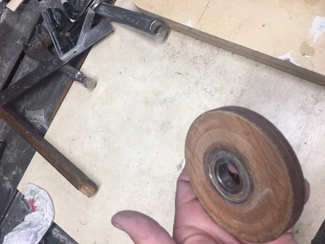

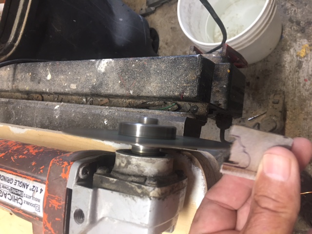

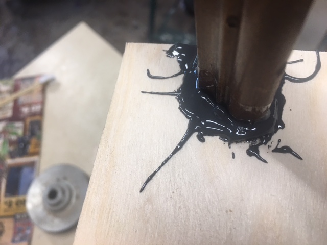

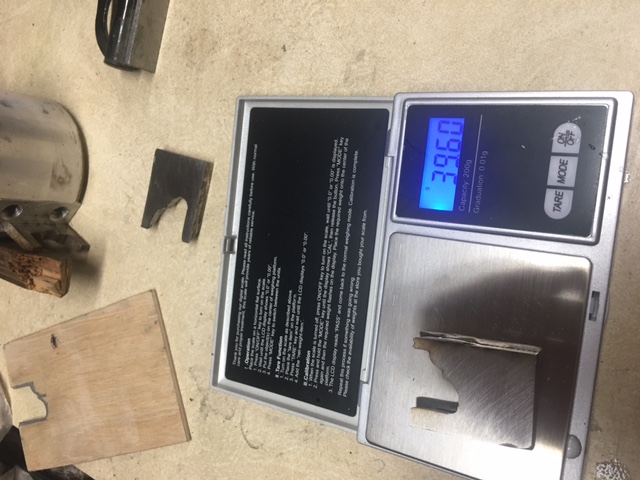

I'm now ready to grind the knives and set up the moulding head. Because this set of knives will only be used to run a very few feet, I am going to cheat just a little bit. There are two knives in the head, one will be ground to perfectly match the original trim, the other will be ground a slight bit loose. This makes the whole process so very much simpler. One knife will do the cutting, the other will act as a counter balance. By using a slightly slower feed rate, the cut will still be excellent.

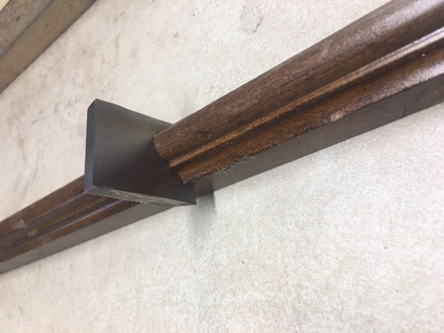

I used the pattern to draw the profile on the knife blank. Using an angle grinder, mounted on a board, I slowly and carefully grind the knives. After grinding, I use a tapered stone to hone the cutting edge.

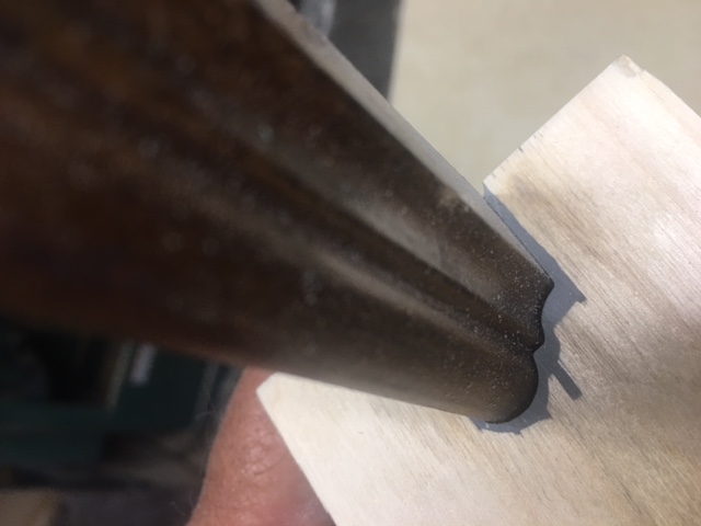

Checking to make sure knife matches the original trim.

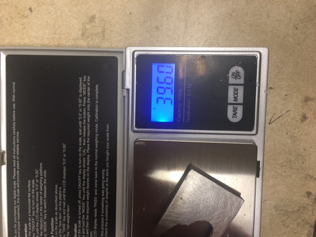

Knives are weighed on a gram scale and material removed as necessary to achieve balance.

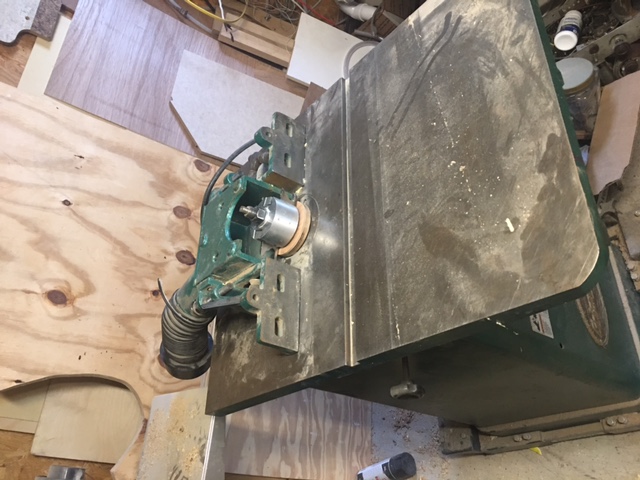

Mike, I will be using a wood shaper to do the actual cutting. It is like a giant router, only the machine is fixed and the work moves. I will get to that.

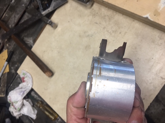

Setting up the moulding head.
The knives are installed in the head and carefully indexed. The back side of knife blanks are corrugated as is the head so once the set screws in the gibs are tightened there is no chance a knife could be thrown from the head.

The head has been installed on the shaper, We are now ready to make the chips fly!

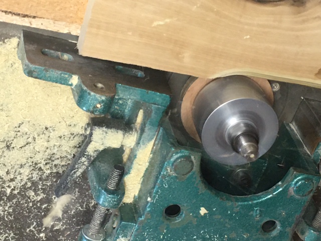

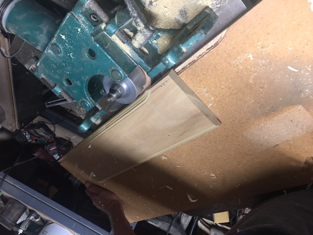

Now, the actual cutting.

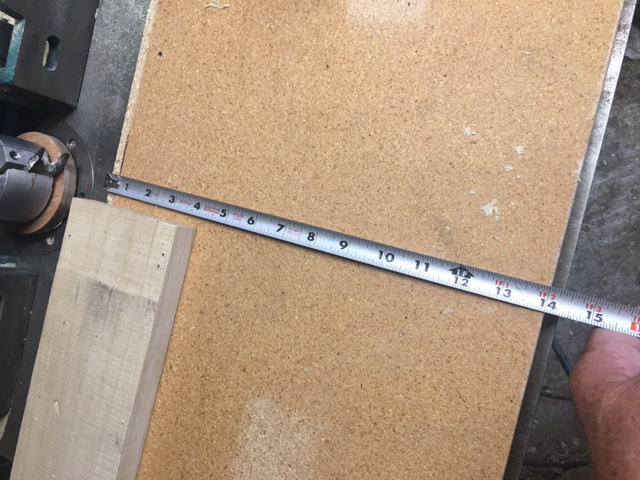

Before someone starts ragging me about having no guarding, I want to say, when using a wood shaper even well designed guards will only provide minimal protection. The best protection is to have a clear mind, pay attention and keep your hands far away from the cutting head. One mistake and your fingers will hit the wall before you know what happened. You can see I am using a very large guide board, this allows me to keep my hands at least a foot from the head. The work piece is screwed to the guide board, the guide board runs along the rub collar to control the depth of the cut.

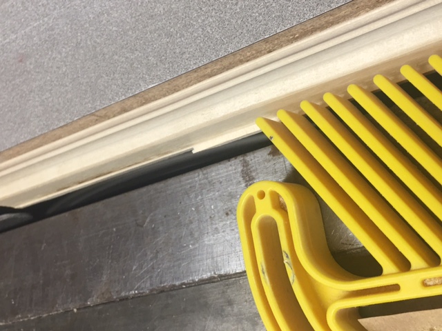

Making the cuts.

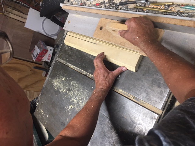

Using the table saw with an axillary fence and a push block to part the trim.

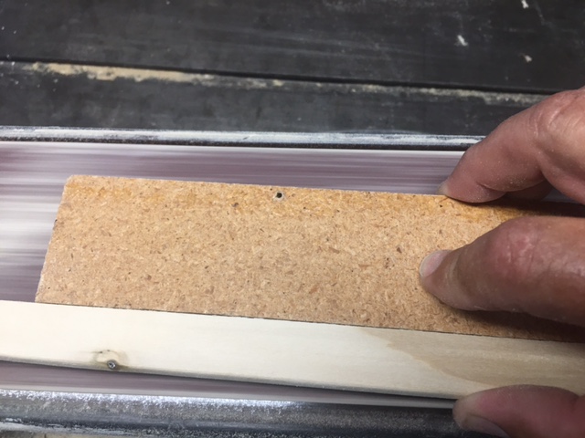

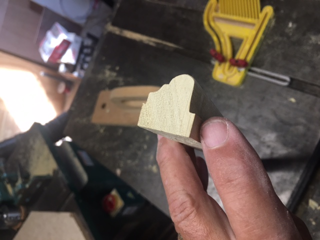

After parting, you can see we have a small step top and bottom that will be removed on the table saw
The steps are sawed on the table saw then the last bit is removed on the belt sander.

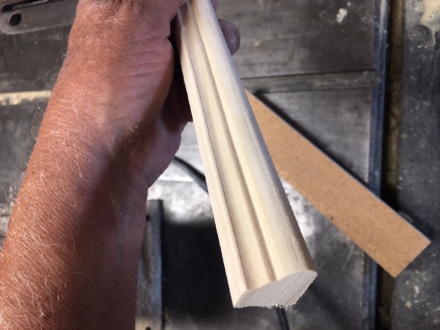

The finished trim.

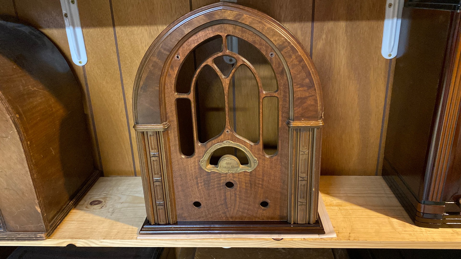

Steve sent enough trim pieces to make three sets of trim - if I was careful with cutting it, that is. Otherwise, I had enough trim to compensate for any errors in cutting.
I tried to be careful.

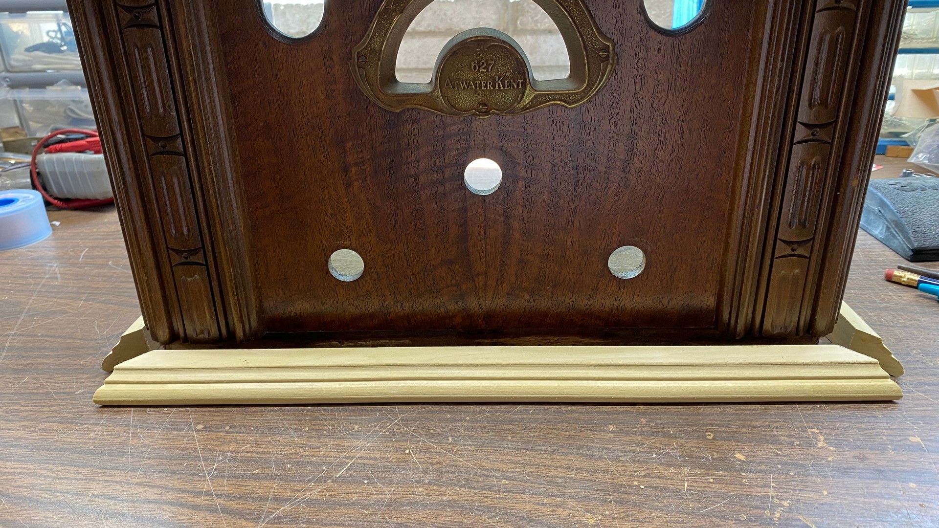

Here is the result after cutting.
Eventually, I finally got around to toning the trim. I did not like the results at first, as none of the toners I had in stock came anywhere close to replicating the original color of the old trim.
So I stripped it, and started over by first spraying with sanding sealer, then toner.
This time, I used one of the cans of toner I had purchased more recently - Mohawk Ultra Classic Medium Oak/Tavern Pine. A test spray seemed to indicate this color was close to the color of the trim surrounding the cabinet's front arch, so I used it.

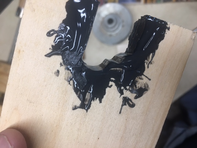

As luck would have it, the toner did not go on evenly on the first coat, so I was forced to apply a second. This not only made the trim dark, but the toner also ran on top of the trim!
I was going to trash that trim and cut three more pieces, but I decided to try something first. I took the trim to my workbench once the lacquer was dry, and wet sanded the tops (only) of the trim pieces until most of the toner was gone. Then I gave the tops of the trim pieces two more coats. This seemed satisfactory (if dark), so all three trim pieces were given two coats of clear semi-gloss lacquer.

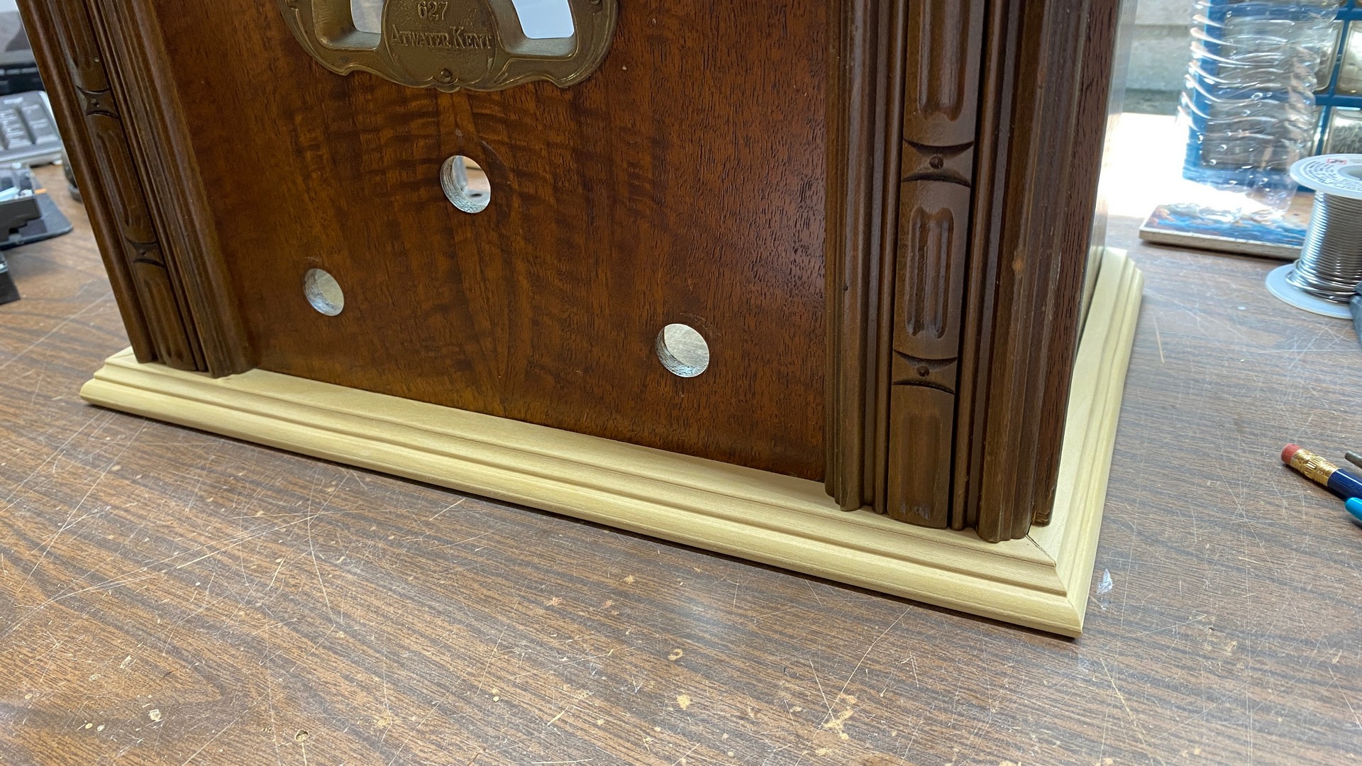

Here is the result...
Yes, the trim is darker than the rest of the cabinet, but since I had no Mohawk colors which came close to the original colors, this is a pleasing contrast, I think.
I still need to fill in the nail holes with wood filler, then dab a bit of Medium Oak/Tavern Pine on each filled spot. And then to add the new grille cloth, and possibly restore the chassis this fall or winter, Lord willing.
The cabinet still carries some "battle scars", but after careful gluing and the addition of the new trim, it looks much better than it did when it arrived.
Thank you so much, Steve!
