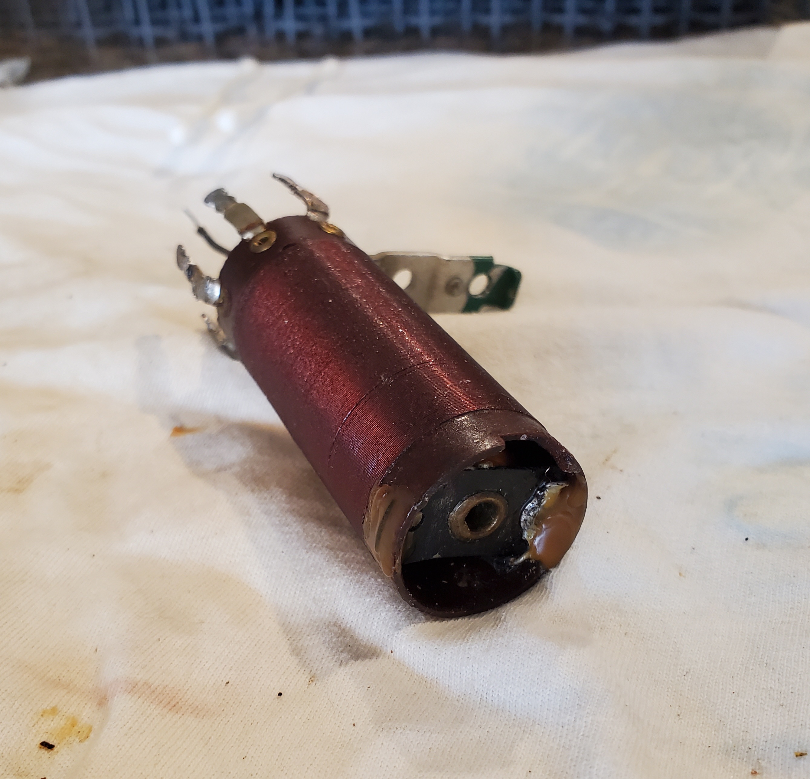

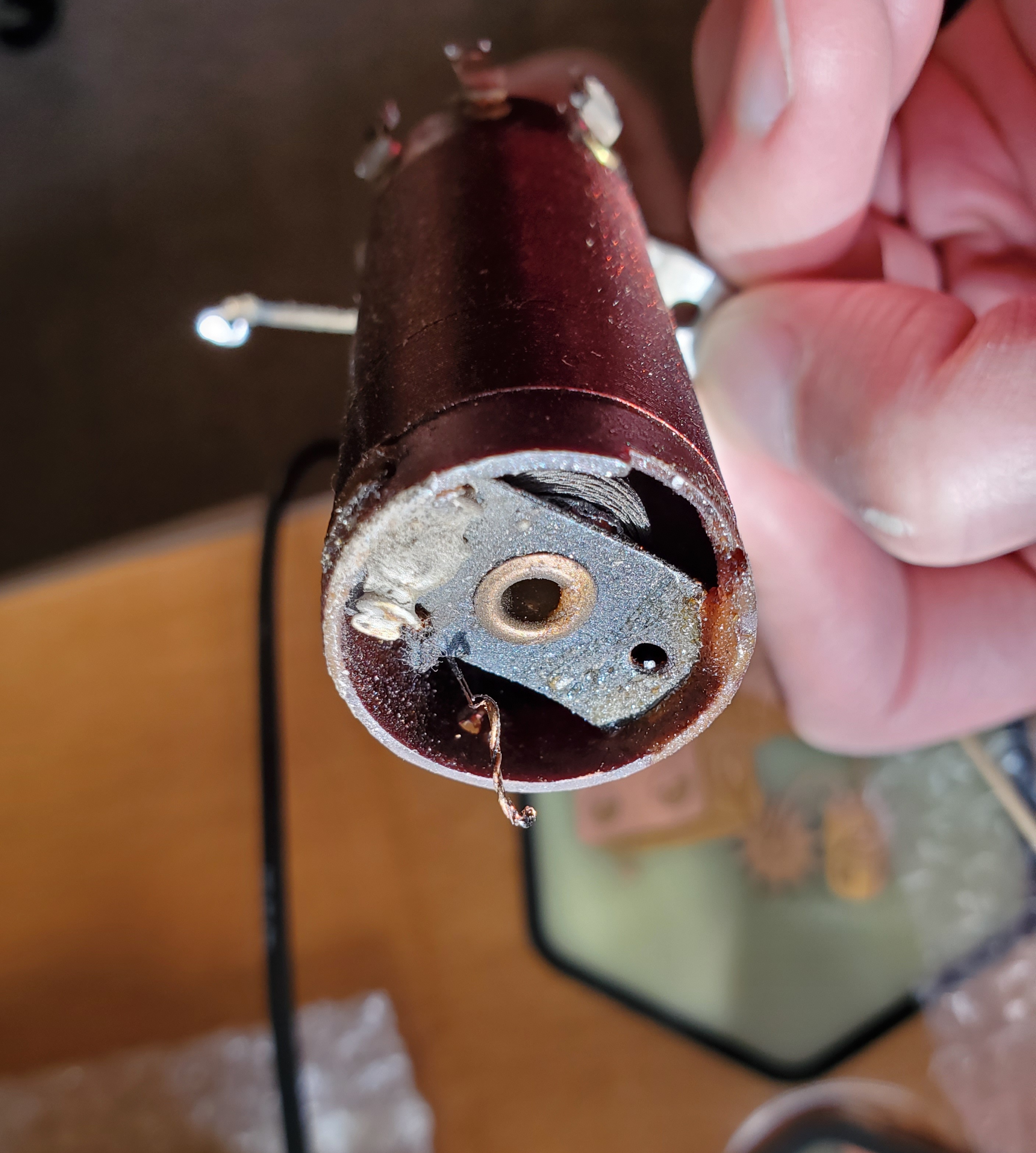

I've been chasing down an intermittent and challenging issue with periodic and temporary volume drops. I finally found the likely cause today, an open antenna transformer primary in which the broken wire was making intermittent contact to the outside of the coil. The coil looks to be charred from lightning damage.
The entire transformer is part number 32-1062.

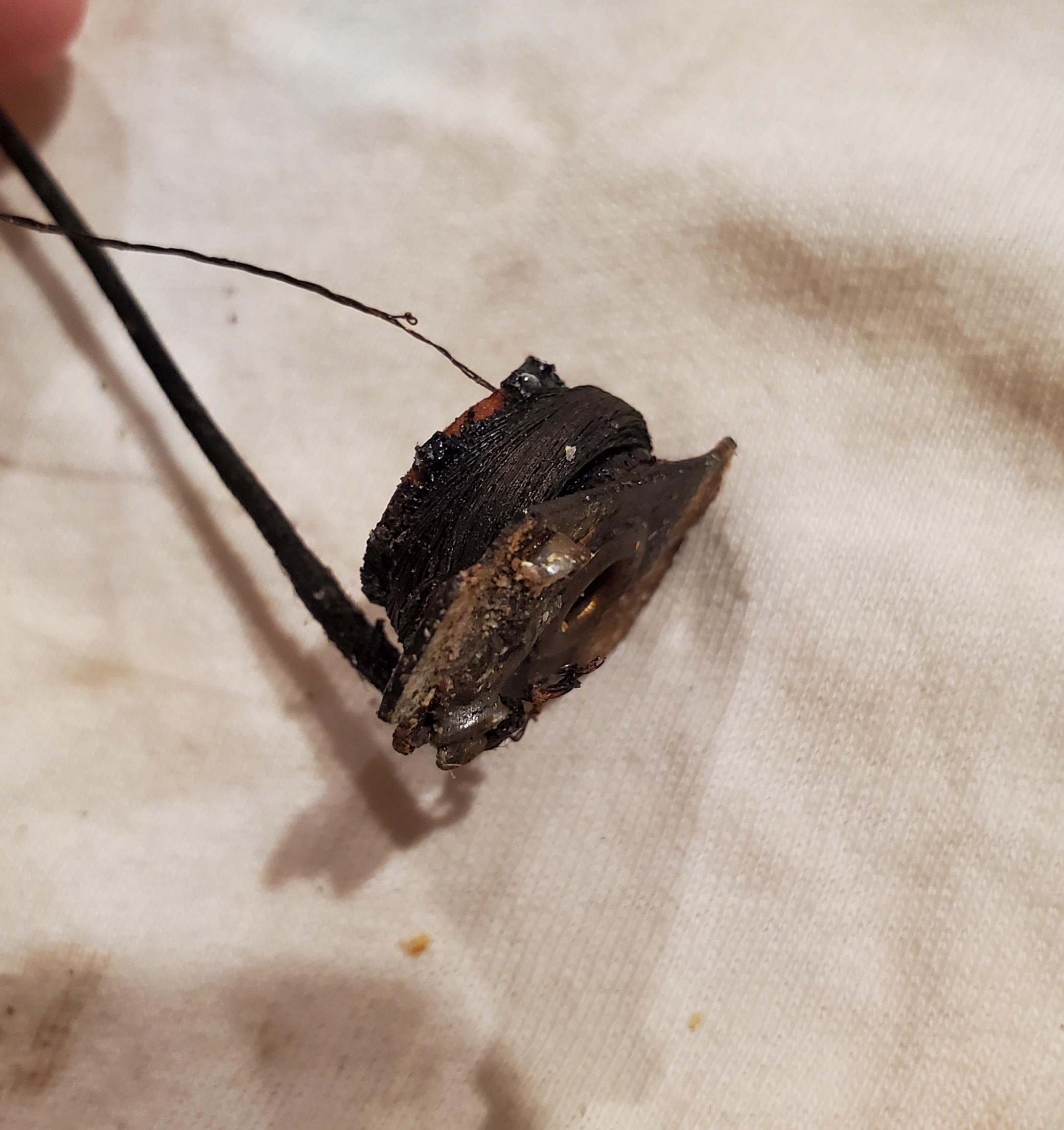

Using a tip from Ron's blog (RIP), I was able to pop out one of the cardboard tabs and remove the crispy primary coil. Nicely charred.
Use it as a spice.
Old spice.
Let the spice flow...
The original wire was too friable for me to be able to count turns. Since that's not a critical parameter anyway, I'll just scramble wind roughly the same amount of wire onto the bobbin in the same direction as the original.

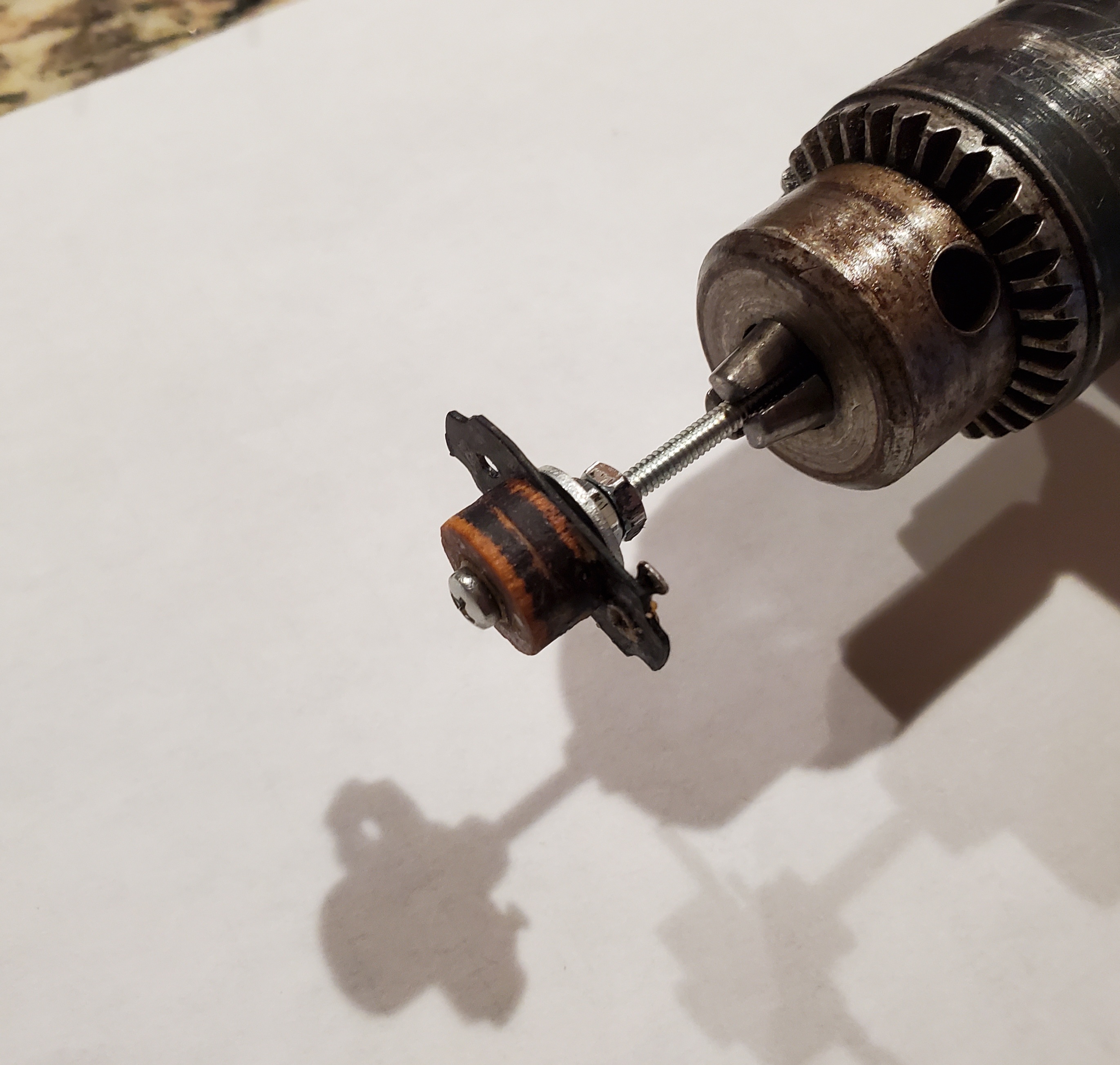

I completed the rewind with AWG 40 wire.
The Nostalgia Air link notes the primary should be 27 ohms. Ron's (deactivated) blog suggests the original may have been AWG 38, which is about 0.66 ohms per foot at room temperature.

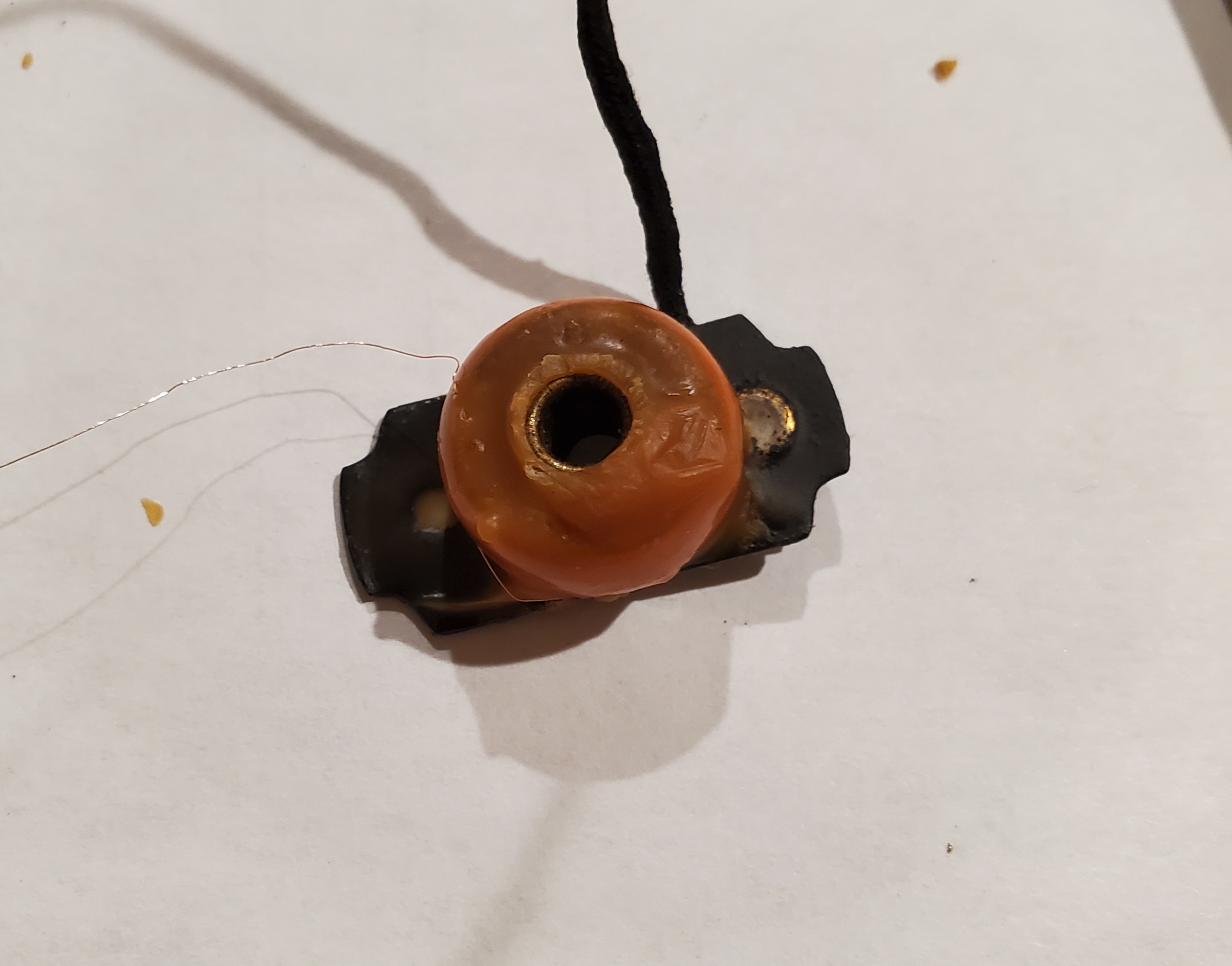

My rewound coil measures 85 ohms, so I may have overdone it a little and put on ~80 feet of wire when the original likely used closer to 40-45 feet. I've coated the coil with wax already to keep the fine wire in place, so can't easily remove turns.
Any reason not to just use this as-is?

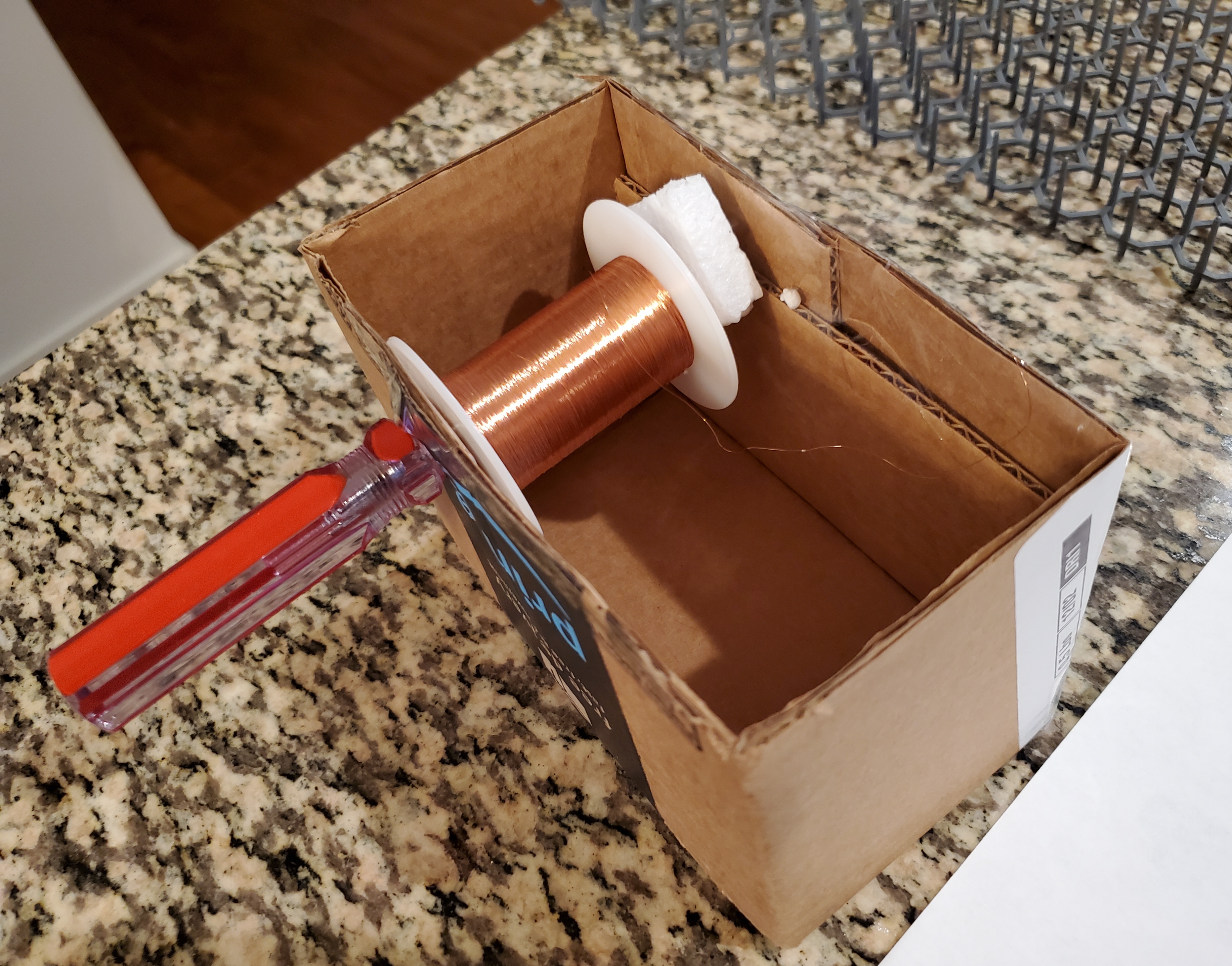

Photos of my poor-man's coil winder and the final product attached.
Given the choices, I'd rather have too much wire problem rather than not enough. Try it as-is ... If it needs finer tuning, just unwind a little until you find the spot!
Regarding your "poor man's" coil winder ... Absolutely brilliant! Functionality without incurred cost ... all good!

Living in the South we would call your coil winder great redneck engineering. In your parts Yankee ingenuity. I like it! David
Thanks, Gary and David! Makes sense - and hard to believe it will be any worse than the zero-turn coil it had previously...LOL
I used a wine bottle cork from the top to pop the primary coil assembly back into the slots of the secondary's coil former. I then used some drops of molten wax to "glue" the tabs into the slots like original.
All windings still have continuity, so at least I didn't break anything. I won't have time to reinstall the transformer until the weekend. Fingers crossed!
The repaired transformer is reinstalled and the radio is working well - no sudden and intermittent volume drops (which prompted this repair effort) and improved sensitivity on both bands. So, more proof that the turns ratio in this applicaton is not critical.
