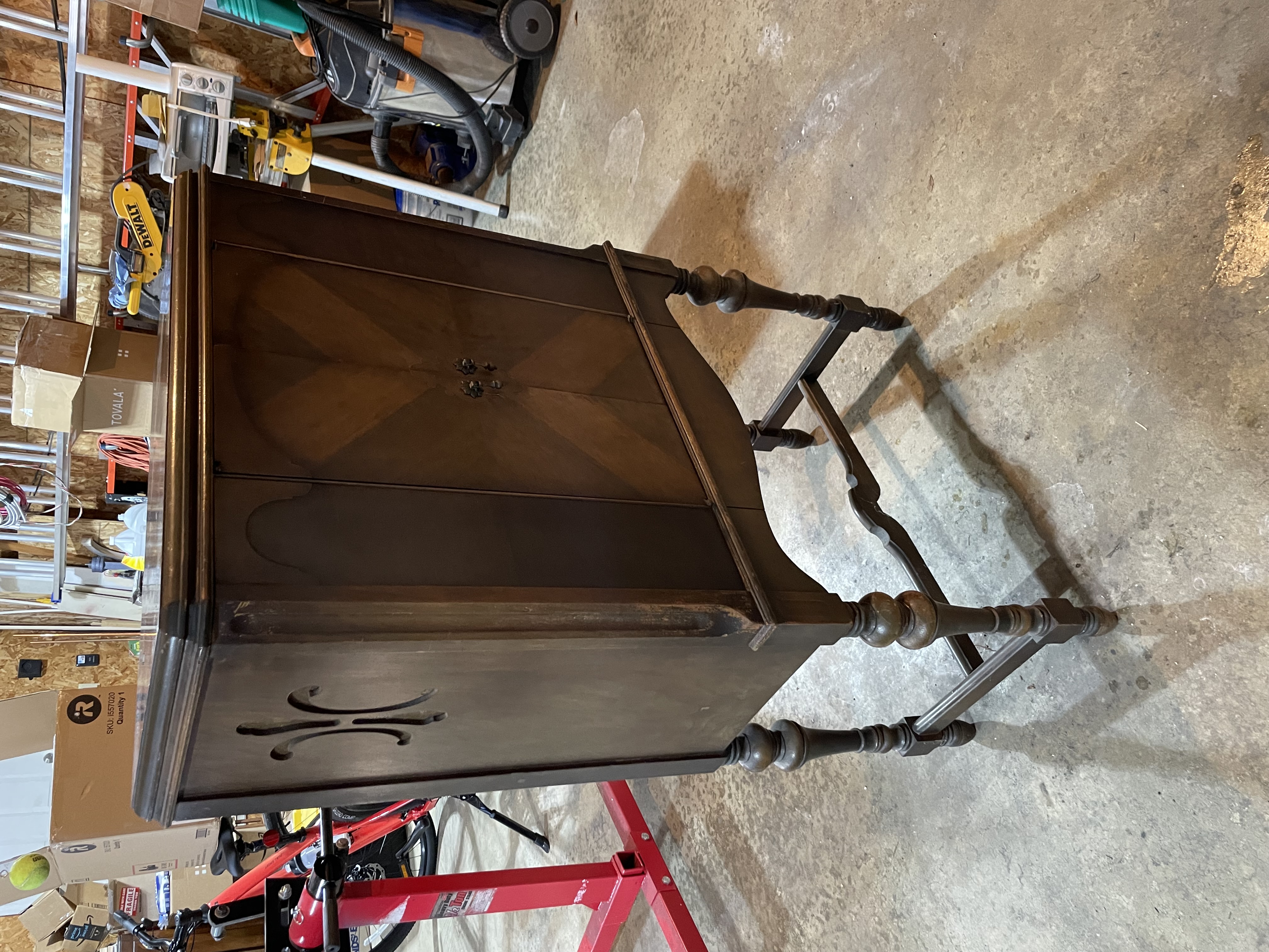

Todays score Philco 95 in great shape original finish.

Wow! Nice find! The speaker cloth is in amazing shape as well. I've seen a lot worse tapestries. Take care and BE HEALTHY! Gary
Nice set but not an 87.
Ok I believe a Philco expert.  Not enough label left to go by so I was trying ID it based on Ron’s book.  What is it, 73 Highboy then or a 73?  Help?

I thought you might ask. I'm pretty sure it's a 95.
The 87 doesn't use that large shield across the back. It's setup to use neutralized triodes tubes (#26's). A lot of the chassis are missing the shields, if the tube behind the shield don't have grid caps it's probably a model 87.
The 76/77 look pretty much like the 95 but the ant/gnd connect terminals are spaced apart farther. And the tube shield is much shorter. Both the 95 and 76/77 use 24A tetrode tube which do have a grid cap.
Think it's the 1st Philco w/avc. Back in those days avc was cutting edge tech on the other hand trf set were old hat '30.
https://philcoradio.com/library/index.ph...chematics/
OK now you got me running back tot garage to look.  Removed the shield, one tube left, and it was a #24, three spots all with grid caps.  I'm a hobbyist that's trying to make it self supportive LOL.  I love doing the work and love the history and I'm always looking to learn from the experts.  So maybe it's a 95 and I have to update three separate posts that I sent out LOL.  How can, I be sure?  I have 50 plus radios now 28 of them Philco's.  I keep the ones I like and restore then flip the ones I don't want to help pay for the hobby.  LOL the wife is wondering do I really need 5 hobby's.

To answer your question I don't think there is a US model 73. Maybe a in CA or over seas  but not here.
So model 95 as you suggested originally.

Sorry I was a question behind. It could be a 96 as the chassis are all most identical but it's not. Yes it is a 95. There are some circuit differences but the outward one is the spkr plug is smaller on the 96.
The Fall 1929 Philco Radio Gallery has a photo of your model label if you wanted to compare them. If Terry says it's a 95 I'd take it to the bank. Not much this guy doesn't know! Take care and BE HEALTHY! Gary
Thanks for all your help as always. Model 95 it is
