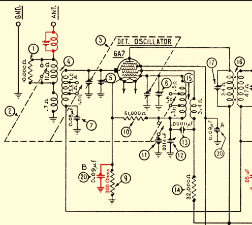

Need some help on the wiring a trimmer #12 for 600kc. This is the lasted run #11 changed from trimmer #11 to trimmer #12. How is this trimmer for 600kc. to be wired. It looks like it is ground to pin #1 of osc. Will this work for trimming 600kc?
Jim
Spring Lake MI
(This post was last modified: 03-19-2024, 07:47 AM by Jimradio.)
Posts: 1,797
Threads: 55
Joined: Feb 2015
City: Roseville, MN
Yes, this will work the way the schematic shows. A variable cap connected in series with an oscillator coil is called a padder and is tuned at the low end of the specific band, in this case 600khz. Variable caps in parallel with an oscillator coil are trimmers and tune the upper end of the band.

I also found that the #12 padder has a wire that goes to the band switch, which when the switch is put in the SW band position the lead coming from the #12 padder mates with the 4100pf cap. which goes to ground. The band switch wire is connected to the same terminal as the lead that goes to the osc coil on the padder. The 4100pf cap was put in there to replace the trimmer #11.

I thought I was doing ok. I have not removed the antenna coil, the coil ohms out great, but I do not see the coil which is rated at .7 ohms. on the schematic it is on the bottom on lug #4 of ant. coil. How important this is.

Here's a thread from when I worked on my 60MB with the 0.7 ohm section open. It is required to be connected as you will read in the thread.
https://philcoradio.com/phorum/showthrea...3#pid86373
Here's a helpful note from Ron Ramirez that i referenced in the thread.
https://philcoradio.com/phorum/showthrea...6#pid27896

Here's how I see it. The ant coil is a red herring so far, I'm still back at the osc and 1st IF trans. Think of it like this. The 6A7 is pentagrid converter tube but inside it's a triode (osc bottom section) and pentode for the ant or rf section stacked on top of each other.
Pins 4,5, and 6 are all connected to the osc circuit. Pin 4 is the "output" of the osc in that it radiates throughout the tube. The grid cap (grid 4) has the signal from ant circuit. Inside the tube these two signal are being mixed together but there are three resulting signals at the mixer's output. If the set is tuned to 1000kc for instance you'll have a signal at 1000kc, 1460kc (in your case) and at 460kc. Philco I think is the only company that used 460kc IF's from late 1932 till '38. Then for a few yrs it was 470kc and finally 455kc in the beginning of the '40 season. By the late '30s 455kc was the standard but should always check the paper work to be sure.
So it's pretty important that IF stage is working properly to discriminate and pickup only the signal at 460kc . All of the trimmer for the adjustment of the IF should a pronounced peak. I like to feed the signal thru the grid of the mixer for the align of the IF rather than connecting it to the transformer. The generator tends to load the circuit which throws the alignment out a little.
If you have a spare 455kc IF input transformer I'd give that a try and see if it will tune up 5kc. Even one from an aa5.
The resistance measurements of coils don't really mean much, unless they are suppose to be a low resistance and read very high. Coils are all about inductance, Q, and resonance.
