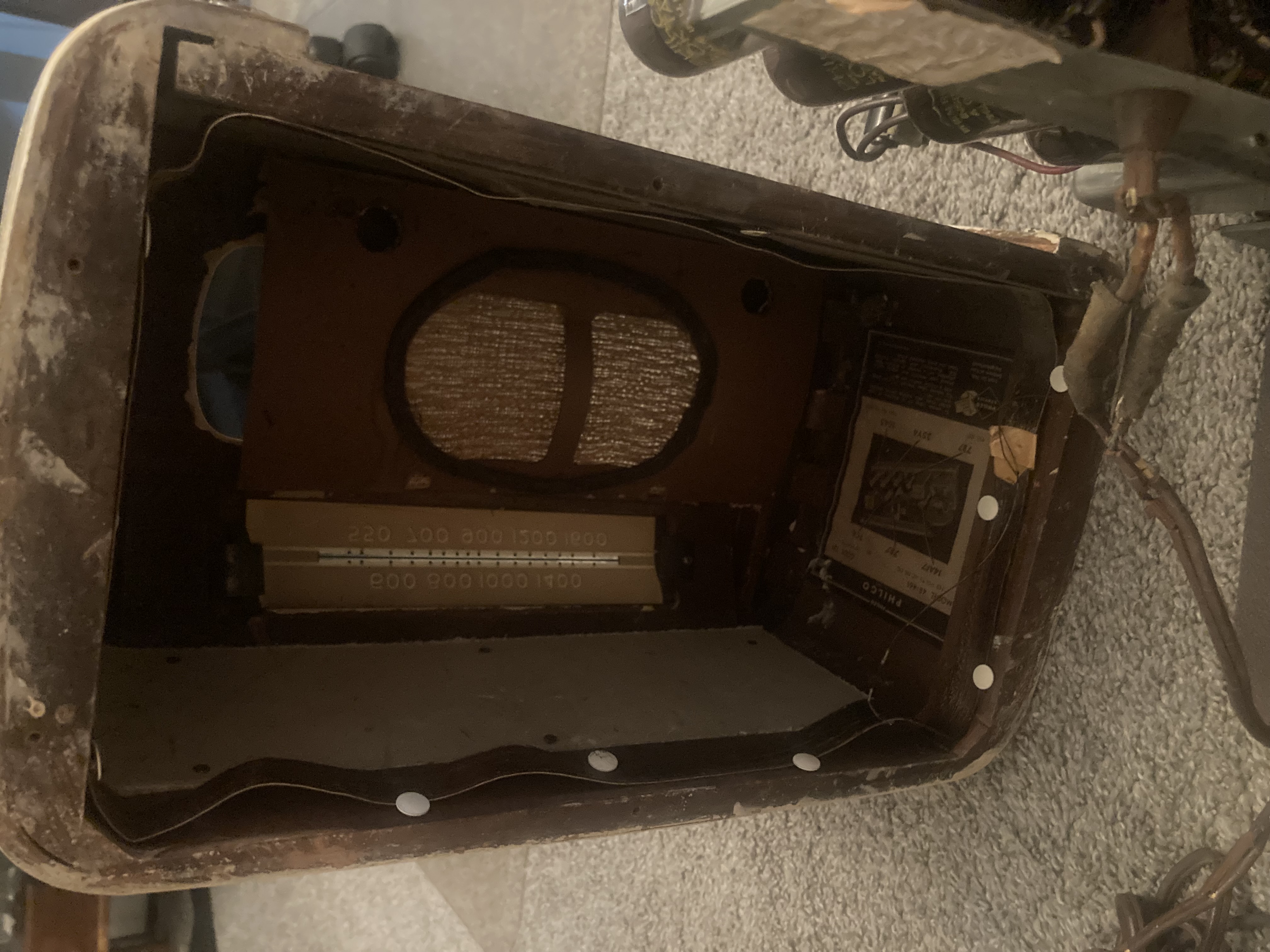

The antenna going around the case is falling out what can I use to stick it back in ?
Can you post a photo so we can see what it looks like?
as you can see someone attached it with thumb tacks
Also on the c100 the schematic shows a .04 line filter. Is that where I would put my line safety cap ?
Thanks for the help
The reason I asked for a photo was to discover if the antenna is part of the cabinet or mounted on the chassis and how it attaches. You can use any nondestructive method, Including the tacks. I see that the antenna lead wires are soldered so the antenna is meant to be a permanent attachment to the cabinet. If you don't want the tacks you can use a few dabs of hot glue or equivalent, just in case the antenna has to be removed.
