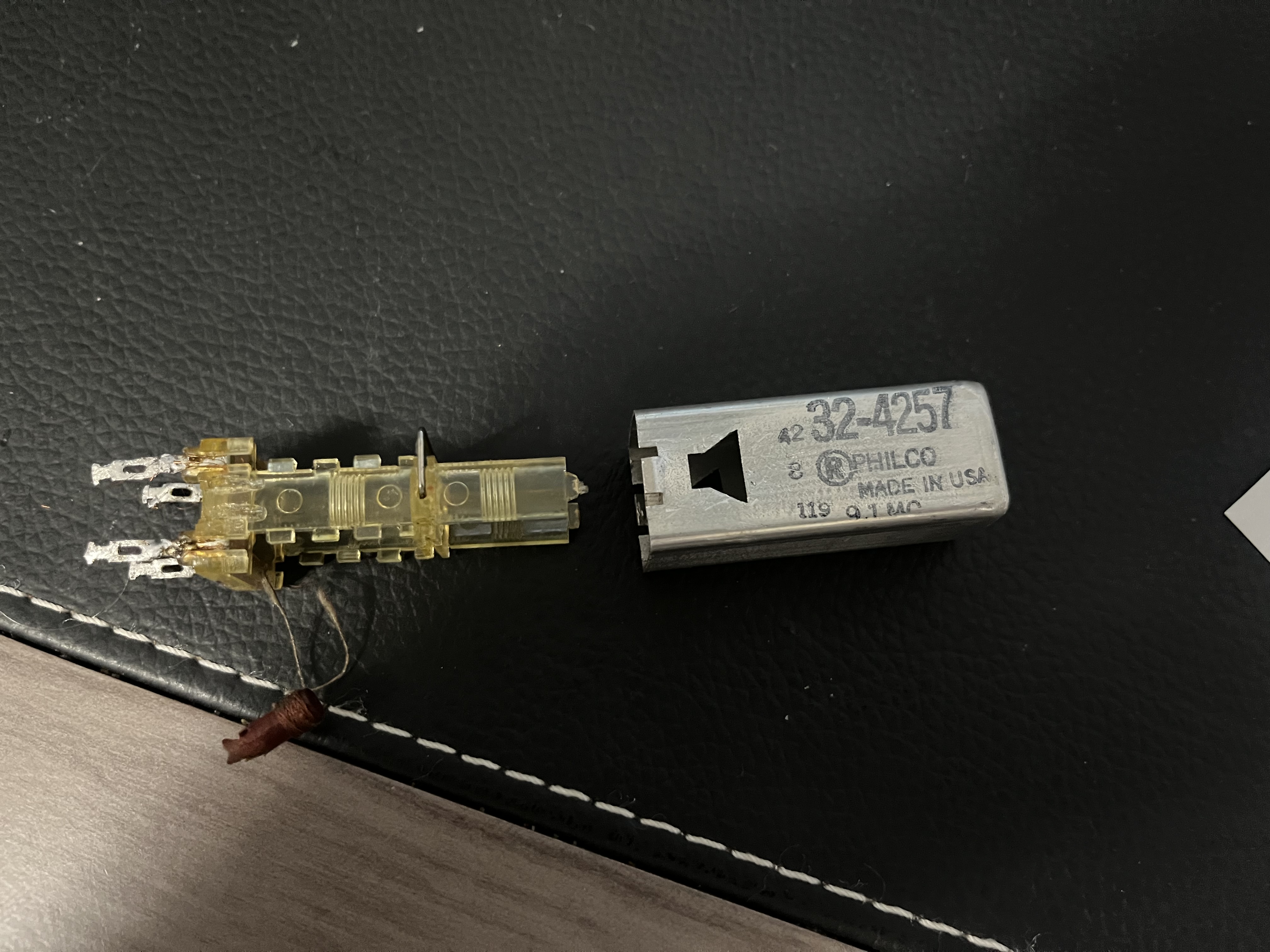

    I am restoring a Philco 49-906 and have run into a minor roadblock. Namely, I cannot align the FM circuit in full because the screws to adjust the first FM IF transformer are stuck in place. Peering into the top hole, it looks like the screw head is stripped. Has anyone run into this before, and how have you resolved it? I can imagine I need to desolder and remove the unit, open up the can, and somehow file a new flat-head groove into the screw head. Has anyone worked out a less invasive solution?

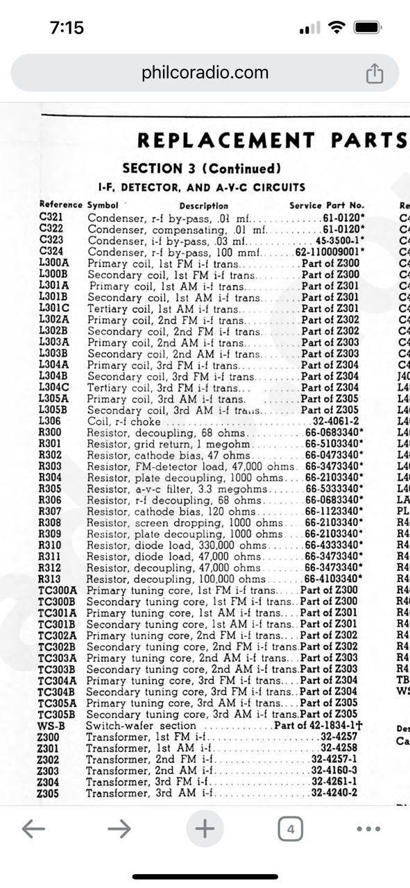

This is a Philco 32-4257 part (first FM IF can, 9.1MHz) and is labeled as TC-300A and TC-300B on the schematic.

Are these FM IF transformers slug tuned or are they the kind with trimmers? If the type with trimmers a small drop of penetrating oil may help get them out if the end of the screw isn't peened over or something. I replaced the trimmer screws in a Philco AM IF transformer and they were a very fine machine tread, I don't know what pitch, I pulled some replacements out of one from a scrapped set, the FM ones may use the same thread pitch as the AM ones, but a thread gauge would be useful for finding out.
Can a pix be posted of the offending IF can along with dimensions?
Some technician may have these as spare parts but un-marked...

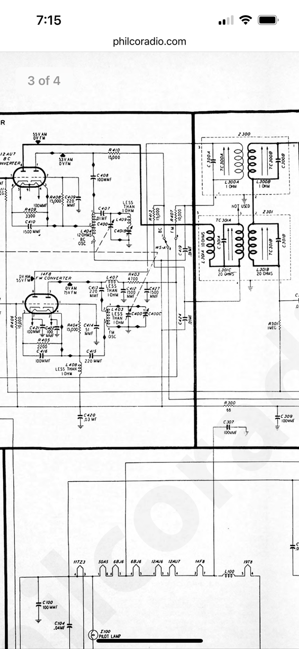

Yes I’d be happy to add some photos. Silly me; I should know by now to start out a post with some photos! The IF transformer in question is a Philco 32-4257. It is the first FM IF transformer in the Philco 49-906 (also in the 49-905). The base measures 3/4” by 3/4”, and is 1-7/8” tall. It has a resonant frequency of 9.1 MHz. It is a slug tuned circuit; the inductors are adjusted, but the capacitance is fixed. The unit in question is Z300 on the attached schematic. The primary and secondary impedance DC impedance are both 1 ohm.
