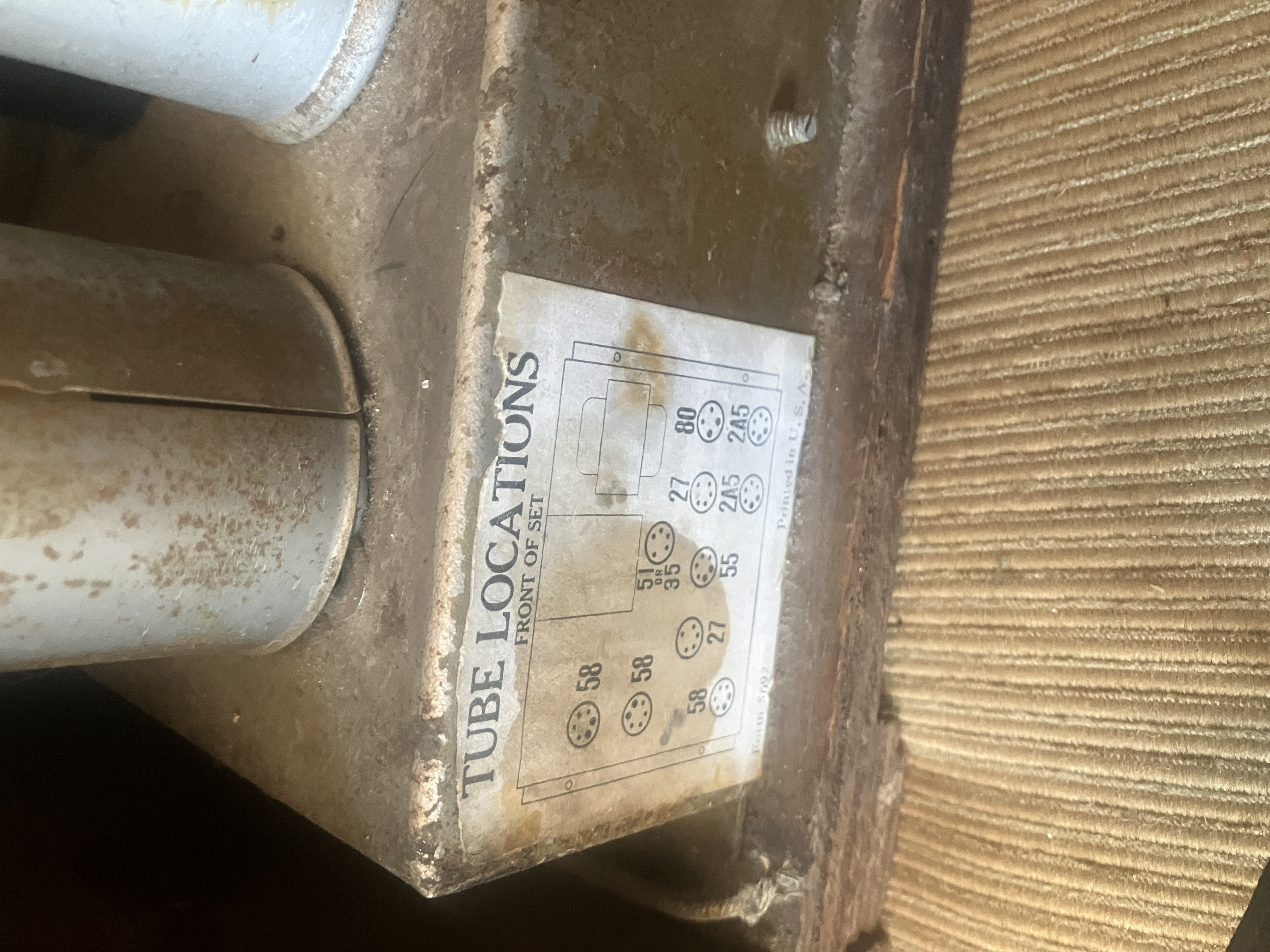

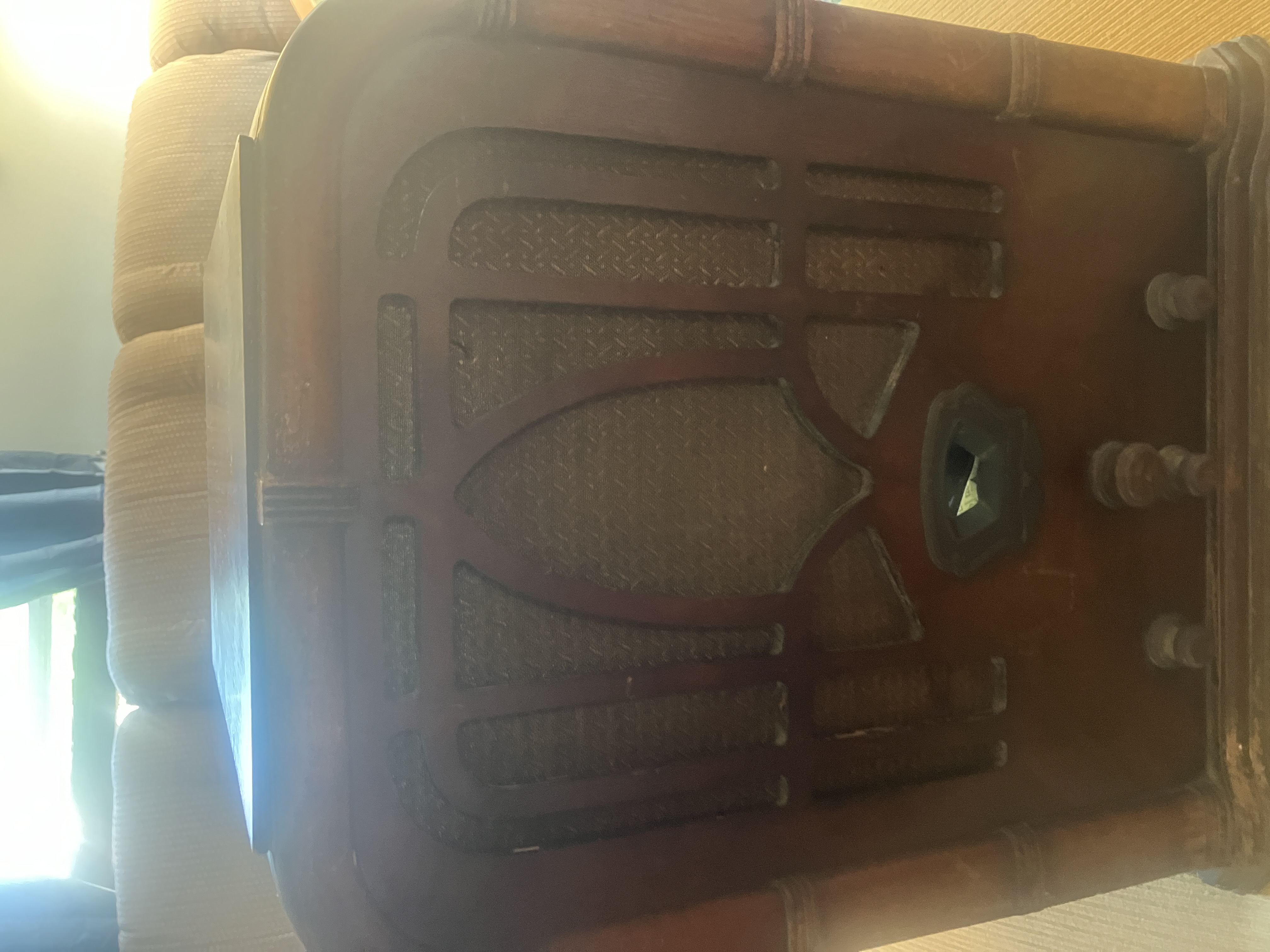

Hello everyone today I took a trip up to Michigan and picked up a 1930s Stewart-Warner Tombstone Radio that I need help finding a model number for it because all of the model number information tags are either damaged or missing from the radio and I know there's a website out there that you can use to find a radio model number by typing in the tube line up but I can't for the life of me remember the name of the website and I need this radio's model number to look up some service data for it for electrically restoring it, and also locating a replacement tuning dial for it because the original phoenolic tuning dial is broken and I need to replace it to help make this radio functional and complete again.
See pictures below.
Do any of you guys recognize this radio and what model it might be?
I appreciate any help you can give me.
Thanks.

Try radiomuseum.org for the tube list. That's a beast!
