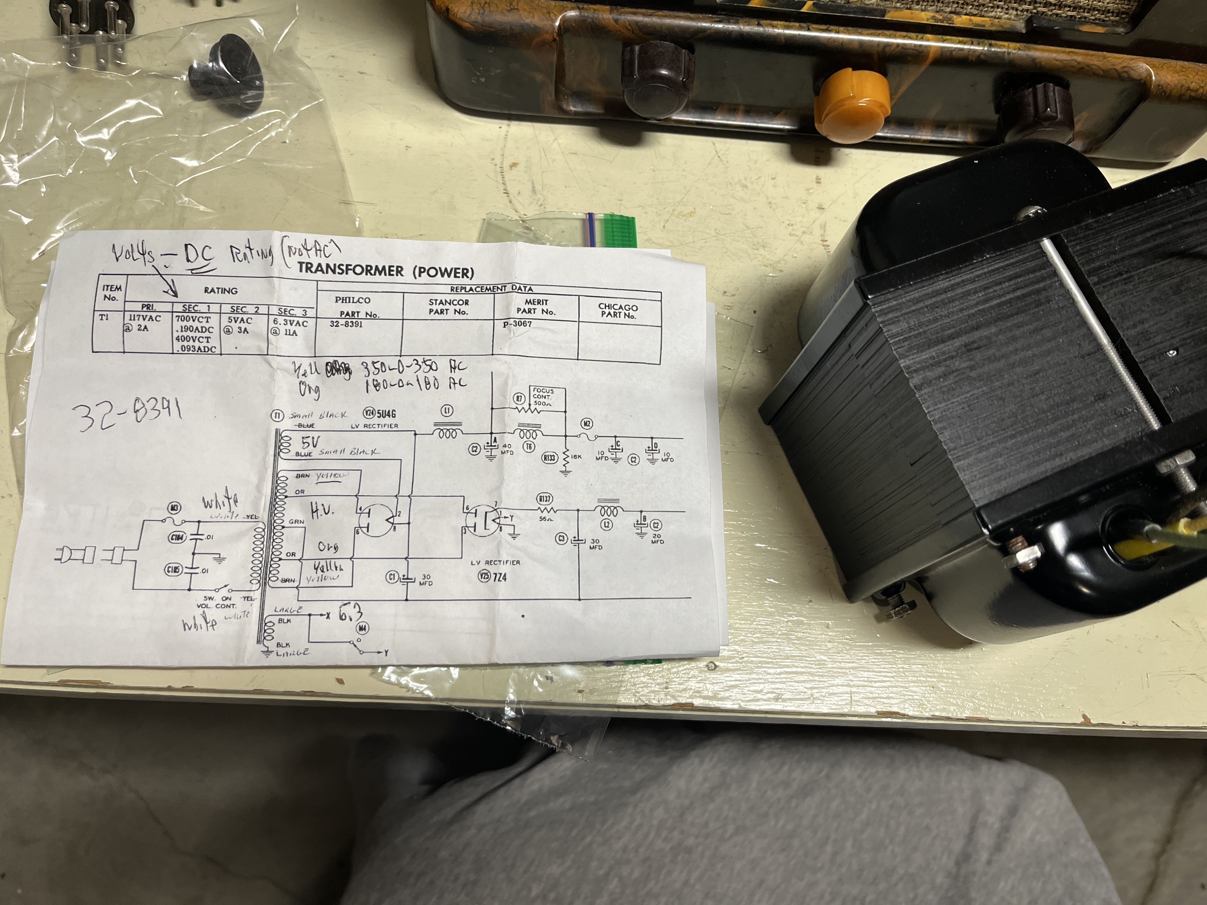

From my experience, unfortunately it is not uncommon to find the power transformer in the 39-116 to be overheated and possibly shorted. I have seen many examples that have either had their transformer replaced or are found with a damaged transformer. My thoughts on these are:
-For the physical size of the transformer and the demand this large chassis is putting on the transformer, they build up a lot of heat.
-The rubber wiring that was used by Philco and other manufacturers at that time deteriorated and shorted. The rubber coating turned rock hard, and the excessive heat accelerated the problem.
I am currently working on a 39-3116X which is the Canadian version of the 39-116X. Philco in Canada didn't use rubber covered wiring (Yay!!!) but on the 39-3116 chassis, they did source a number of specialized parts from the U.S. parent company, two of them being the power transformer and the selector lamp wiring harness. When I found this particular set, it had a replacement transformer haphazardly "installed" and I could tell from the burn marks under the chassis that a catastrophic end had come to the original transformer.
I was able to source a much beefier transformer to put in it...its from a late 40's Philco television! It has all the correct voltage windings, and it will juuuuuust fit into the chassis.

I had no idea that the overheating was problematic in this radio. Do you know the part number of the transformer you plan to use? I was surprised to find that the stock transformer HV secondary was only good for 131ma and the one 6.4 V secondary was good for 5A. I did not check all the tubes filament draw, but 11 tubes must be running very close to 5A. Though the 1942 parts catalog shows the transformer is good for 14-15 tubes. The Thyratron has its own 2.5V 2.5A filament transformer. I will check the motor transformer as it sits very close to the power transformer and may have been affected by the overheating. In looking through the parts catalog, I did see one transformer, 34-7455 for 15-16 tubes, that might fit the bill. It has dual 6.3V and dual 5V filament windings and the HV winding will handle 180ma. Not sure what chassis this was used in.
The existing transformer used cloth covered wires, though stiff, they are not compromised. The chassis itself seems to have about 50% rubber and 50% cloth covered wiring. The worst rubber wiring is in the station lamps harness.
I will not be doing any further work until I'm able to source a power transformer. Which is kind of disappointing.

The transformer I located is from a Philco TV chassis, circa 1948. The part number is 32-8391
I do have the replacement transformer that was in the set when I bought it. It does work, and is larger than the original one. But it is an upright style, and therefore you would need to make an adapter plate to cover the hole. When I bought the set, the transformer was held in place by two bolts. The part number is PT-86

Thanks so much for the info! Do you happen to have the specs for the PT-86 transformer? I did not find a listing for that part number. At least you've given me some ideas on transformers to look for. I'll probably go looking on Ebay for some options. The upright style mounting doesn't bother me. There is enough room for that. I'm sure I could probably make a cover plate for the chassis. I'm not a purist, but I do like things to be neat and tidy as much as possible.
One thing does concern me though. The existing transformer has an offset center tap. I'm wondering if this was due to the biasing requirements and would some changes be necessary to use a true center tap transformer. Or am I just making more of this than is necessary.

I'd be interested in hearing how the replacement TV transformer worked out for you. Were you able to get the proper biasing voltages? For some reason, I'm still hung up on the asymmetrical center tap. The schematic shows 85 ohms from one HV leg to the tap and the other HV leg shows 75 ohms. I figure there must be some reason Philco did this. So far, I haven't found any information on this type of transformer. I tried to model it in LTSpice but can't figure out how to set it up properly.

It is not any more asymmetrical than all of the centertapped transformers are.
SImply speaking, the same number of turns, as the bobbin gets filled up, requires greater length due to the increased length of every next layer.
Therefore, the same number of turns will show different DC resistance.

Ditto to morzh. I have rewound a couple of PT and have found the # of turns the same but DC resistance substantially different. Wire length is substantially different. Am rewinding an Atwater Kent 165 PT right now. Resistance readings were sort of close but enough different to question it. Wow, that thing was cooked inside. Really makes me question the long term reliability of these old transformers with old insulation. Yet, i have not had transformers fail on sets I have rebuilt. Fingers crossed! Good reason to add fuses to these old sets.

Rich,
I haven't tried to install the transformer yet into the chassis...I've been delayed and I need to finish three other smaller projects that are on my bench before I return to the 39-3116 chassis.
