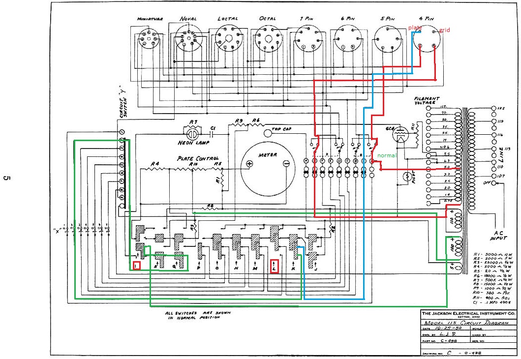

I did start to do that but I stalled out because I could not figure out how the grid and plate get voltage. In this diagram I created a scenario using a 01a tube, I moved switches L and S into position. 5v filament which I can trace ok. if I know what voltage to look for at the tube socket, that might help me diagnose it.
Usually in an emission tester, the tube under test is measured as if it were a diode. So, some testers connect all the grids to the plate or cathode. This is one reason I don't have much faith in them. All they tell you is that the tube conducts.
Now that you posted the schematic, I don't know why that Sprague electrolytic cap is across the meter, as it is not indicated on the schematic. It does look "1950"s.
I feel for you, as it is a nightmare trying to trace through the switches. I wish that the tester manufacturer drew a simplified diagram as if the set only tested a triode in the 4 tube socket with 5V on the filament.
