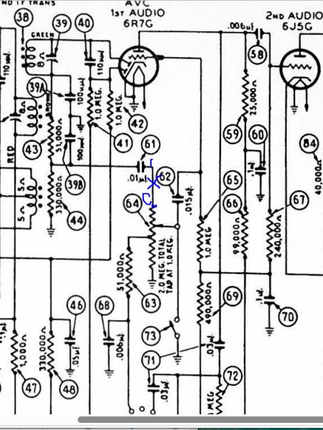

It wouldn't hurt to put a 0.01 uF cap between the deck and volume control.  However, there is a 0.01uF cap between the wiper of the volume pot and the grid and another between the high end of the pot and the signal from the radio.
Attached below is a section of the schematic showing where to break the audio connection to add the Radio-Aux switch and aux jack, and a schematic of the switch connections:
Switch shown in radio position.
You could connect the jack to the switch through a 0.1uF cap if desired.  If the device that you wish to connect is stereo, a stereo to mono "Y" adaptor is required to hear both channels.

Sorry, I did not see your post as I was writing mine. I would think that with a consumer electronics level Aux input of about 300mV, the output of the radio should be quite loud. The schematic rates this radio at 7W. However, if the amp sounds good and can be made much louder than you desire, the amp is good.
This radio requires a long wire antenna. If you have other radios of a similar vintage that also require an external antenna, this radio should be as sensitive as your other radios. By this, I don't necessarily mean how far the volume control needs to be turned; this radio should receive as many stations as the others and, unless the station is extremely weak, the stations should be te same volume.
This is a longshot but check out the muting switch, #71 and ensure that nothing has carbonized, causing a leak to ground.

Hi MrFixr55, Thank you for the drawing. I can handle that. I disconnected the muting switch from the center pin of the pot so that rules that out. While I was there I measured the pot and found it is 2.7 meg vs the 2 meg the schematic says. I had a junk 2 meg pot with the 1 meg tap that I swapped in but it made no difference.
