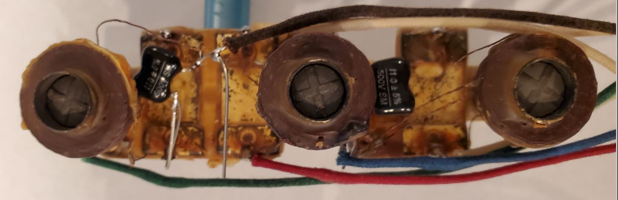

Good find on that cap!! I think after an IF alignment now, your AVC will respond correctly since it is already having some effect. A good place to measure it is near the source where the blue wire (if it's still blue) comes out of the 2nd IF and connects to the two 4 Meg and two 1meg resistors. Now your meter won't load down the circuit as much.

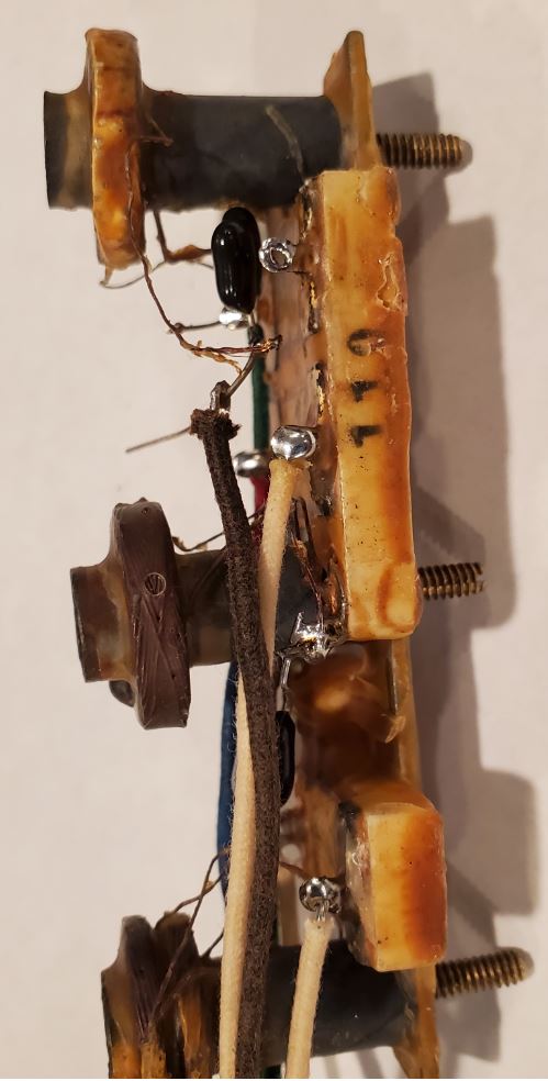

Looks like you can cut them in half if you have to. Was this unit inside a can or box?
