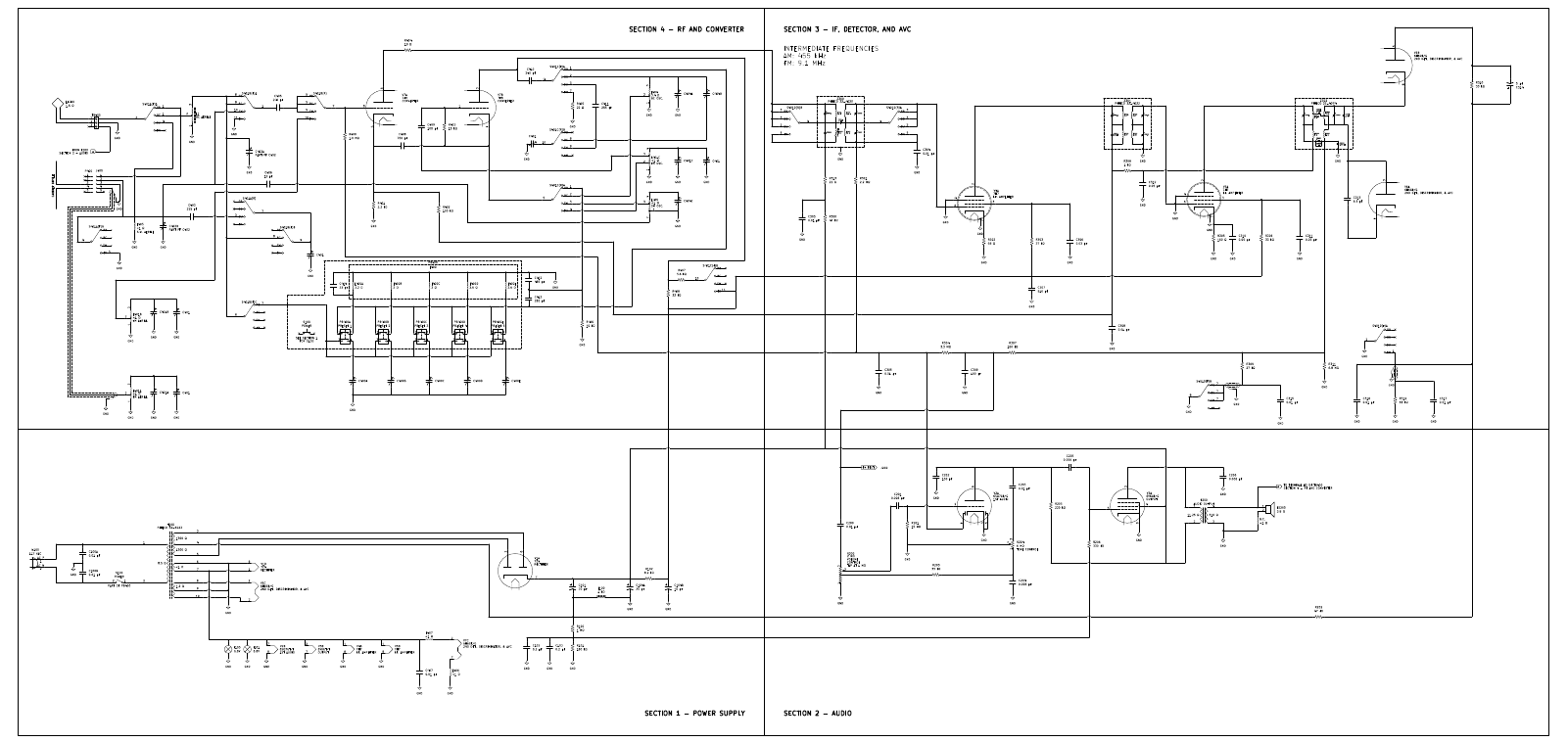

Good evening, folks! It's been a couple of months since I completed the restoration of the cabinet on my 46-480. I've been working intermittently on creating a more readable schematic than the scan available on the Philco Radio Library. Not only are a few of the values too blurry to read, but I've noticed a handful of discrepancies.

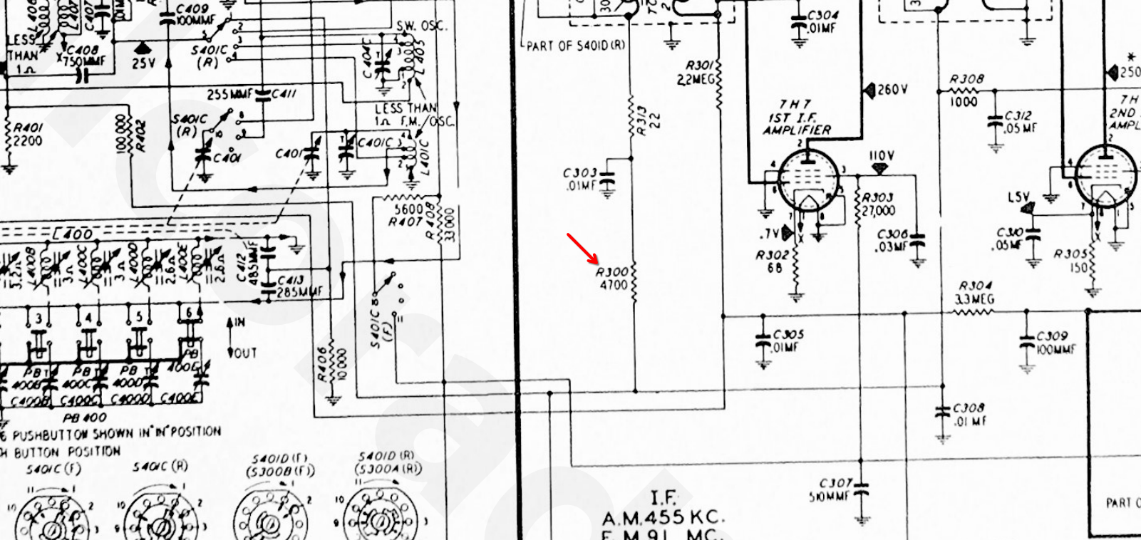

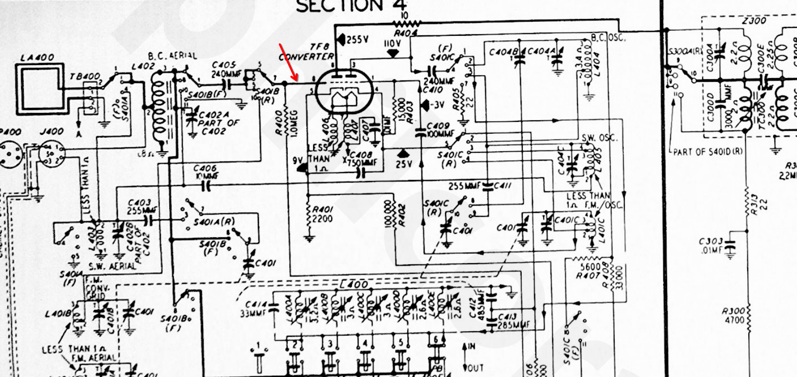

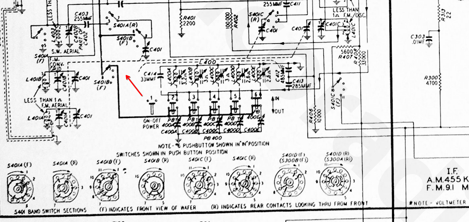

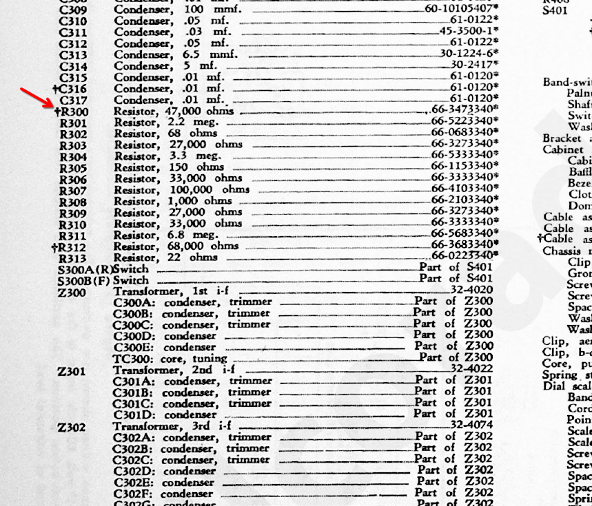

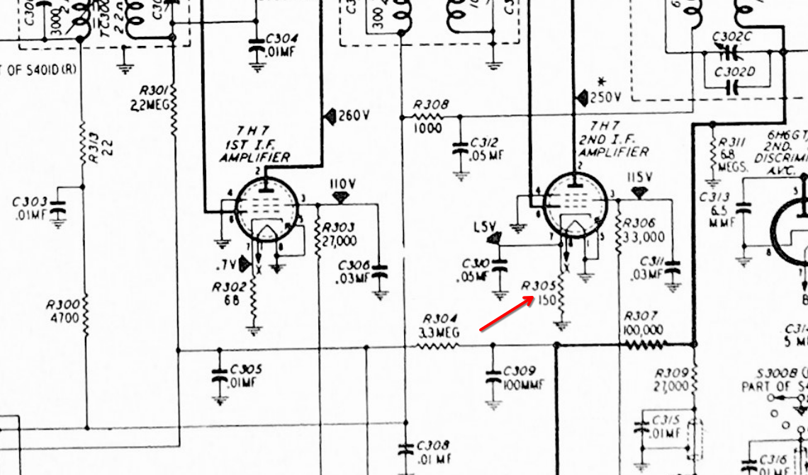

1) In Section 3, the overall schematic on page 113 of the document shows resistor R300 to have a resistance of 4700 (in other words, 4.7kΩ), whereas the parts list on page 114 indicates that R300 has a resistivity of 47,000 (in other words, 47 kΩ). Furthermore, the given part number is 66-3473340, which is the part number for a 47 kΩ +/-10%, 1/2 watt carbon resistor.

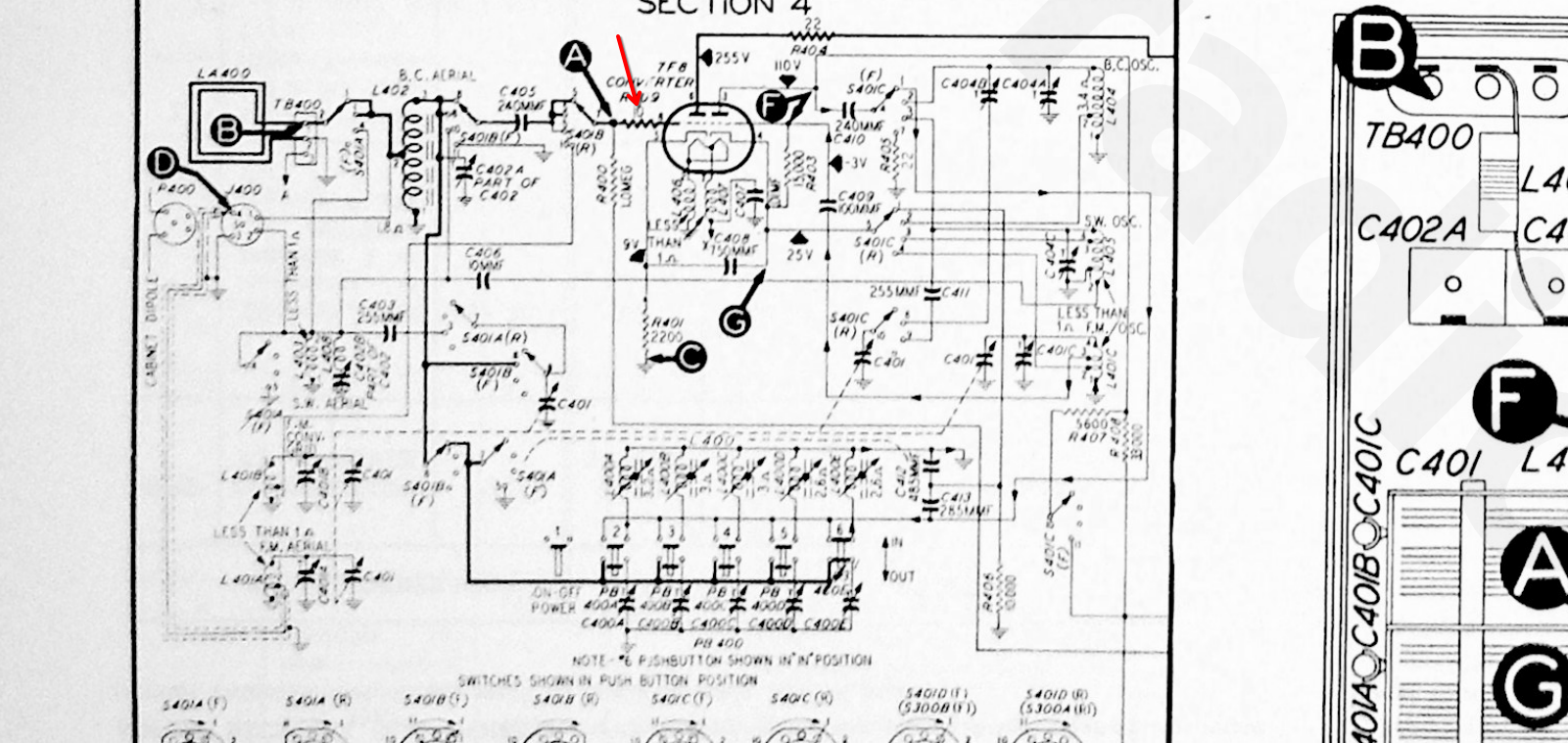

2) In Section 4, the overall schematic on page 113 of the document does not show a grid resistor on pin 8 of the 7F8 tube, whereas the partial schematic on page 109 of the document does.

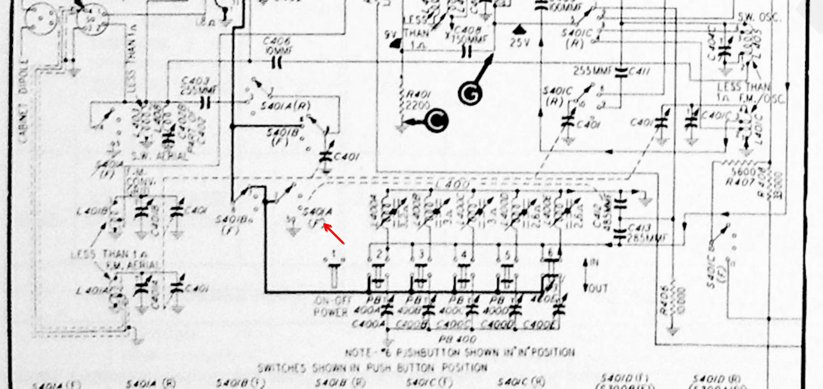

3) In Section 4, the overall schematic on page 113 of the document is missing an instance of the S401A switch, whereas it may be seen on the partial schematic shown on page 109.
Anyway, I have combed through all of the available paperwork and here's the resultant schematic (also see attached PDF). I now intend to comb through the chassis in its current state to verify that the schematic matches the as-built condition of the radio. Some of the capacitor values in the IF cans were not readable, so I'd like to confirm those by seeing what is physically installed. I also had to make my best guess on a few of the wires crossing over each other on the schematic--do they intersect or not? And, finally, I'd like to verify the pins on the wafer switch. Many of the pin numbers on the schematic were not readable.
I'll note that not everything is laid out exactly as you'll find it on the Philco schematic. I rearranged Section 2, for instance, to flow from left to right. I've also replaced older notations (for example MF and MMF) with modern-day equivalents (µF and pF, respectively). I've also moved the filaments of the tubes to the power supply section of the schematic (many other Philco schematics, for instance the 49-906, do it this way). You will also notice that tubes with multiple diodes and/or triodes within the same envelope (the 6H6GT/G and the 7F8) are shown as split. This is just how I've always drawn them.
I will follow up with a revised schematic after I parse my way through the chassis. I also plan to create a new revision depicting the replacement equipment. I'd like to add a 1A fuse to the power section for instance. I already have this depicted in revision 1 of my file. I also have the safety capacitors for the AC line depicted in revision 1.

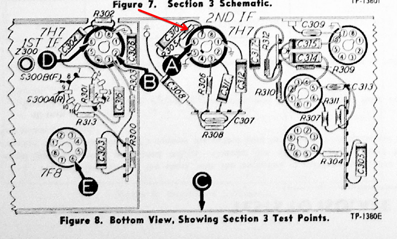

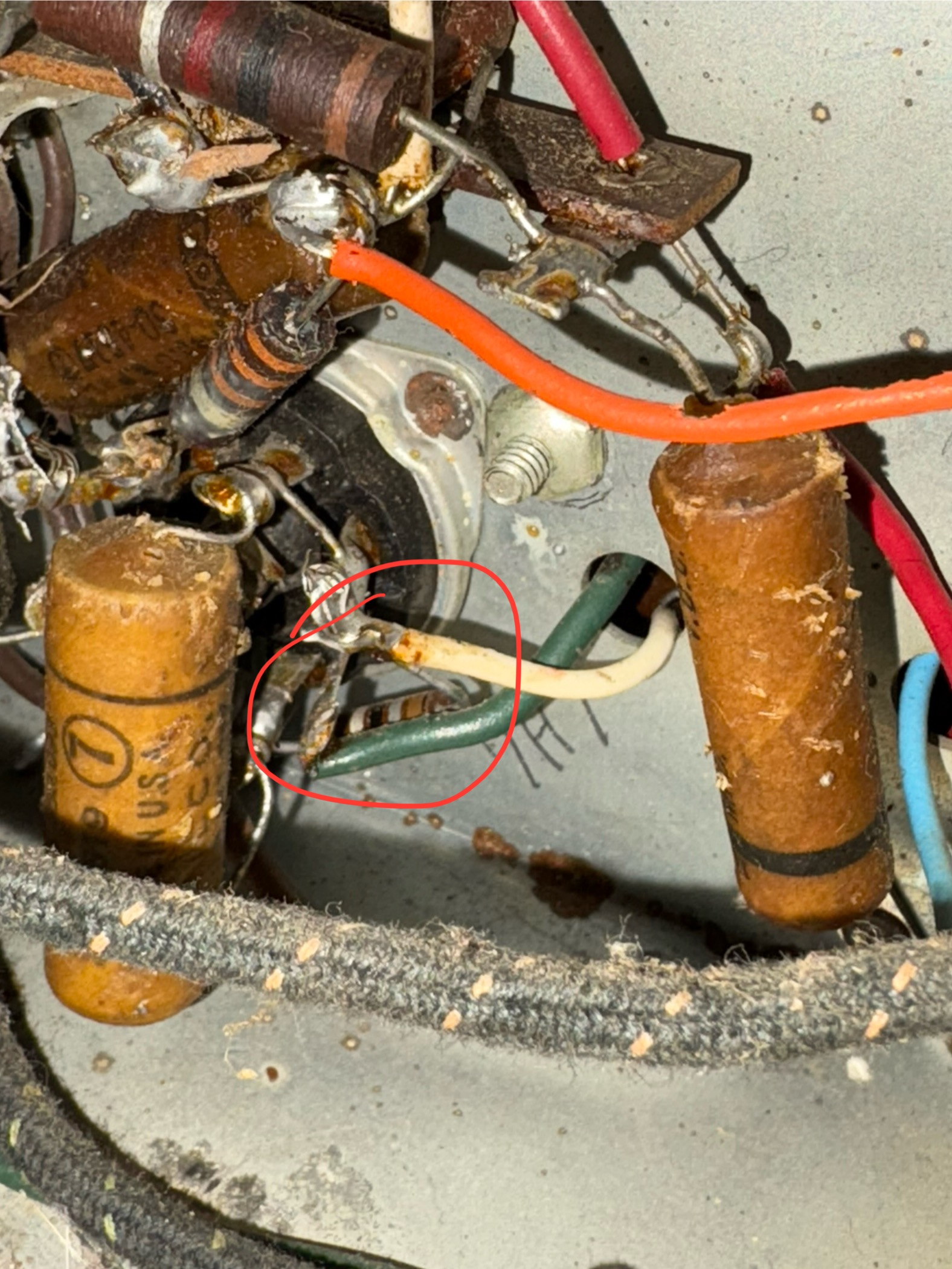

I'm still combing through the chassis, but I just found something which doesn't match the prints. R305 connects to pins 5 and 7 of the second IF 7H7 tube. Every mention of this resistor in the manual indicates that it is a 150 Ω resistor. Even the listed part number would hint that it's a 150 Ω resistor. However, I see a resistor marked brown-grey-black-silver (15 Ω with a tolerance of +/-10%).
Does anyone have a 46-480 who can double check this resistor?

I also settled the question about R300. The schematic indicates that it should be 4.7 kΩ whereas the parts list calls for a 47 kΩ resistor. I can see yellow for the 4. The violet band looks more brown to me, and the third stripe is not visible. I used an ohmmeter, and it measures about 4.9 kΩ. I’m betting that it’s a 4.7kΩ with a 10% tolerance.

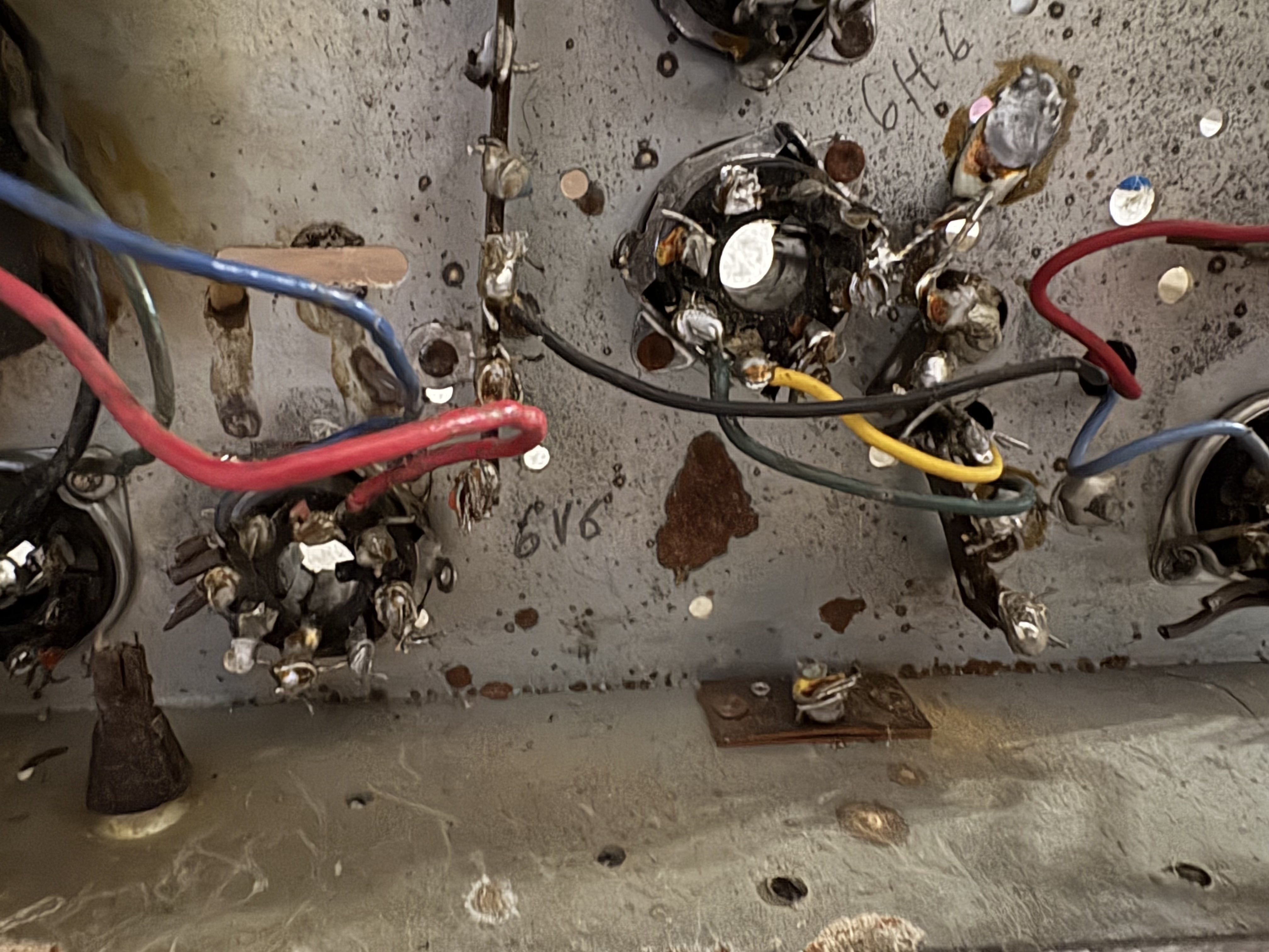

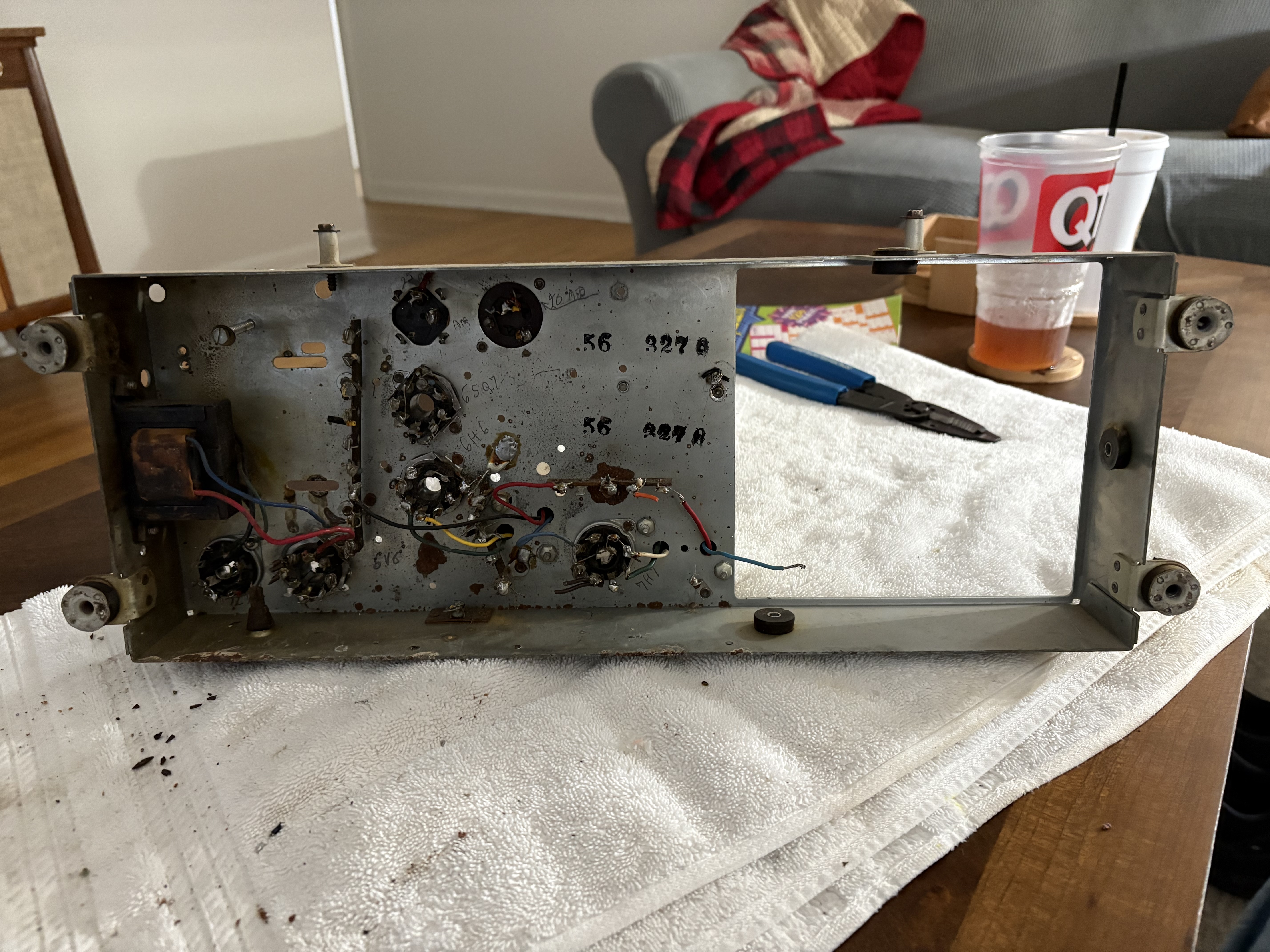

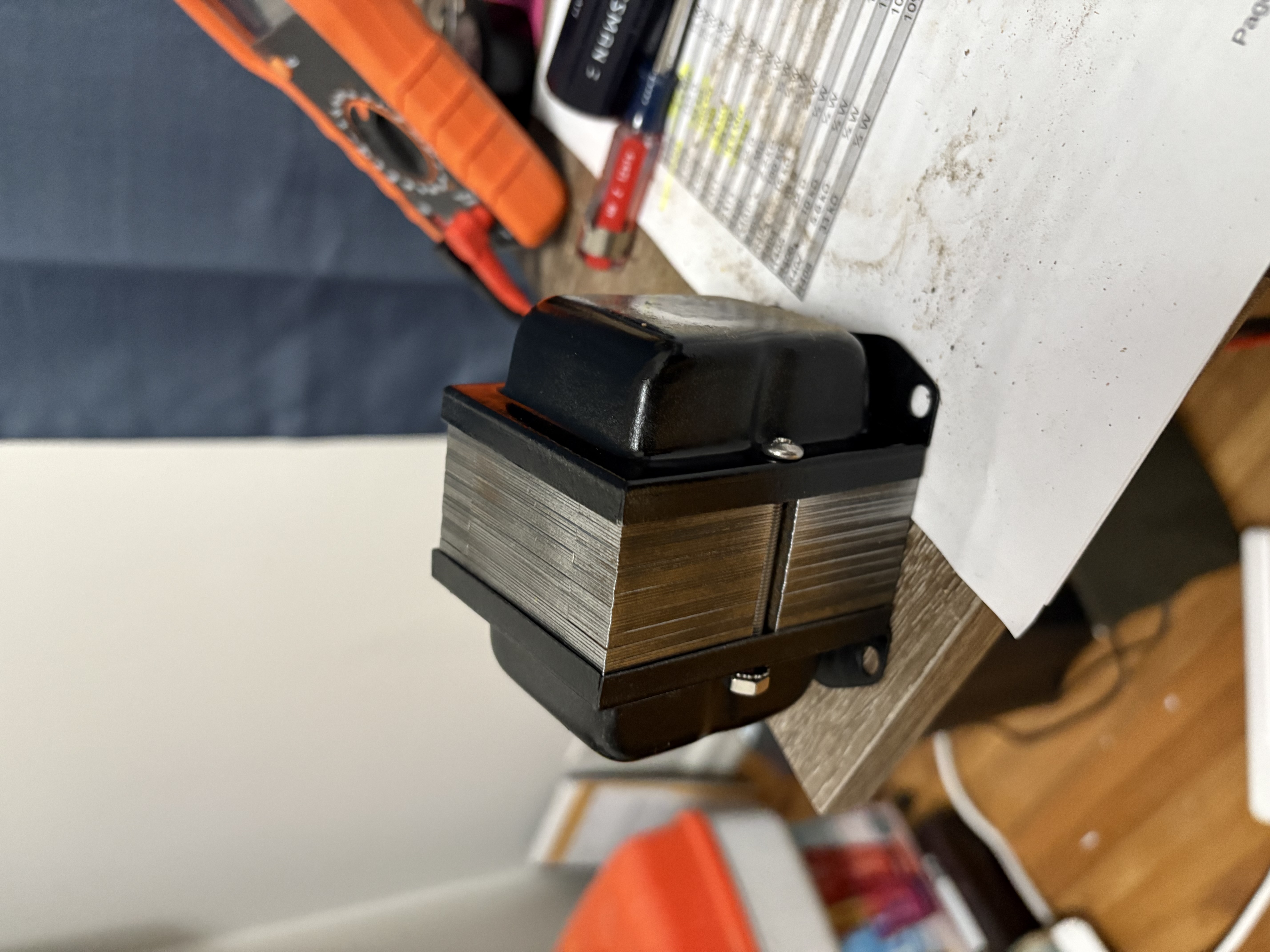

Good afternoon, folks! I've gotten a lot covered since I last provided an update. First, I created a separate post to ask about replacing the power transformer. Per the advice of many others, I was encouraged to salvage the original unit. It worked perfectly after some cleanup, repainting, and sleeving the cables.

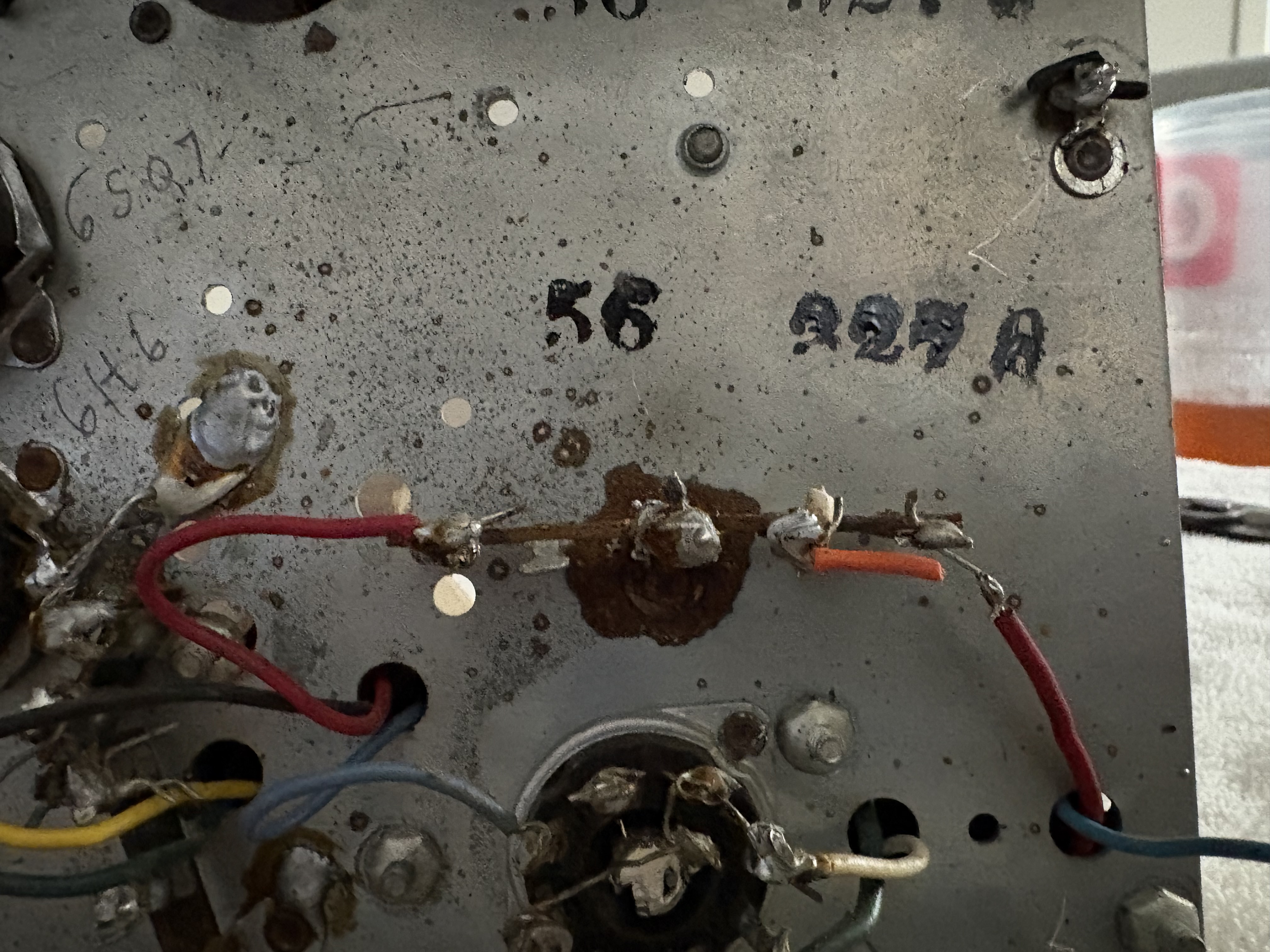

Next, I began combing through the chassis to verify the circuit. I was able to make MANY corrections to my schematic. I had noted in one of the earlier posts that I wasn't able to read some of the pin numbers on the wafer switches for band selection from the Philco schematic, so I have now gotten those corrected. I also corrected a few wire crossings on my schematic--sometimes I couldn't tell from the Philco schematic if two overlapping wires formed a node or not, so I had to give it my best guess. I corrected three of them that I had gotten wrong.
I have an answer to another discrepancy I noted earlier. I showed two screenshots, one from the overall schematic on page 113 of the documentation and another from a Section 4 schematic on page 109 of the documentation. The overall schematic did not depict a grid resistor connecting to pin 8 of the 7F8, whereas the other schematic did. I have confirmed that there is a 10-ohm resistor, per the section 4 schematic. Thus, I have added it into my schematic.
I have also determined the production run of this radio. There were eight listed production runs for the main chassis and nine production runs for the RF chassis in the Philco documentation. This particular chassis has the modifications indicated for production run 8 of the main chassis and production run 9 of the RF chassis, so it was among the last of the 46-480's to ever be manufactured. I've also determined that three capacitors have been replaced at some point or other, but the work was done very cleanly. The guy from whom I bought this radio mentioned that he "inherited" it when his father passed away. He said that his father was a collector of older radios, and he didn't want to throw them all away.

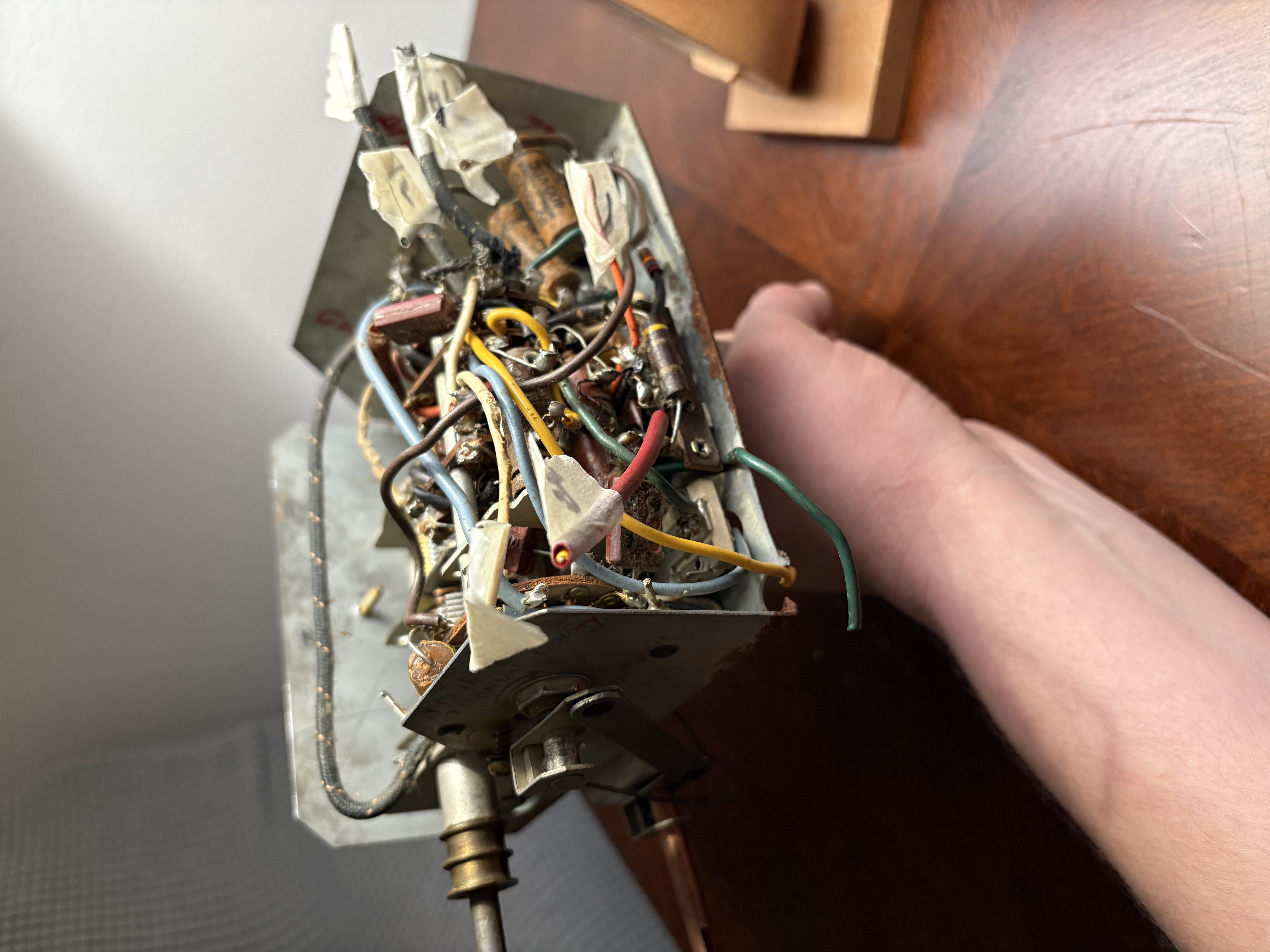

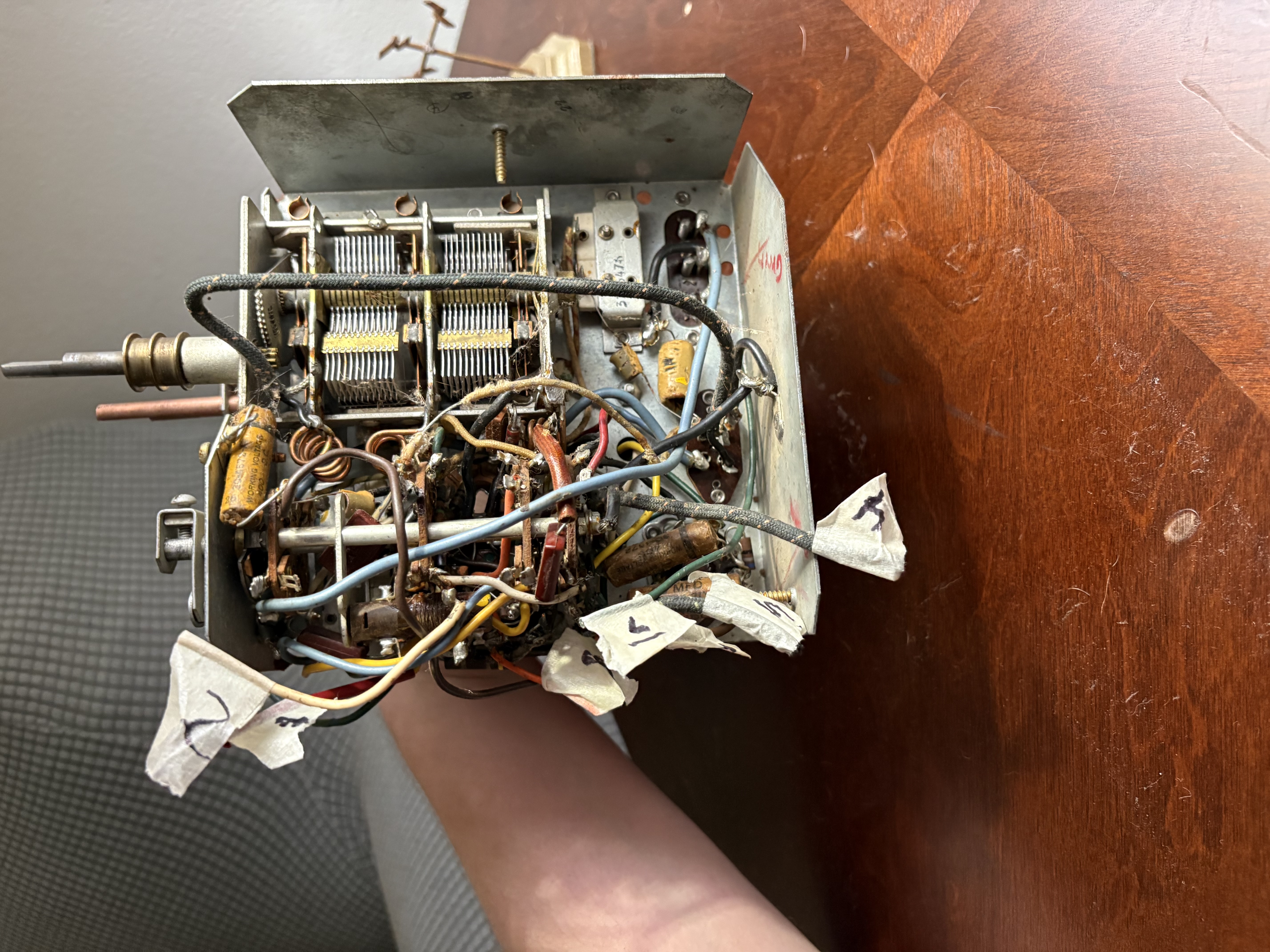

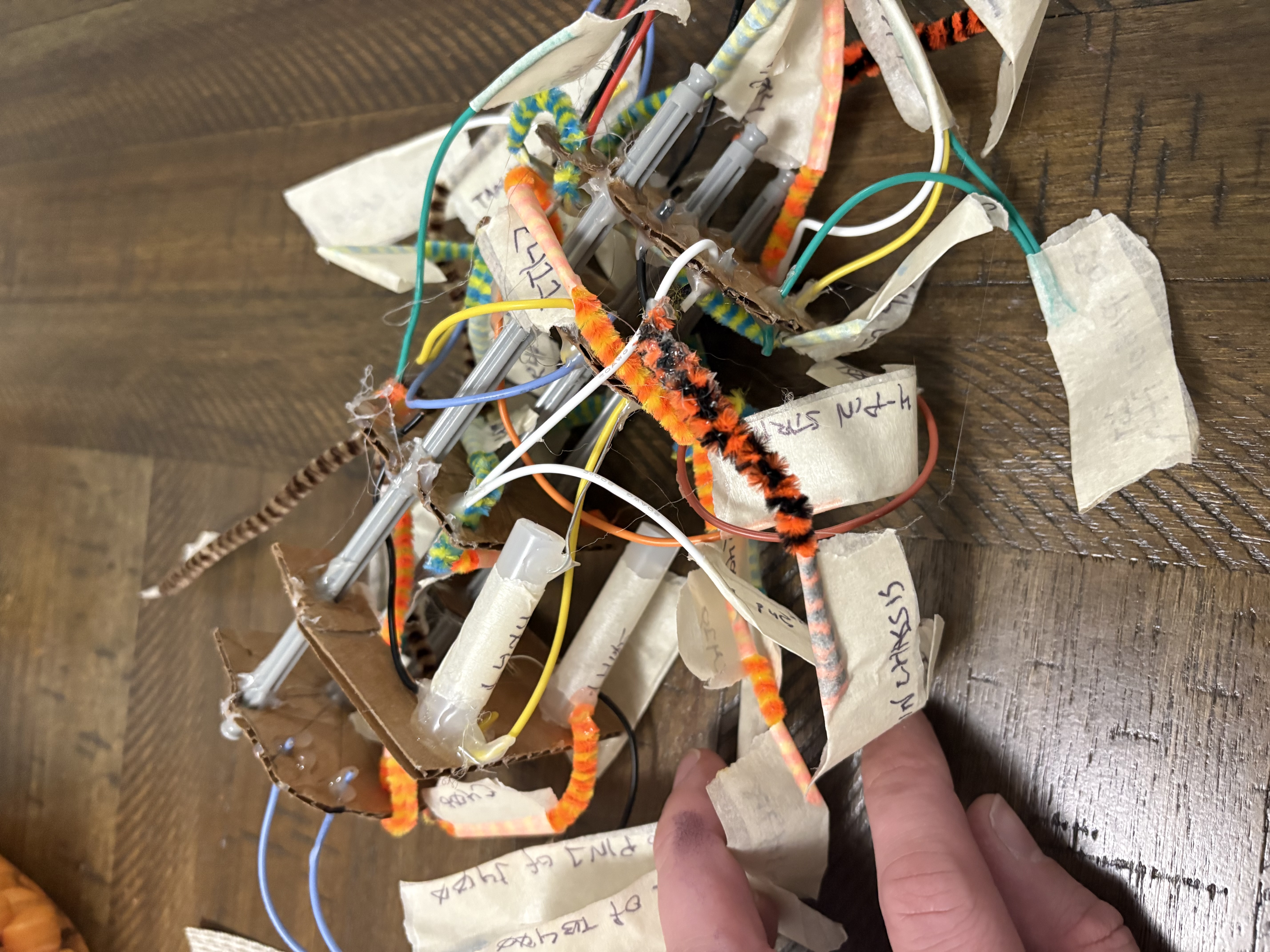

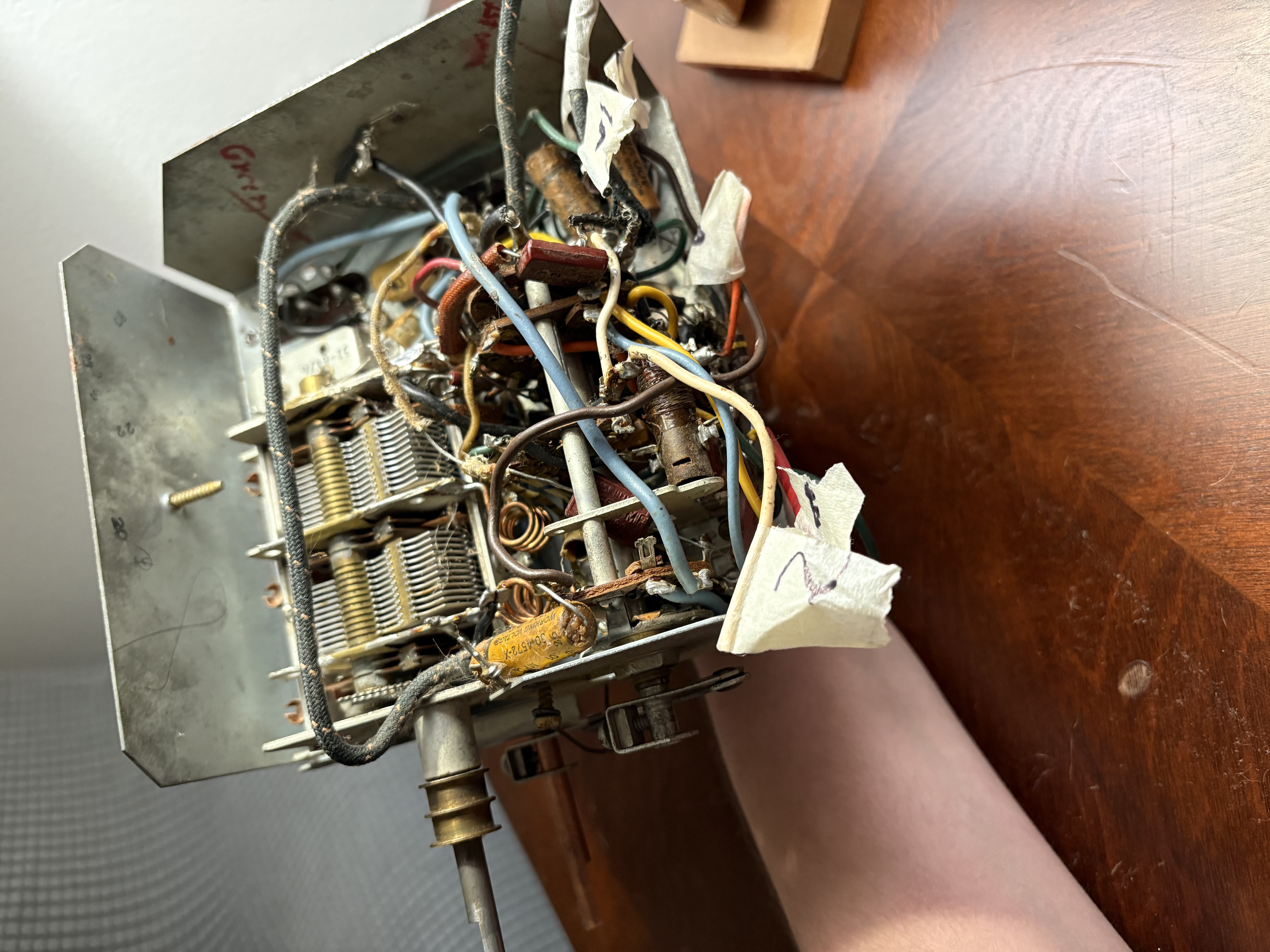

It took me a very long time to make my way through the RF chassis. The reason is that there is a complex assembly of four double-sided wafer switches for the band selection, and most of the components are woven around and in between the wafers. I have no good way to convey this in words, so here are a few photos.
I dread rewiring this portion, because it is VERY densely packed. This assembly is also obstructing the underside of the 7F8 socket and the underside of the C404A/B/C trimmer caps. But I know that I will have to rebuild it, because there is evidence of mice having chewed on a few of the cables which connect to this wafer switch assembly. There's also two paper capacitors embedded into the assembly that I need to replace, and a mica capacitor that I can see with a broken lead.

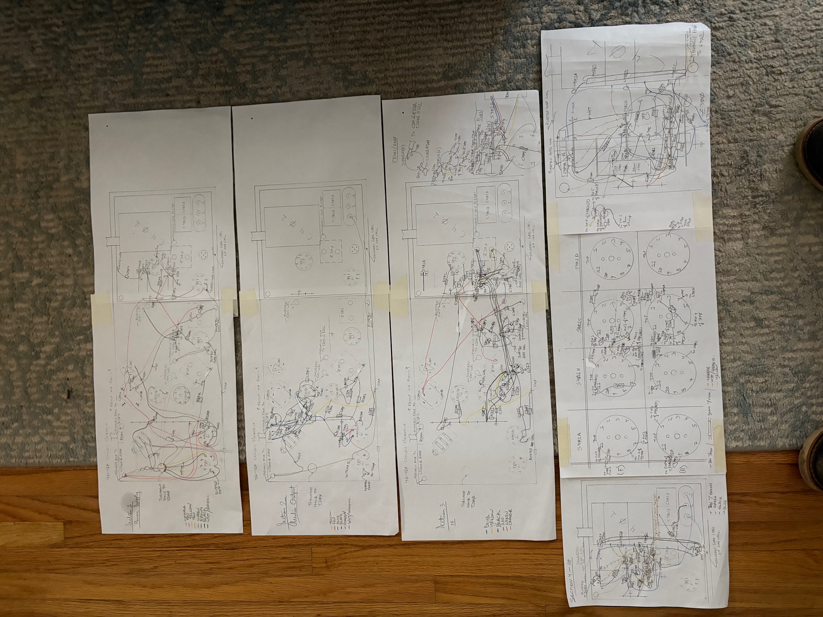

As I made my way through the circuit, I've created drawings to depict the physical wiring. I created four drawings--one for each section of the schematic. I know that I will have to do a fair amount of disassembly to get this chassis cleaned and all of the components repaired/replaced, so I needed to make sure that I exactly how everything is placed.
At this point I have confirmed the values of about half of the resistors and only a few of the capacitors. Many of them I need to get to as I remove them in order to see the color codes. I will update my schematic with corrections to the values if I find any during disassembly. I've attached the schematic as it currently stands, both here as an image and as a PDF attachment.

Fantastic job on the transformer. When working on the RF Subchassis, think of the factory worker who actually assembled it. Sometimes, it is more difficult to take something apart than it is to reassemble it.
You make a great point! I’ve needed to be very delicate in disassembling, so that I can reverse engineer the schematic from the circuit. Surely now that I’ve got the schematic sorted out and the wiring documented, it won’t be so bad to rebuild it.

One other thing to be careful with whilst you are rebuilding the RF section is not to accidently change the shape those large coils made out of the thick wire. You have probably realized this but those are for the FM section, and there is likely a procedure for adjusting them, but I think that they are very fussy and best left alone, unless there is some component you need to replace under them.
Happy Christmas
Happy New Year
Correct, yes. Those are part of the FM section. They control the width of the dial across which you tune. If memory serves correctly, I believe that more spacing between the coils equates to using more of the tuning dial and vice versa.

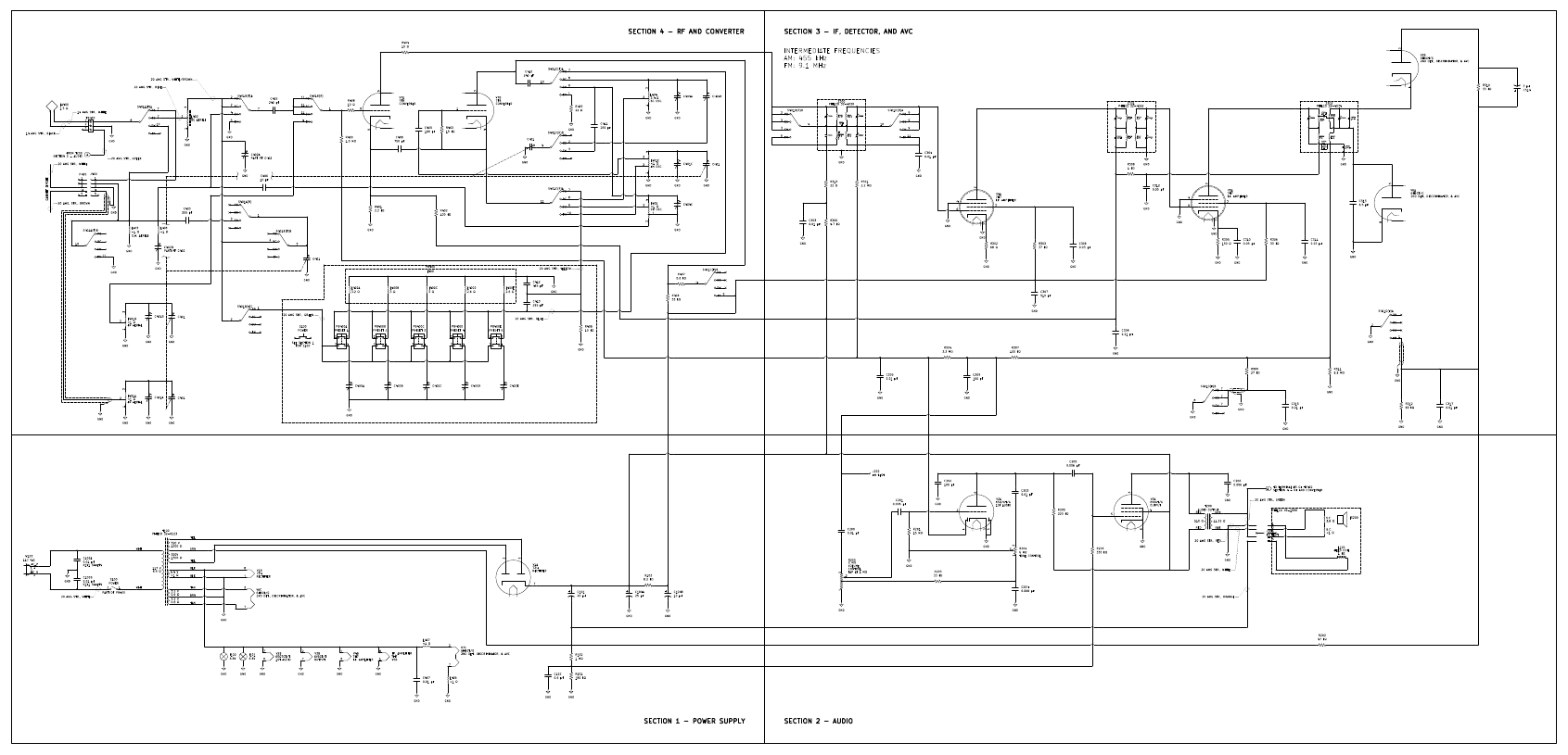

I made a lot of progress on finalizing the schematic today. I have successfully verified the values of all resistors and capacitors in sections 1, 2, and 3 now. I caught a few more deviations from the original Philco schematic:
1. Per the production run notes, C316A was added in production run 5. This is a 240 pF, 500VDC mica capacitor (Philco part #60-10245307). It is to be installed in parallel with C316 "to prevent oscillation in FM operation". Subsequently, production run 8 indicates that C316 was removed but says nothing of C316A. I find it interesting, though, that I found a 240 pF capacitor installed in parallel with C317. I wonder if the writers of the documentation had meant to say that this 240 pF capacitor was supposed to be installed in parallel with C317. Regardless, I will keep it. I've added it to my schematic, in parallel with C317 as I discovered, but have instead called it C317A.
2. Also per the production run notes (run 4), an unnamed 100 pF capacitor was added between the high-potential terminal of the volume potentiometer and the 1 MΩ hard tap "to improve high frequency audio response". This capacitor never appeared in any of the Philco schematics, but I found it in my radio. C207 was the next available name in the 200's, so that's the name I've assigned to it on my schematic. The documentation does indicate that it is Philco part #60-10105407, which is a 100pF, 500VDC mica capacitor. I used my LCR meter to confirm its value. It was within about 6% of that.
3. Contrary to all of the available Philco schematics and parts lists for this radio, I have found that R305 is not a 150 Ω resistor. It is actually an 18 Ω resistor in my radio. Sure enough, the color bands were brown-grey-black. I also confirmed on my ohmmeter (it read 27 ohms, but it does prove that we are an order of magnitude off from the 180 Ω value in the Philco schematic). I got curious, so I also checked the Rider's schematics online. They also indicate that this should be a 150 Ω resistor. I wonder if someone installed the wrong part in this radio. Nonetheless, I have updated my schematic according to my finding.
    I've made all of these corrections to my working copy of the schematic. I also realized that I made a mistake on the value of R303 on my schematic, so I fixed this. It is supposed to be 27  kΩ, but I had typed 37kV. The original Philco schematic had the correct value, so this was my mistake. I fixed that as well. See attached schematic. At this point, all I need to do is to start disassembling the RF chassis to confirm those values.
    On that note, I still felt worried that I didn't have enough documentation to easily reconstruct the wafer switch assembly. After returning to my drawings the next day, I realized that much of the text was too small to easily follow. So, I created a model last night of the wafer switch. I created it to be exactly twice the scale of the actual unit, so that it's easier to look between the wafers. I have every wire colored correctly, and used pipe cleaners with tape labels (orange for capacitors, green for resistors) to model the components. I even have two little glue stick inductors! Icon_lol Now I am certain that I can reconstruct it!

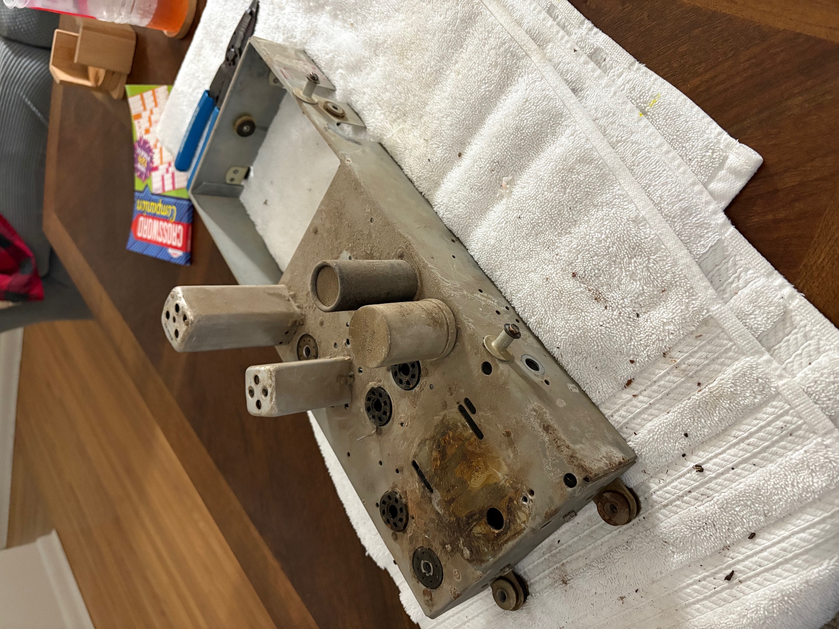

    With that, I am almost ready to clean up the main chassis. I need to desolder the wires connecting to the IF cans and the audio output transformer. Then I can remove those few components. I'll drill out all of the rivets and clean the chassis. I notice that there's some areas of rust on the underside as well. Not to worry; it will get the same treatment of wire brushes, sandpaper, and naval jelly. But take a look at that one terminal strip. The grounded lug is riveted to the chassis, and that whole area is rusted! For certain, all of the connections to the chassis ground will need refreshed.

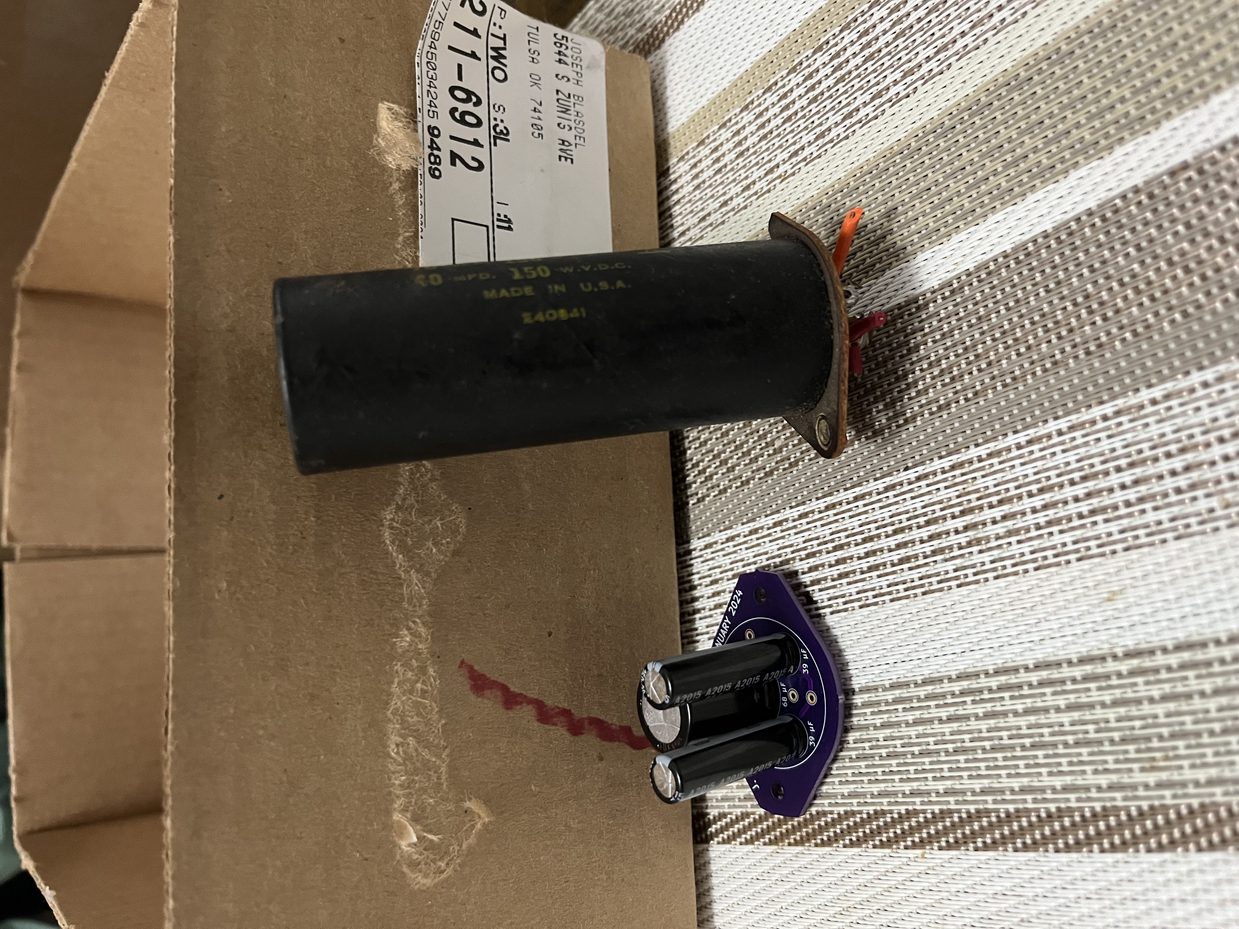

Today I momentarily shifted gears. I've been researching my options for new AC filter capacitors. When I replaced the big multi-section capacitor on my 49-906, I created a PCB onto which I soldered all of the individual electrolytics necessary to comprise an identical multi-section unit. The nice part was that I matched the shape and the through-holes for rivets.
However, the voltage across the capacitors on my 49-906 was a "mere" 115 VDC; for this 46-480, the voltage across the capacitors is 340 VDC. I suddenly realized that the dielectric material of the average PCB may not be rated to withstand these voltages.
Though I am an electrical engineer, I've never commercially designed a PCB. It's always been for personal reasons. So I reached out to OSH Park, who I typically use for producing PCB's. They did indicate that they are able to manufacture a PCB capable of safely handling these voltages. Furthermore, they provided me with some links to tools which will help with trace sizing, temperature increase, etc. I'll have to take my time to dissolve all of this. As usual, I'll share the process and results here.
