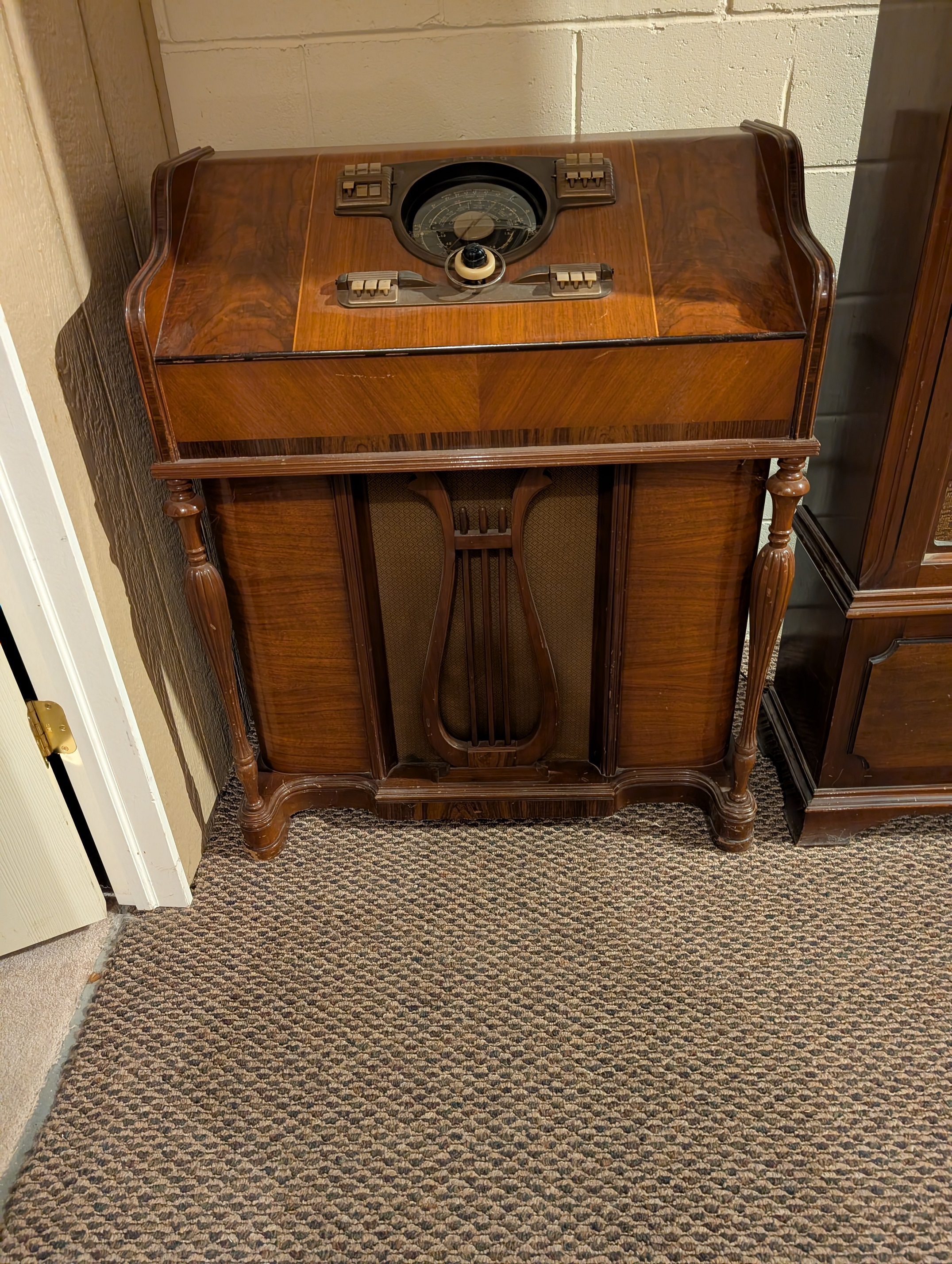

Guess it's time to show off my fully restored Zenith 9s262! This picture is when I picked it up at the restorer's workshop. Just beautiful!
Mark
