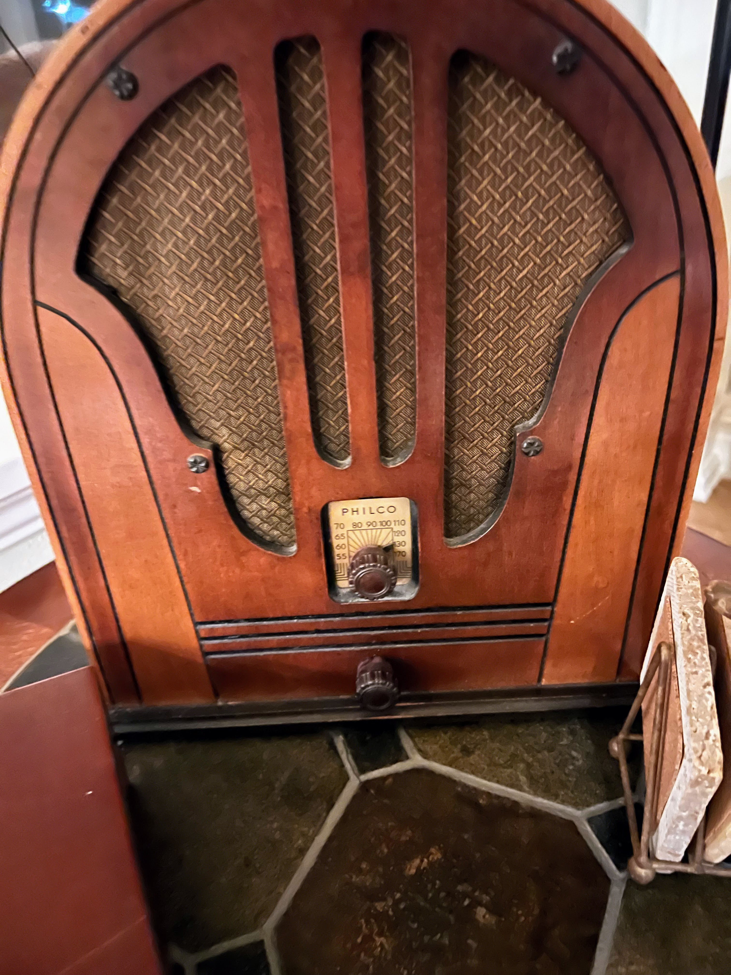

I have a Philco tabletop radio that is slowly losing its volume. It tunes the station in fine, but I typically have to turn the volume all the way up to hear it. We haven't used the radio in a while (many months) and when I turned it on this time, even at full blast volume, it is like a 1 out of 10 in terms of volume.

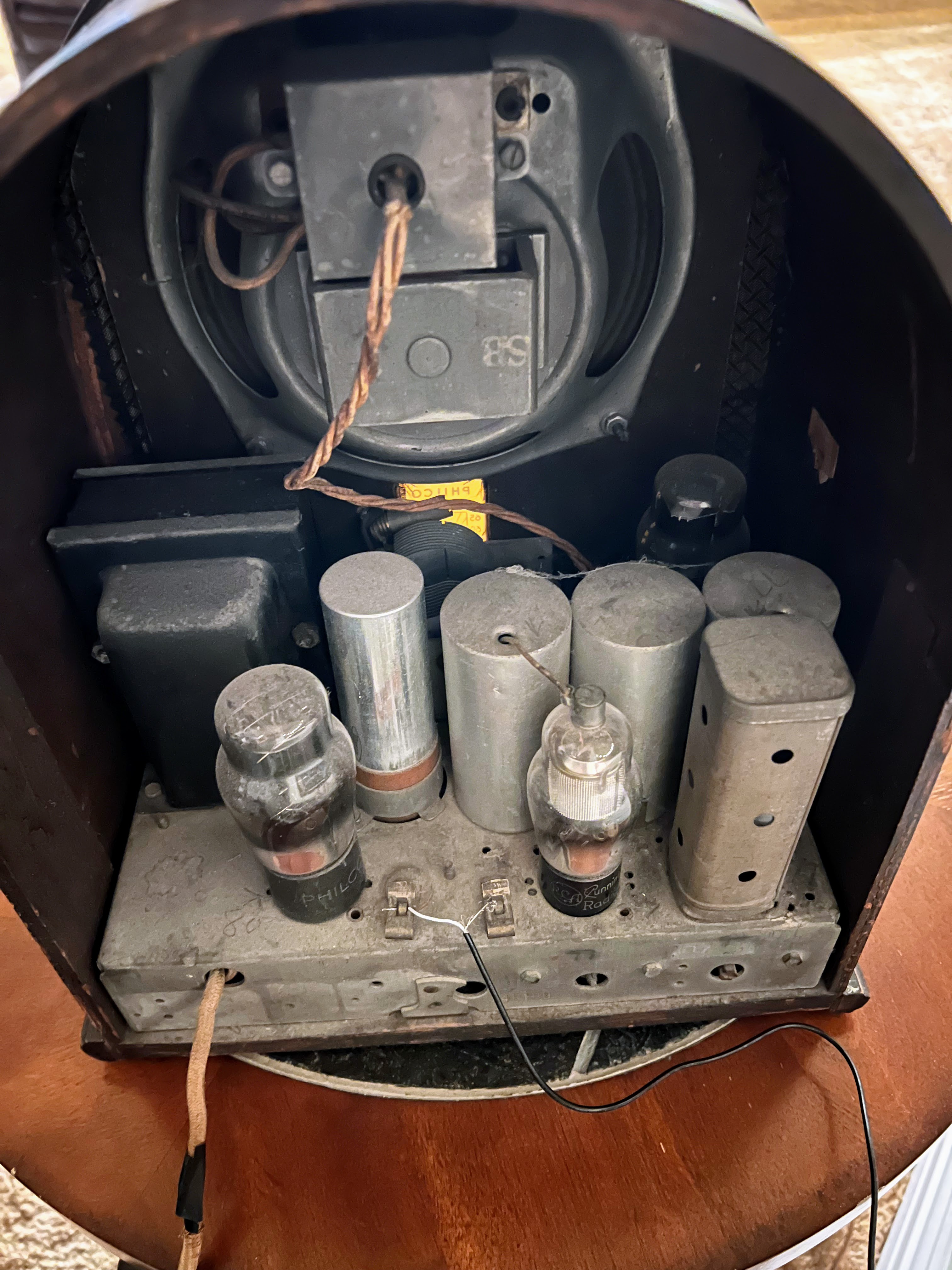

But before I can ask for help, or a schematic, I need to identify the model, which I'm not finding on the outside or inside of the radio. I've attached a couple of pictures (front and back) in hopes that someone can help me identify which model this is. I've gone to the Philco Radio gallery and browsed each of the years, but did not see this particular model.
Thanks in advance.
Dale

Looks like you have the mid-1935 season version of the 84B. (the grill cloth in the photo in the link is not the correct grill cloth)

80 and 84 are regens, and so need to be brought to the state where they work on the virge of osccilalting. There is usually a trimming cap that does that, often in the back. Also, of course, if it has not been aligned, it needs it too.

Your "throttle condensor" (the aforementioned one) is the #17.

Yes. This is the way Philco called this specific trimmer. Look at the text on the left. the first paragraph.
http://www.nostalgiaair.org/PagesByModel...013843.pdf
Welcome to the Phorum, Dale! Has this chassis ever been restored in it's recent past? If not, I would strongly recommend replacing all paper caps and any out-of-tolerance resistors. Do not power it up until this is done. These components are inexpensive in comparison to the parts they can take out if they are left in, powered up, and then fail. Lots of help is here for the asking. Don't worry that your questions may sound ignorant ... we were all beginners at one time or another! Take care and BE HEALTHY! Gary
