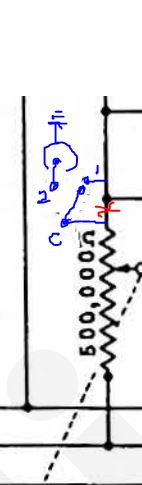

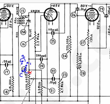

Below is a section of the schematic that I marked up for installing an "Aux Input".  This can be an RCA Jack, a 3.5mm jack or you can wire your Bluetooth receiver output here directly, but a jack is preferable:
Below is a closeup view to show the detail better:
The switch is the easy part.  The red X (yes, poorly drawn.  My art with a pen and paper is bad enough, trying to draw with the eraser type pointing device is worse!) indicates where you break the connection.  There are 2 "ends" to the resistance element in a "pot" (potentiometer).  The side that you are breaking into has a wire (possibly blue) going to the IF output transformer secondary (This is the detector output), one end of a 3.3MegOhm resistor (the input to AVC) and a 250 pF cap (Detector RF Bypass Cap).  Once you break this connection, wire in a SPDT (single pole double throw) switch.  The common of the switch goes to the volume control.  the wires disconnected from the volume control go to one leg of the switch.  The other leg goes to the pin terminal of an RCA Jack or the tip terminal of a 3.5mm phone jack.

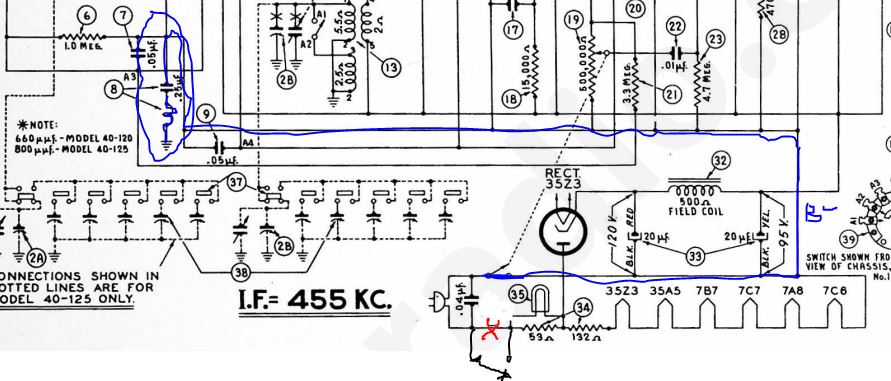

This becomes a large problem when adding an aux jack.  If the return ("Body "of an RCA jack or "shield" if a phone jack) is connected to B- then the body of the MP3 Player, CD Player, etc. becomes hot.  If connected to the chassis, it becomes "warm" and hum may occur.  In the above diagram, I show the body of the RCA Jack going to "ground".  This is the safer way to do this but the safest way of doing so is to make the following modification.  Refer to the diagram below:
The blue line indicates the "B- and heater (filament) return" circuit.  The first part of the mod is to disconnect all connections from the power switch and connect these wires directly to each other.  The second step is to put the switch in the "Hot" side of power (the wire that goes to the pilot light and 53 Ohm resistor.  The third step is to add a polarized plug with the wider pin going to the Neutral and the narrower ping going to hot.  If the connections are made in this manner, then the return of the jack can be connected to B- instead of the chassis but care must still be taken, I would only do this if the jack is only to be used for the Bluetooth.

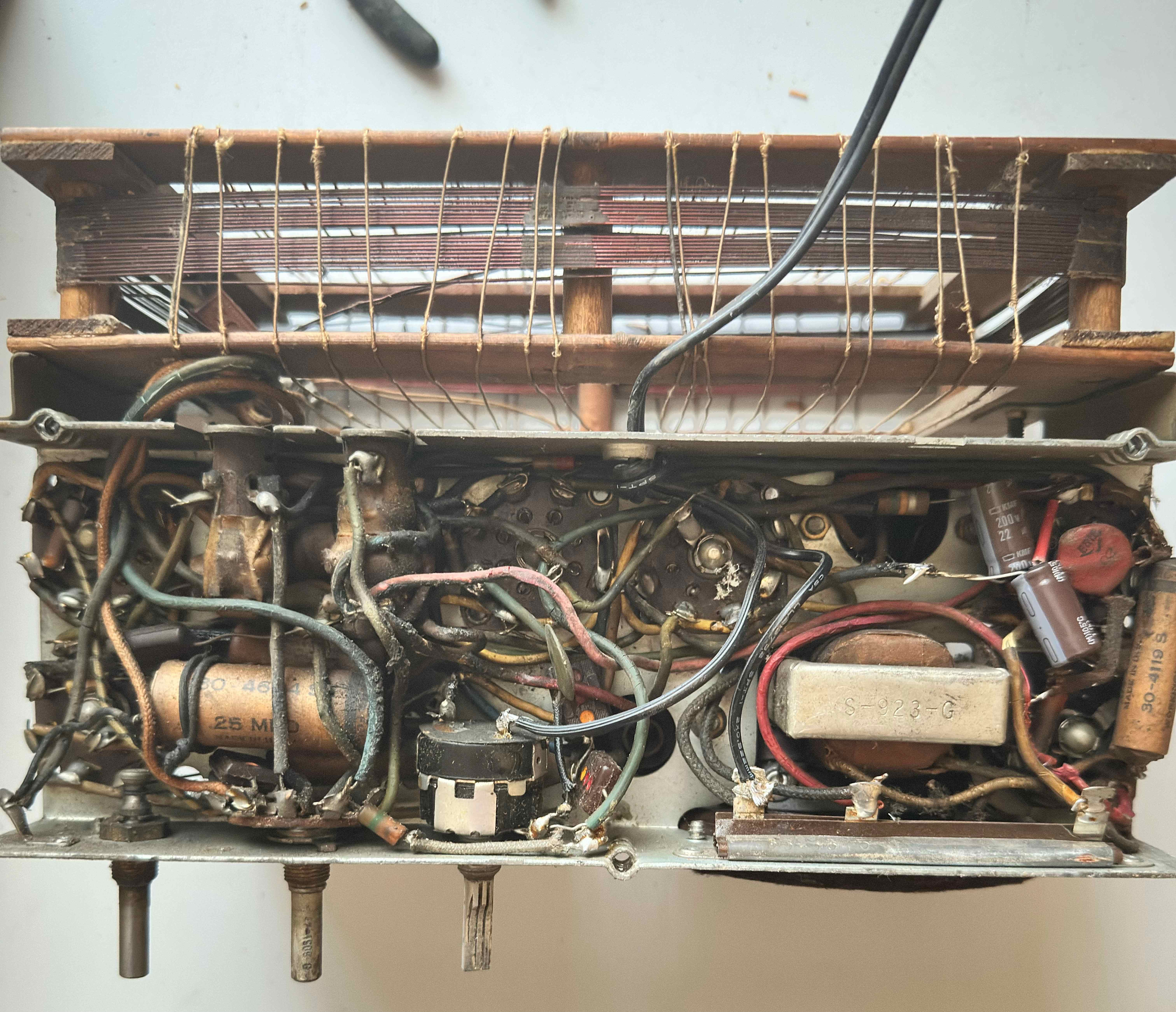

Now, as for the radio you've purchased: since we haven't seen it, it would help if you showed some photos, especially of the underside of the chassis, the whole picture as well as the specific regions of it you care to discuss. This way we could at least guess as to what has been done to the radio.

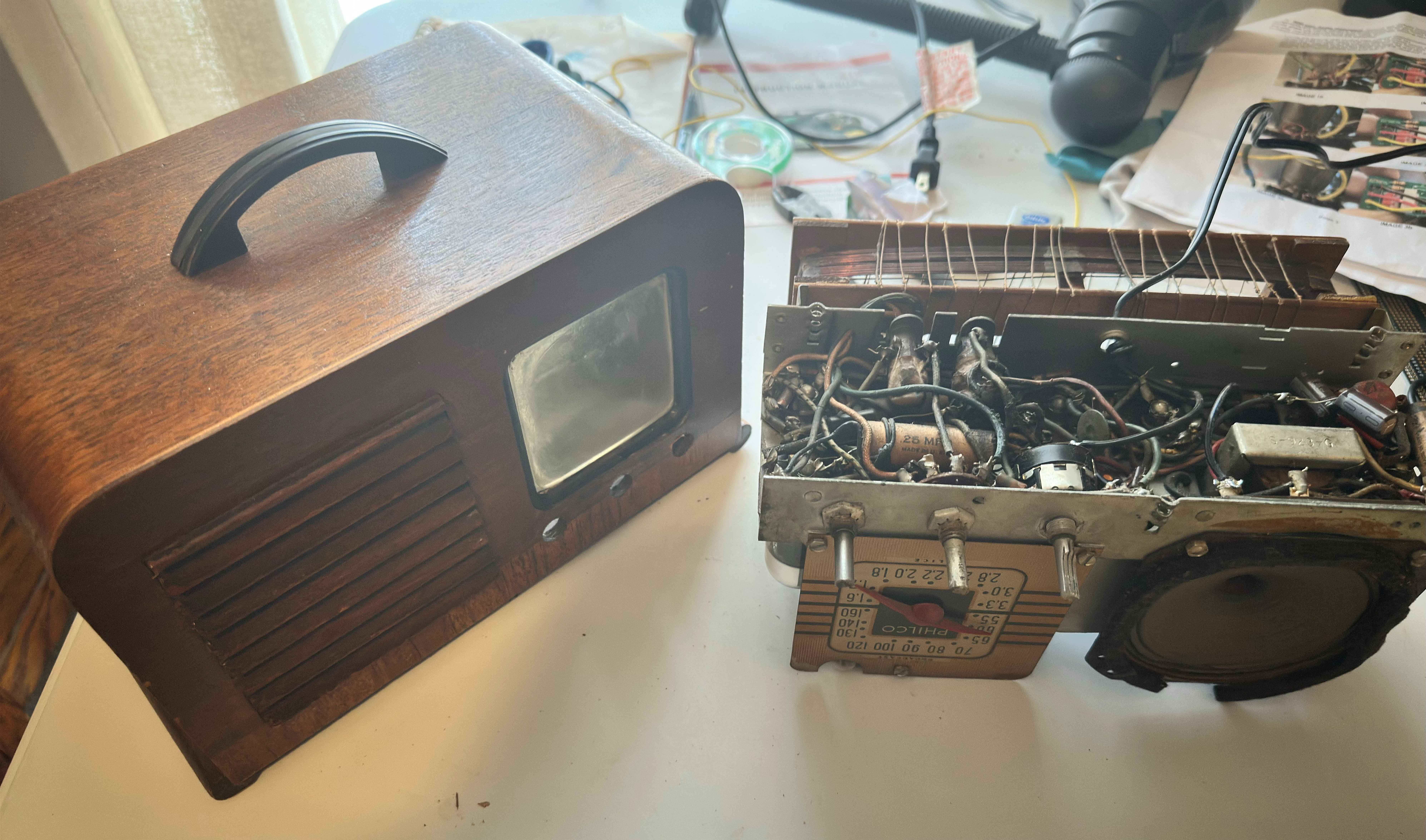

Here are a couple photos of the Philco 40-120. I had the link to the bluetooth module correct, I wasn't sure so I re pasted it in and for some reason the link didn't work, sorry.
From what I can see, the paper caps (I see five) have NOT been replaced.
One is the big 0.25uF tubular on the left, the other is market 30-4119 is on the right, then something that could be another one is under the first cap, right above it, and another one right above this one, between the two coils, and the 5th one is right below the big 0.25uF.
There should be 7 per the sch: 0.25uF (C8, with the wire wrapped about it), C4, C7 and C17 are 0.05uF; C22 and C26 is 0.01uF (after the volume pot) and C29 is 0.04uF.
It is possible that 0.01uF caps are disc ceramic and have been replaced. Not sure.
From the looks of them, they have not been touched/restuffed.
What has been changed is the electrolytic caps, you can see the two on the right, 22uF 200V.
I would change the paper caps.
