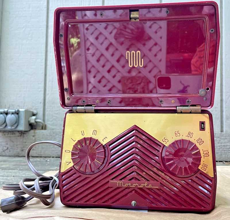

I just bought on e-bay very similare radio - "Motorola 5M2U", just from 1950, not 1948 as here.
Pice - $10 ![]() ![]() If you want to work, lie down and sleep, and everything will pass.
