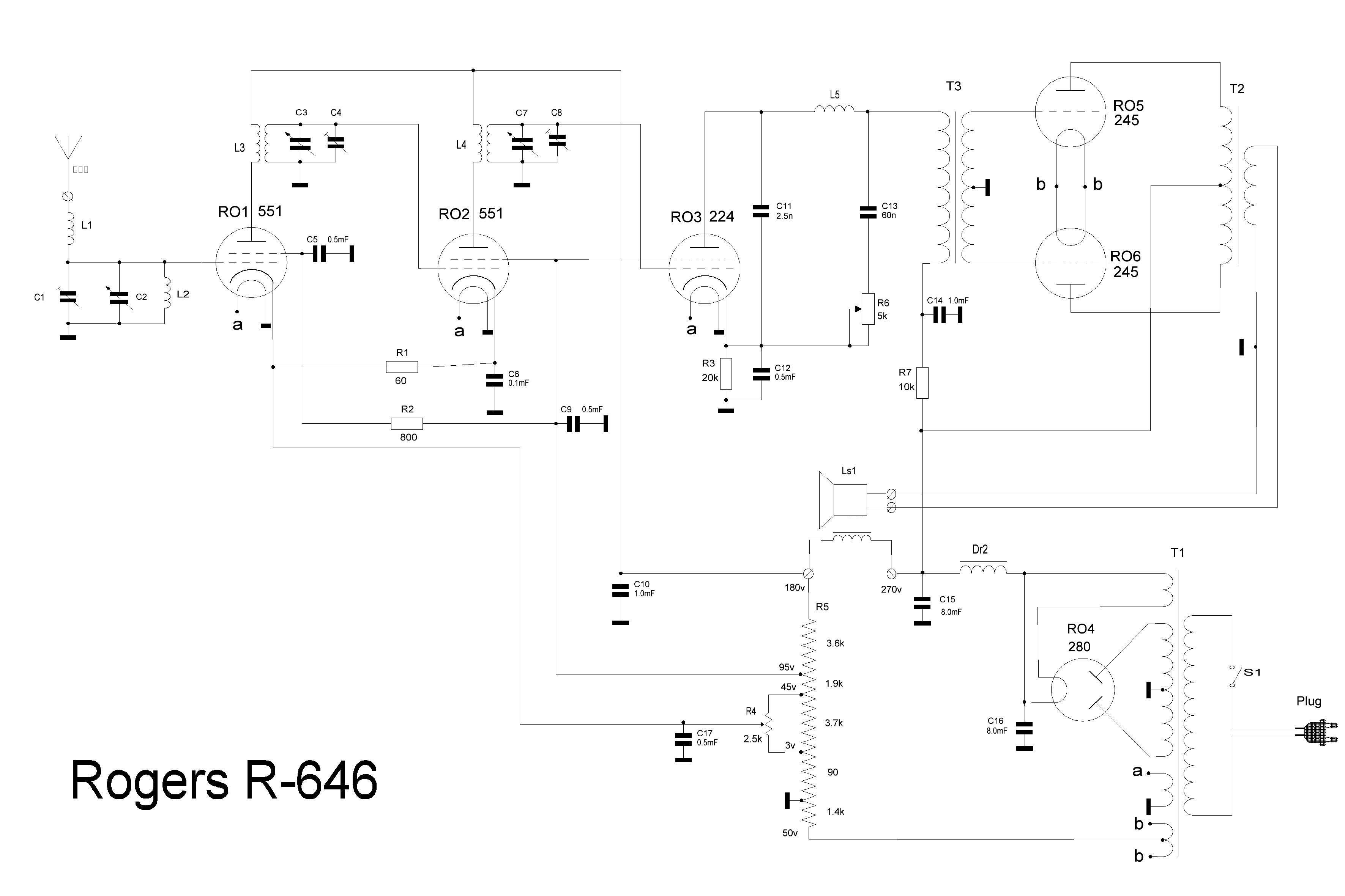

Since the original schematic was in an old unreadable style, I created a new schematic diagram.
Owners of this radio can use it.
The original schematic is also attached for reference.
The diagram have been updated based on the latest data from current work with my chassis.

You can bypass the interstage transformer by disconnecting the primary, connect a load resistor of about 10k - 20k to the 24 plate, connect a coupling cap to the 24 plate to 45 grid. The transformer secondary takes care of the phase inversion. I've done this in a couple 1930s sets. Works great, and you can wait till a replacement transformer shows up. This is documented elsewhere on this site by Ron Ramirez.
Thanks RodB for the help.
But this is not a real solution to this situation, not even a temporary one. Because the first output stage will only work in single-ended mode, not in push-pull. But the output voltage setting of the tube is in "B" mode, and you need to change the grid voltage setting to switch to "A" mode. Otherwise, the audio output will be heavily distorted and very low power. And only one of the two tubes will work. In other words, it will cause more problems than it's worth.
But in any case, the output transformer is also dead and needs to be rewound or replaced. So I still can't revive the radio this way, even temporarily.
If you want to work, lie down and sleep, and everything will pass.
The output 45s are still in push-pull because the transformer secondary winding is still in the grid circuit providing opposite signal polarity.
No, you are wrong, because you did not know the details.
Unfortunately, only ONE winding out of six is intact in both transformers - the secondary in the output transformer, (which is not surprising).
All other windings are open.
And no such solution is possible without replacing the transformers. But if they are to be replaced anyway, then they must be replaced completely.
