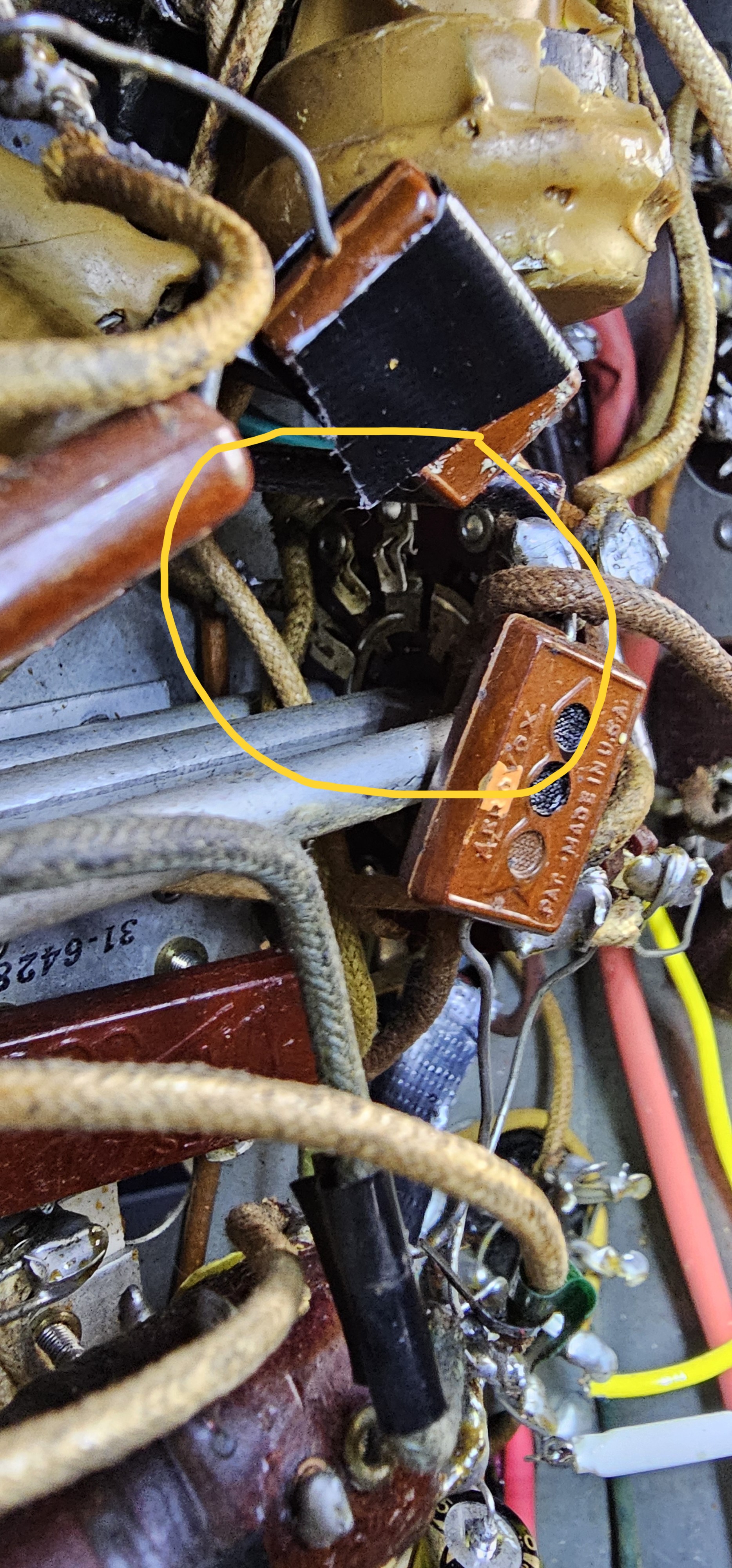

I have tried the DeoxIT D5 on the band switch and even though it has relieved the tension I felt when turning the knob, I still wasn't able to receive any broadcast. As for testing the Oscillator using another radio, I don't have another old radio but tried with one that I had which received AM stations and didn't notice any change in the signal while tuning the Philco.
Figuring out the Oscillators on the parts listing is confusing, looking at the chassis and schematics it looks like #14 (Broadcast and SW) also 15A-B. Which would be the main Oscillator I need to check?
I am now checking the wiring and contacts in the Oscillator area to see if anything may have shorted. The backside of the switch/contacts (where it protrudes through the chassis) seemed to be the worst before using the DeoxIT.

Please tell me this was it, I replaced resistor 27 and it's playing on the broadcast band. I am afraid to change the band  but I probably should try the others.
It reminded me of having a tooth pulled, it was really tight between the 2 terminals.

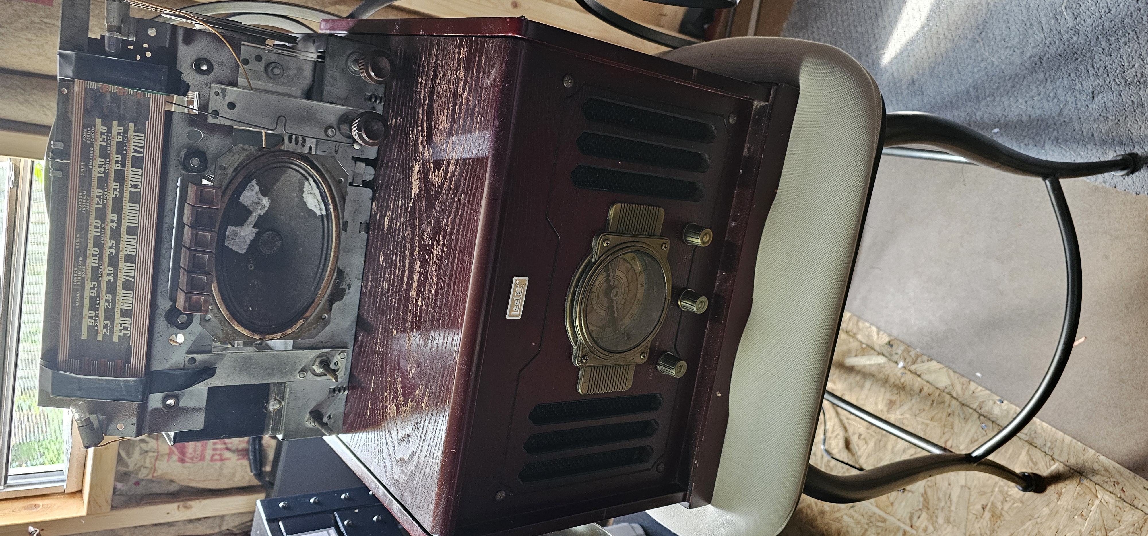

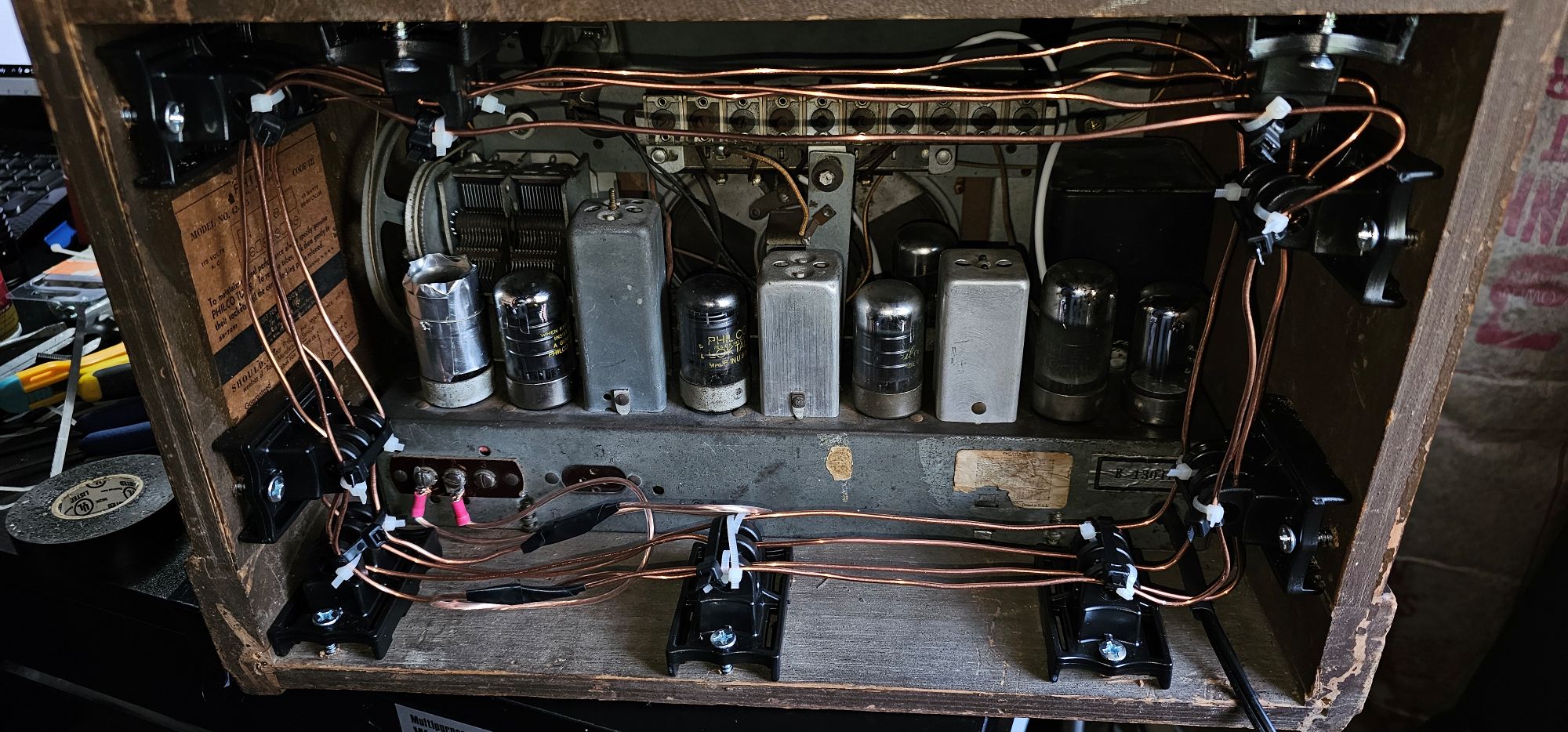

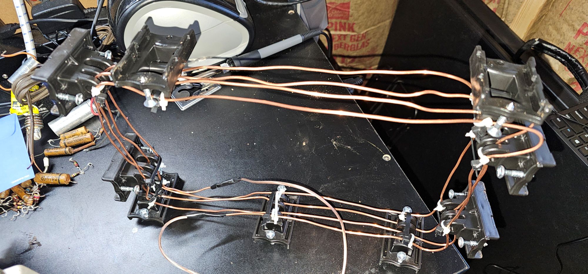

We'll guys this radio played yesterday and until this evening, I even had the owner stop by to see all I replaced before inserting the chassis back into the case and it played good during that time. So, I put it together and built myself a loop Antenna which to my surprise worked very well. Unfortunately, there must still be an issue with the band switch, and I know I've switched it earlier, but I believe only while the radio was off and had no problem after turning the radio on. I took a chance while it was playing and switched the band and that was it. Again, I cannot get it to pick up any broadcast, so the chassis is out of the case. I have sprayed more DexIT and closed shop for the evening and start out fresh tomorrow.
Here are a couple of pictures of what I thought was finished.
I like how my home-made Antenna just slid out of the case.
(This post was last modified: 06-18-2025, 09:13 PM by osanders0311.)
