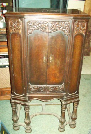

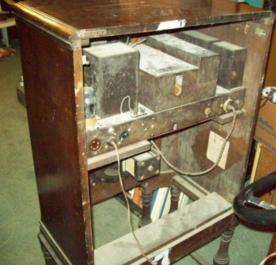

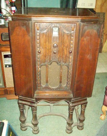

Well, I have been dropping hints about this radio the past week here, now time to show what I got! I really am wanting to get this set going fully and possibly plunk it in my bedroom down at the house to listen to at night.

Nice looking set! Too bad it's not a superhet. It's a trf with avc,a lot like a Philco 95. Even has a S meter. Took a look at the diagram doesn't look like it's much fun to work on.

Yeah, RCA was still hogging the superhet circuit at that time yet and it would be another year or so before everyone else would get to use it. Still, a good TRF with AVC can perform quite well. As far as working on the set, some work has been done already. I am hoping the noise issue is more a case of needing aligned and neutralized than any major work.

Cool set Jayce, I like the old sets with an S meter. I have a Gulbransen console that also has one, but your S.C. is more interesting and probably a better performer..

Very ornate looking set. Sure has that mid-1930's Philco six-legged cabinet look going on.
Keep us posted on restoration with lots of photos.

Mighty fine set, Jay! I have seen only a few of the early Strombergs like yours. The one I heard play was a super sounding set, from South Carolina where the radio was located it clearly recieved WSB in Atlanta, GA.
A very ornate, attractive console. Congratulations!
