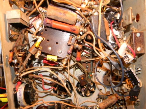

Thanks, Jerry. If you look at the picture thumbnail I have attached, there are two coils. The one on the right is the oscillator, and if you look closely, you can see a little dogbone resistor in it. Of course, perhaps they were misplaced. Thanks again. I will refer to the alternate forum.
Well first off you need to be SURE that you wired the coil back in correctly!!! That's why I said to mark the connections so they can be replaced back onto the coil CORRECTLY. They are connected in a certain order for reason if you just hook them up in any order it probably won't work. Once that is straightened out we can measure the resistance of the windings to find any open windings.

Wires to oscillator are on right posts. Took before and after picture.
