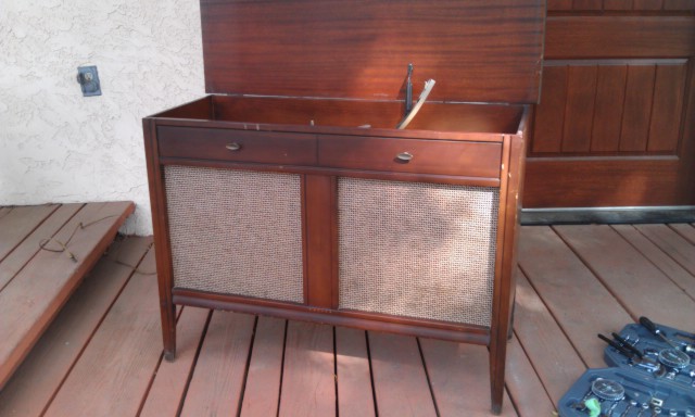

I just purchased a Philco Stereophonic Hi Fidelity console. These units are pretty cool. I can see how it would be easy to get hooked on them  The wiring diagram is still glued to the floor of the cabinet (under all the duest and dirt...almost didn't see it) and identifes the model as L1561, but I can't find this model number listed anywhere on the internet. Can anyone help me identify this unit?

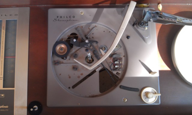

Also, the AM/FM radio works, but not the turntable. I know nothing about turntables and haven't listened to an LP for decades  Are these belt operated, because I do not see one anywhere? I have a few pics...

That turntable uses a rubber idler wheel to transfer motion from the motor shaft to the turntable platter. The wheel with the rubber "tire" at the rim is the idler. Check and see if the rubber surface is not hardened and glazed, which would make it slip. Also check if the motor shaft turns freely. This is the small shaft under the idler in the photo. Sometimes the oil in the motor bearings gums up and prevents it from turning.

The idler wheel is not turning. The motor shaft is turning fine, but the wheel is extremely hard and will not turn on the motor shaft.

If your motor is turning (when the power is on to the turntable) you should be in good shape. If not check to see if it is plugged in (the motor not the set it self) If it is then try to spin the motor shaft by hand. If it feels like it wants to work but doesn't you'll need to clean and lub the motor bearing with a little bit of light oil like 30wt mtr oil. The other two things that come to mind are the idler wheel (that rubber wheel) You can clean it with a little rubbing alcohol and then rough it up a bit with some sandpaper just a little to clean off the glaze on it. Add a drop of oil to it's shaft. Attached to the bracket that the idler wheel is on there is a spring it controls the tension that the wheel has on the plater. Make sure it has some tension so the wheel is pressing on the inside rim of the plater.
One other thing that usually is bad is the phono cartridge You can test it by setting up the set for phono operation and then gently rubbing the needle. If good will make a scratching noise in the speakers.

Thanks, Terry. Good info. I'll try working on the idler wheel. The motor shaft is turning just fine. It is making contact with the idler wheel, but not turning. I do not have a needle cartridge and why I am looking for the model number for a replacement. Do you know if I can use any Philco cartridge or will it need to be specific?

Can't say that I do. It may not matter much as long as it is stereo and had enough output to drive the amp. The other issue is the mounting. But I don't think that it will be a big issue once you get the other stuff going.
