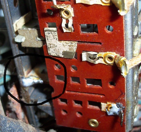

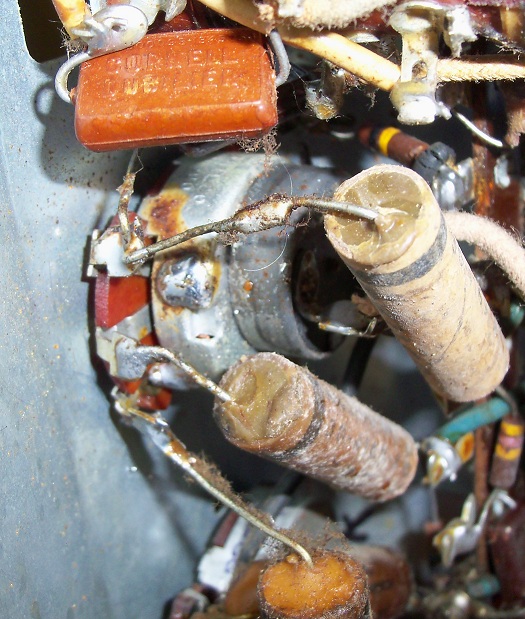

First, it appears that the first pushbutton on the left was originally supposed to be to turn the set on, is that correct? Someone soldered the button lever tight so it cannot be used, and on my set, the first knob on the left is for tone, and the second knob from the left is off/on/volume. I'm thinking this should just have been a volume only pot. Here's a pic of the soldered lever:
And here's a pic of the off/on/volume switch:

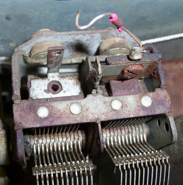

Lastly, I touched the center pin of the volume control with a screwdriver and got loud volume, so I know that part is good, but I can only get the local station faintly at full volume, even with the antenna connected. There is a wire on top of the variable capacitor that wasn't connected to anything:

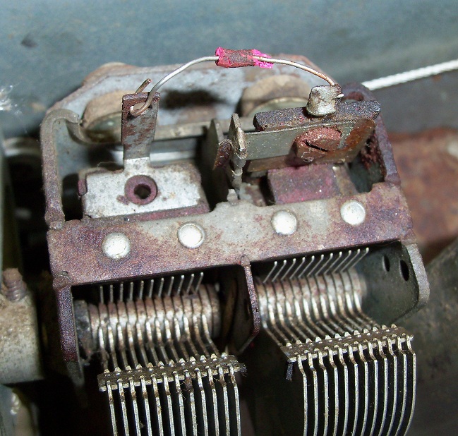

I wasn't getting any sound without it connected. When I connected it to the lug opposite it on top of the variable capacitor, I got the station faintly:
But I think there must be something missing there that I'm not finding on the schematic. Just a plain wire (with that great dried rubber insulation flaking off) can't be all that was connected between there? Should there be a capacitor up there?

1. Yes, the first button on the left originally activate the off-on switch, which was originally mounted on back of the pushbutton assembly, directly behind that first button actuator. The volume control did not have an off-on switch originally.

3. That wire with just a tiny bit of red rubber insulation remaining is, or I should say was, the "gimmick" capacitor. It should be placed through the lug as you did, but it should not be making metal-to-metal contact; the insulation should prevent the wire from actually touching the lug.
Place a bit of heat shrink tubing over that wire and then put it through the lug again - the radio may come to life once you do that.

I did remove the rest of the crumbling red coating and put a piece of heat shrink around that "gimmick" capacitor, all the way to the exposed end of the wire, and put it back in the lug as shown in the picture above. No metal is touching on the lug now, just the now insulated wire. It didn't really make too much difference, but when I touched the lug that was already soldered tight (see photo above), I got lots of volume. I think the real test will be when I hook up the 3 antenna wires in the cabinet to see how that affects volume and sensitivity. Just waiting for the cabinet to cure after applying a wood treatment to it before I do.

If you don't have the cabinet antenna connected, this would definitely be the reason for not having any strong signals. The end of that wire that is soldered to the lug is the antenna section of the tuner, this is why when you touch it, you get a signal. The garble in the audio could well be due to the antenna not being connected. This is because when there is no return path on the antenna input, it creates a very high impedence input, which can pick up hum from the environment. This gets sent down the chain and you hear it in the speaker. Once the antenna is properly connected, and there is a return path (usually through the AGC circuit), this hum will not be there because the input then becomes a lower impedence.
