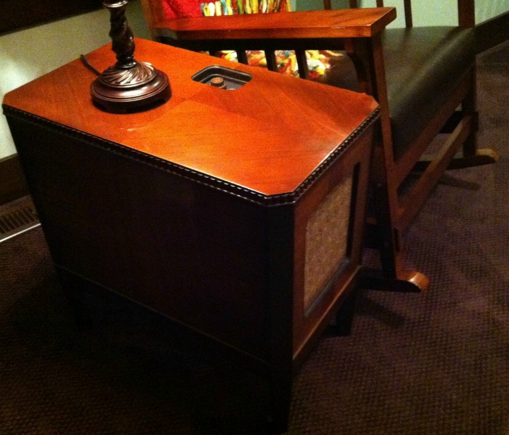

Finished my first radio. Its a 370 Chairside that I picked up for $35 earlier in the year. Went through the chassis replaced all the paper caps and electrolytics along with one mica and all but one resistor. Couldn't figure out why I couldn't get any stations until I discovered that a previous repair at some point in it's life rendered it inoperable. Cathode of the oscillator was not wired back to the B.C. Resistor.
Very nice !!! I wish either one of mine looked that good!!
That looks very nice and it's right at home next to the rockin' chair. How well does it perform?

Beautiful radio, and awesome job on the restoration!
Thanks for the comments. The radio performs very well. I am building an AM transmitter (Antique Radio Forms 12AV6-12CS6 Transmitter) so I can play some some decent music along with Tube Talk podcasts.
I'll mention one slight thing I noticed about my working 370. The speaker is mounted close to the power transformer. This seems to cause a bit of 60cy hum pickup from the magnetic field. I moved the speaker away from the radio chassis and it clears up.

Tis is exactly the case where grounding does squat.
Extra heavy soft iron shield around the transformer would help.
