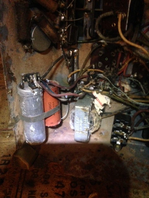

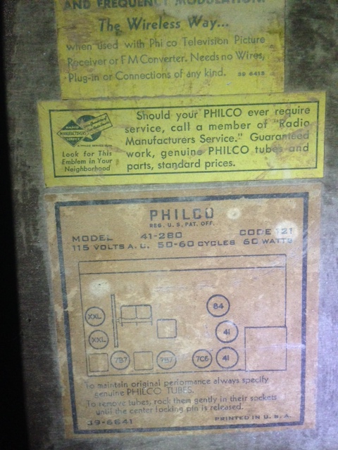

I am new to the forum and in search of some knowledge about these older radios. I found my great grandfathers Philco in my grandmothers basement. She said it hasn't worked since she was a little girl, with that being said. I have not tried plugging it up. I have noticed quite a lot of parts missing or in the case of wires there was a rats nest under the actual component part. I believe its a Philco Model: 41-280

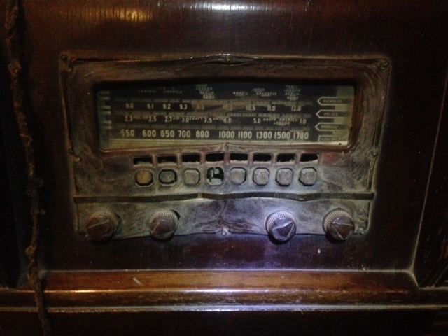

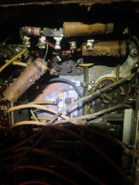

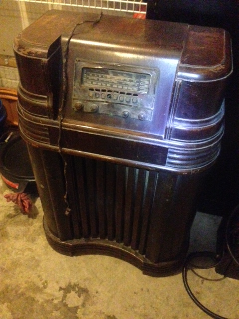

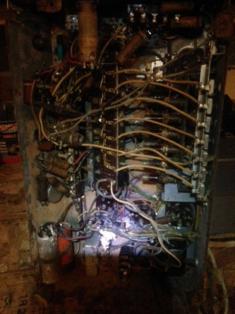

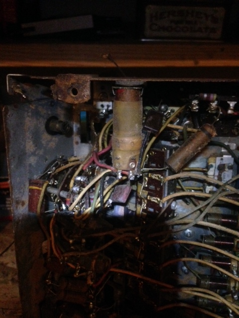

From the pictures, yours looks like it's in pretty rough shape.
Whatever you do, DONT plug it in until someone goes completely through the circuit and replaces all the capacitors (soldered in), checks all the resistors (some will probably be bad also), the transformer, the tubes, etc...
Radios in this shape will always need lots of work.

3. All of the electrolytic and wax caps should be replaced, resistors checked and replaced if 10 - 20% off value. Check coils and transformers/chokes according to values on the schematic.

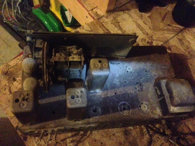

I echo that Herb said. Don't plug it in until it has been checked out and the caps replaced. Your chassis is pretty rusty but it can be restored. You can buy navel jelly at any Lowes or Home Depot and use it to remove the rust, be careful not to get any on the coils.

Sorry to rain on it but whatever makes this tick, is not at all a good beginner's project. To be thoroughly honest, this one is not a good project period. I would never pay anything for this nor would I take it for free, except maybe the chassis for parts provided there are any good parts in a chassis that's been through what this one has. It looks pretty darn bad. So does the cabinet. I do not have it in me to take on a radio like this one.
Of course if you really feel like doing this one, go for it, we will help you as much as possible.....
I hope you got it for next to nothing, or someone paid you to remove it. Icon_smile

You can find a schematic here: http://www.nostalgiaair.org/Resources/414/M0013414.htm and http://www.nostalgiaair.org/PagesByModel...013415.pdf . Another place with perhaps clearer copy here: http://www.audiophool.com/Philco.html

Thank yall very much, and Morzh this thing being rough is a understatement. If you could have seen what had built a nice home under the chassis when I took it out.

Got to agree with Mike, that is NOT a good beginner's project unless you have a pretty good electronic background. A heavily corroded chassis usually has a number of problems that are weird, tough to isolate, and tough to correct.

The chassis is going to be a lot of work. I would *start* by blowing it off with compressed air. I'm hoping that is mainly dirt and not corrosion... Your going to have to learn how to solder as you'll be replacing parts and some wiring...

about that compressed air....Trigg mentioned something making a living abode under the chassis and I surmise this something is of the rodentia order.....those vermins are know to carry some pretty deadly viruses such as hantavirus in their feces that, when airborn, sometimes, well, kill people. So, Trigg, as a minimum when blowing that thing:
1. Do it outside.
2. Wear a mask.
3. Discard the mask once done.
