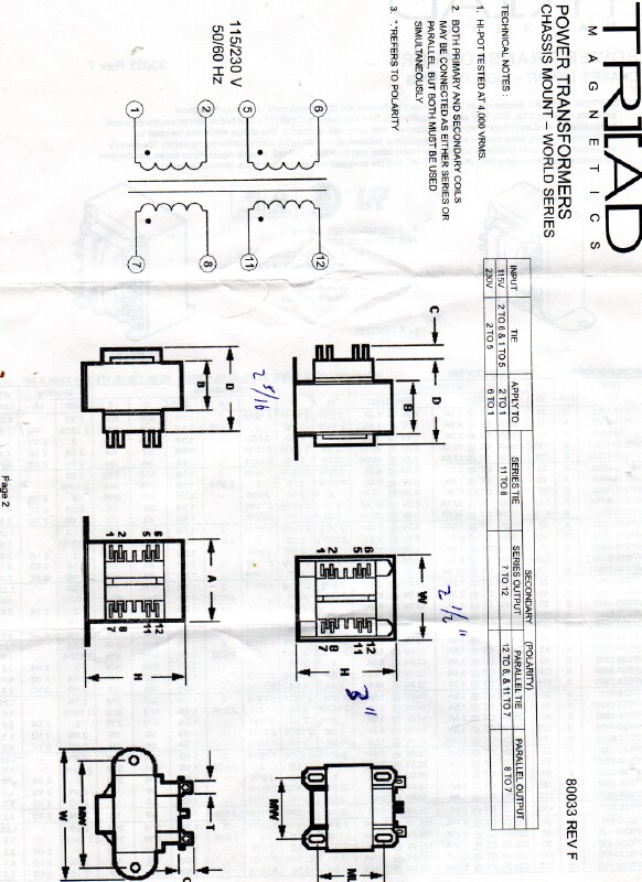

I have several 80VA 1:1 isolation transformers on hand. Not all that large, a bit bigger than a large output transformer. I'll get dimensions off of one, and if it could work for you, I'll be happy to send you one.

Morzh,
Here are dimensions and input/output connections for these little isolation transformers.
Thanks Brenda, I will try to measure the space later today.
