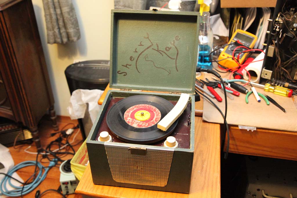

OK, I eventually took over that thing as even when Tim and I called each other on Skype it proved to be too much to do remotely.
It came in the mail today and in two hrs after that (well, about 1hr work) it sang just fine.
Then there were additional problem the last of which I just fixed.
Most problems initially occured due to the PCB being phenolic paper (FR2) and the traces on those do not adhere to the board well. So when a heavy part is soldered and then subjected to vibration the solder joint will unglue and then the trace will eventually snap and the solder joint will be separate from the trace.
So, in the order of having been discovered:
1. A black wire (-3V) came off. But that could be a result of troubleshooting.
2. A trasnsformer pin's solder joint got separated from the trace.
3. A large resistor 's pin did the same.
4. -3V pin (the one with the wire broken) did the same.
5. The electrolytic cap's minus pin did the same (could be the result of troubleshooting).
All was fixed by ceaning the soldermask off the traces and then flooding it with solder to join with the pin.
I also soldered over a couple of suspicious places.
6. Most wires coming to the board were on the verge of breaking off, so I cut them off, stripped and re-soldered.
7. So was one of the battery holder contacts, same thing done.
Others:
8. The speed pot did not regulate speed, it would be either maximum or none. Upon closer look the pot was exactly that - either close (in the max speed position) or fully open. Surprisingly, the opposite pin (unused to that point) behaved fine and smoothly regulated the resistance fro 0 to 100 Ohm as it should. This made me suspect the other pin separate from the resistive element.
I simply resoldered the wire to the unused pin, and now it regulates speed fine, only in the opposite direction from what"s written, "slow" is not fast and "fast" is slow.
9. The volume pot was scratchy, opened it, cleaned the element, put some deoxit in and a dab of deoxit plus lithium grease. Works fine now.
10. After I thought I was done a couple of times the motor barely moved and the amp buzzed unhappily. I suspected the power switch. I took off the disk, and it was very dirty and when pressed in a bit the symptom disappeared. Cleaned it with alcohol, then applied Deoxit; works fine now.
11. The last one, once in a while the volume disapeared, the amp only playing a little at the maximum volume. Looked at it, saw the quick connect tht goes to the adapter move a lot. First thought the whole pin moves but then realized that luckily it was just a quick connect - when touched, the symptom appeared or disapeared; so I took it off, compressed it a bit, pushed it on again. Plays fine now.
So if no other surprises show up, it is ready to ship back.

#50
Today saw something under the tonearm.....a bare wire from the crystal.
Someone added the push-ons in the past by soldering wires with pushon with the wires going to the amp and put some black tape over.
Well, I put an extra piece of black tape to keep teh bare piece from touching the tonearm (no damage but will cut the signal), plus compressed push-ons a it more.
Those should be different connectors, those made from very thin flexible berillium bronze plated with something, like the ones I have on my turntable...this is a makeshift.
But I got a bit scared to involve myself deeper with it, as it is so flimsy, and the old Russian adage says "do not disturb crap, it won't smell" and this is where I decided to limit myself. Schematics are one thing, fine wires and mechanics is another.
If handled properly this thing will work for years more.....
PS. Anyone has experience in shipping these? I mean, should I put some cushoning material between the lid and the turntable and so on? Thios got just fine to me without ANY cushoning whatsoever, but I want to thread on the side of caution.
And the PCB itself might develop new cracks so this is incentive enough for me to cushion it well afer all the wprk put in remedying the cracks in copper.
#51
The last last thing....
The cartridge is NOT 66-1 or any ceramic 66xx (66-TY, looks the same as 66-1). Starting from the fact it is not aluminum but white plastic and the shape is totally different and the pins are arranged vertically one over another, not horizontally.
I guess this is also the reason they changed the wire clamps.
I have an itch to fix this but so far it's been a freeby and with this a cartridge is anywhere from 96 bucks at Turntableneedles.com to 35 bucks for two in this auction
http://www.ebay.com/itm/2-NOS-ASTATIC-66...5afabb96df
but ine is oxidized and the condithion, even if it is NOS, is unknown.
PS. Just thought of it....I have plenty of receptacle connectors contacts that crimp on the #28-30 wires and are in fact the same material and thickness (berillium copper and are even gold-plated) as the turntable head connectors that go onto the cartridge pins. Some might fit the pins of the adapter cartridge. If this works I will 1) try to fit the contacts 2) try to yank the wires, crimp the contacts on, 3) hopefully throw away that mess of push-ons that create problems, plus eliminate thet soldering mess and black tape. That would be a final touch on otherwise fully working TPA-1, short of buying a new needle or cartridge (which I leave to Tim to do as this might get a bit expensive).
