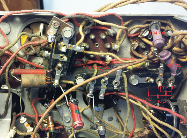

This is the best photo I have on hand right now. To be honest, this was the most confusing part of the recap. I tried to label the parts, and I pray I didn't make a mistake. I have my detailed notes at home, and I will double check later.
Make sure the right bakelite capacitor bank is restuffed correctly. The physical layout seems backwards compared to the layout on the schematic.
I find it helpful to make an enlarged copy of the schematics and trace everything out with colored pencils. As a verify each connection, I highlight it. That gives me some confidence that I have things wired correctly.

Roger/Steve, well I had wired the bakelite cap 8035-D wrong and the illustration showed me the correct way. Now I have volume control but it only plays the putt-putt of motorboating. I had the tuning capacitor at 460 hz and found I could "tune" the motorboating on the back 2nd I.F. to higher frequencies and faster or no sound. I still cannot inject a audio signal but I put the alligator clip on my am test radio and the tone is loud and clear. I have Joseph Carr's Old Time Radios and I see there are several possibilities. At least I have sound and something resembling a "known" problem. I think that's progress thanks to you. Thanks, Rich

If you still can't inject audio, you still have some issues on the audio section. Take a close look at the tone control. The 0.01 uF should always bypass to ground, and the 0.015 uF is a switchable bypass to ground. If the wiring is off, you may be grounding out your audio signal here.
