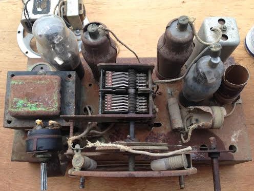

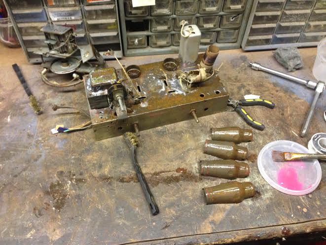

I am pulling apart the 45 chassis and have a few questions.

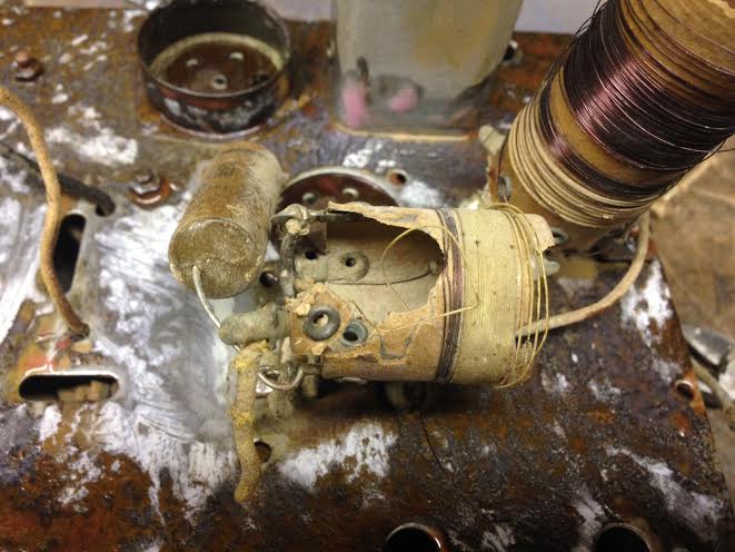

The coils are chewed beyond repair so I will need new ones. I think the vertical one can be saved and just rewound.
1. Do they make special ones? it has 4 prongs coming off of it so can I just buy a 4 prong tube?
2. Can I make a new tube and add the prongs?
Everything else can be repaired except this so I want to have the parts needed for the restoration.

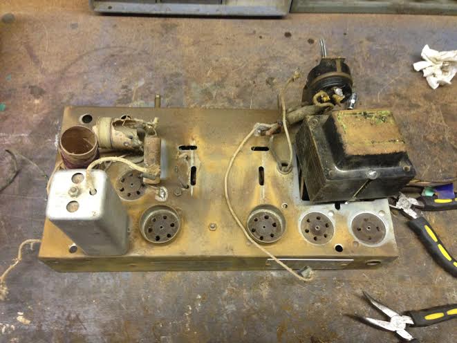

I took off what I needed to to get the chassis clean and am going to recap today.

Yes. You can make new bobbins and put rivets / prongs or simply poke holes and wrap the wire a turn or two to keep it from unraveling.

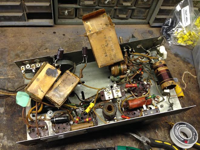

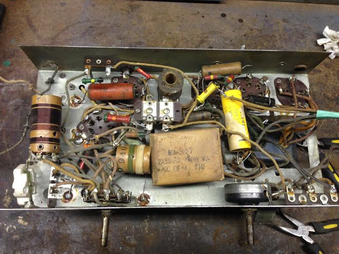

Now on to the Ecaps, The box is 2 x 5 mfd so I replaced those with 2 4.7 mfd Ecaps. the large Ecap that was tacked in is 20 Mfd. This was just tacked in to make up for the other 2 I suppose so I just removed it.
Am I wrong?
The last question is that there was a .0005 cap and I replaced it with a .001 cap.
Is this considered ok?
Got the chassis cleaned and recapped but no resistors have been checked or replaced.

When saying "this cap replaced with that cap - is it OK", you always have to say where the cap is. There are some places where it can be just about antything, and there are some where you watch your single pFs.

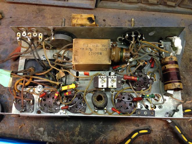

Here is a pic of the .0005. it is grounded and goes to the brown piece with the screw.
The vertical mounted coil on top of the chassis may be repairable, or could at least be rewound if you can figure out how many turns of what gauge wire to use, but there is usually more to it then that. The second horizontally mounted coil is pretty much at the EOL stage, it's been chewed to death by rats and must be replaced. The form will have to be made out of some tubing of the same dimensions, new terminals can be riveted onto the tube.

Like Arran mentioned, I think you or Mike's Icon_e_wink biggest challenge will be recreating that coil.

I have to get new tuning grommets and thought I could make the new cardboard piece from a toilet paper roll? It is 1 1/2" long and 1" diameter so I would just copy it. Think thats to use?

The vap you are showing reads 152 which is usually 1.5nF.
So you had 500pF cap, you wanted to replace it with 1,000pF and did replace it with 1,500pF which is 3 times the value.
Again, depending on where it is, might be don't care, might be no-no.
darn,
I mixed my .001 and .0015 together so I will have change it. I dont know if it is a no-no so I will have to get the right .0005 for that spot.

So will a toilet paper tube work if I cut it to size and wax it?
Depends .... I would use some of those special cardboard papers....you know, thin, glossy dense brown type.
Depending on what coil it is....keep the dimensions.
The inductance of 1-layer coil is proportional to square of radius and inversely proportional to length, so if it is a res. tank you could throw it off.
I agree with Mike, I don't think a toilet paper roll would be stiff enough. Maybe something like a model rocket tube if you can find one the right diameter. Maybe you'll see a similar size coil in another radio you can rob. Hopefully others will have better suggestions, but hang onto the old one for measurements and so your chassis guy can use it for a reference Icon_e_wink

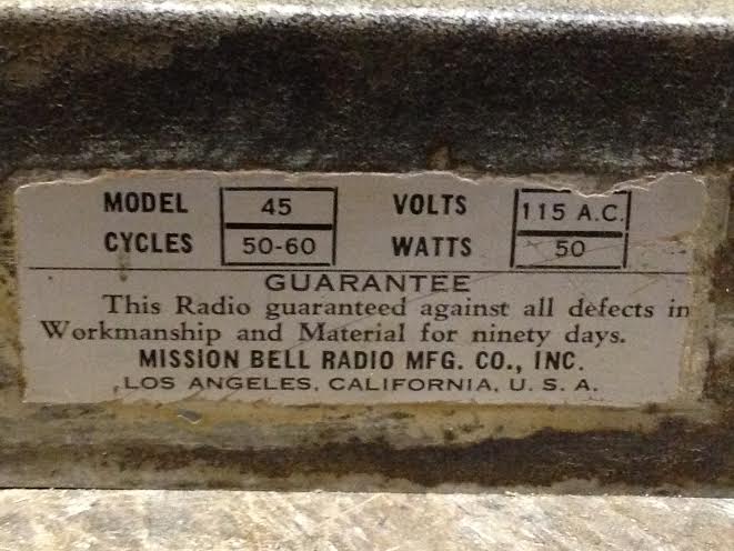

Kirk, the closest schematic I could find was a Mission Bell 41/41AW:
http://www.nostalgiaair.org/Resources/931/M0010931.htm
It's the same tube line-up so you might want to see if the pictures of the coils look close to yours. It might be a starting point. My Gernsback manuals didn't have anything.
Ok this is a mission bell radio, I got Silvertone from somewhere but I can't remember where.
I will look at the schematic:
Too bad the guarantee is up Icon_lol
Quote:...I got Silvertone from somewhere but I can't remember where...
It's a Silvertone made by Mission Bell for Sears and sold in California. A pretty rare set that you're doing a fine job of restoring:
