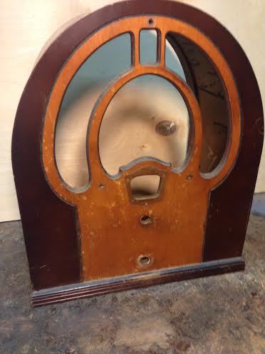

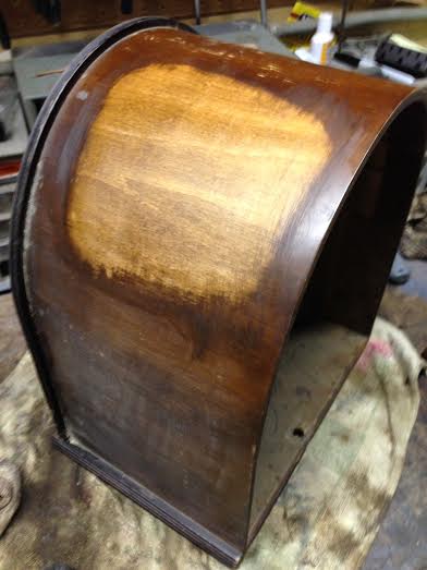

This is the Philco 80 Jr before:

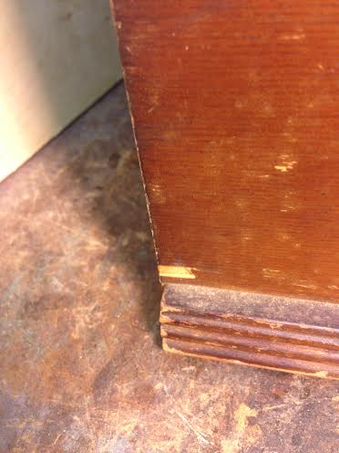

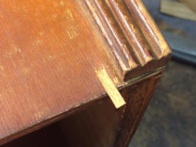

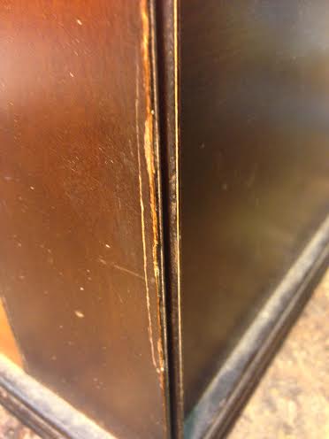

I will have to disassemble part of the base since there is a lot of play in the arch where it meets the bottom molding but I began by Veneering the one trouble spot with donor veneer. This should be a nice less problematic restoration..
Anyone have a good color scheme for this cabinet?

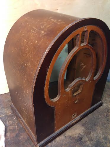

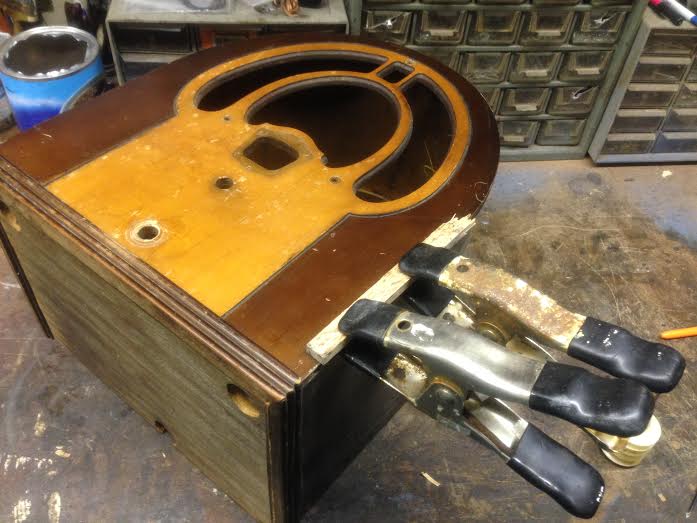

I got the veneering done and am finishing up the gluing today.
Then I can strip the cabinet.
is it me or does it look like that mask from "Scream"/"Scary Movie" ? Icon_lol

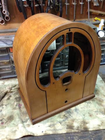

Stripped and ready for sanding sealer,Grain filling and then fine sanding.

This 80 is also smooth but I will grain fill just in case. It can't hurt and it doesn't take long.
Kirk

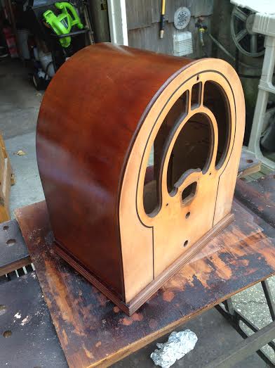

Toning time!
Got the first few coats of toner on the arch today.
