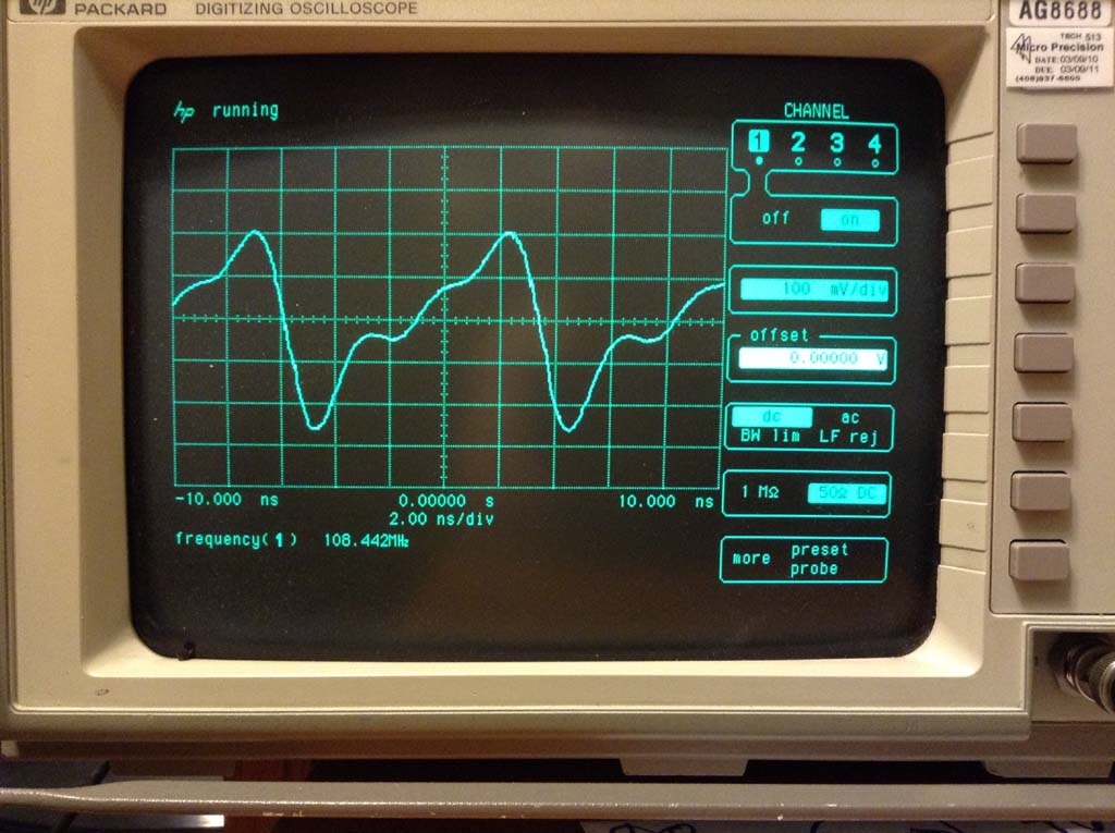

I do not have matching pads etc so I am not sure how this thing connects to the tuner.
I am able to see the output RF FM signal on the scope.
I use 50 Ohm BNC cable and 50 Ohm scope input.
The frequency seems right.
Without proper loads I am not sure if the signal is right.
Photo later, soon as I fire up my old P4 desktop.
The last one.
As you could see the frequency matches well to the settings.

Waveform looks badly distorted to me. Appears you have your scope set to 50 ohm input impedance, so that should close to a proper load. Not sure where I would look for the nonlinearity. Both of my gennys have nice sine wave outputs (unfortunately my expensive HP genny decided to lose something, so the output is way down on most frequencies now.  )

Yes, FM is that way. The rest of them, FM/AM IF and AM RF are fully sinewave.
The scope impedance (I used both hi-Z probe 10MOhm and straight coax to 50 Ohm) in fact did not change the wave shape much.
What I was wondering is if anyone has a similar Sencore and could look at the wave shape.

Well, question answered - a guy from ARF simulated the oscillator for me.
http://antiqueradios.com/forums/viewtopi...7#p2142687
So, I think the Sencore is just fine.
