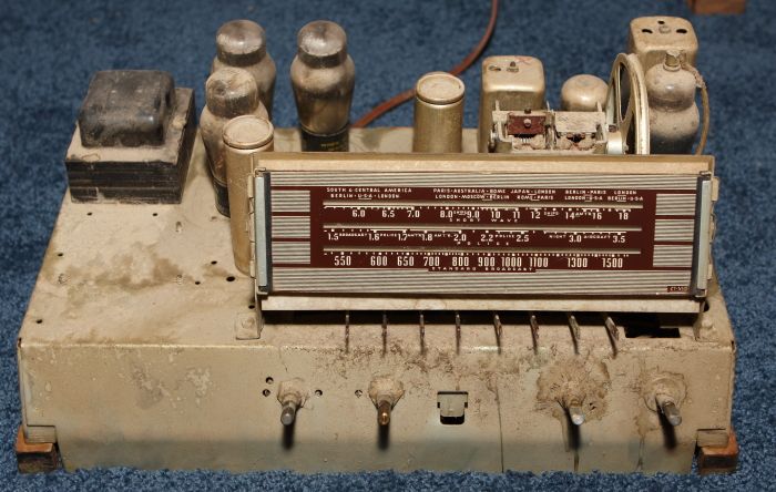

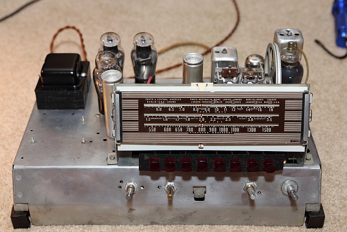

Just for fun, here are the before and after of the chassis rebuild.
First the topside:

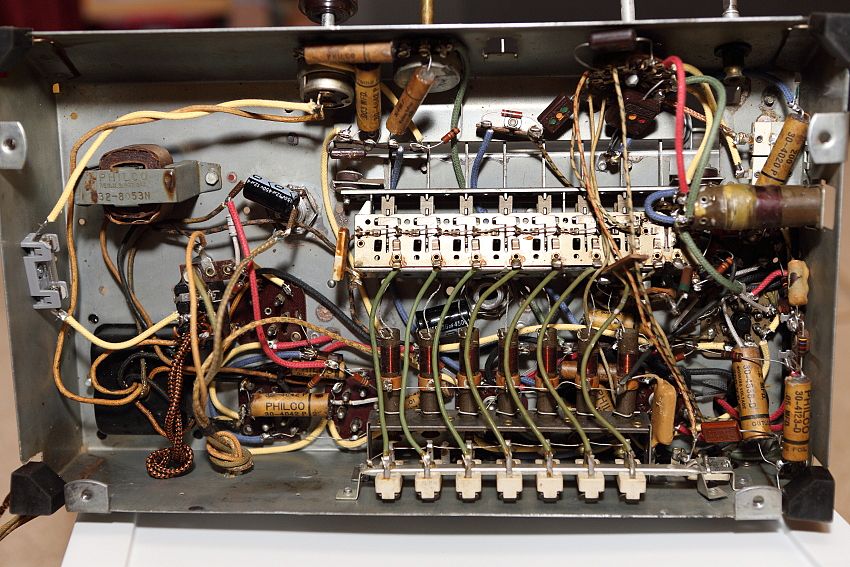

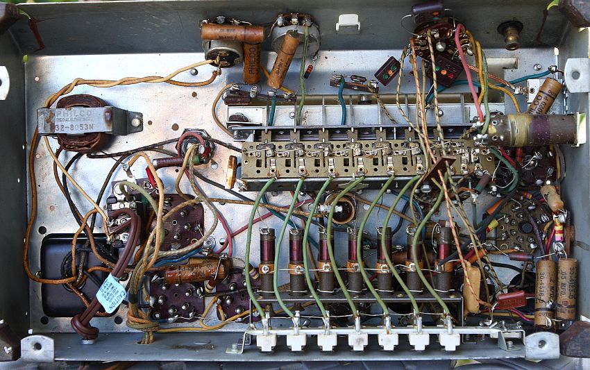

And the underside:
Not much difference on the bottom except for the new AC power cord and the new fuse. I even restuffed the old caps with new ones and hot glued the ends...
