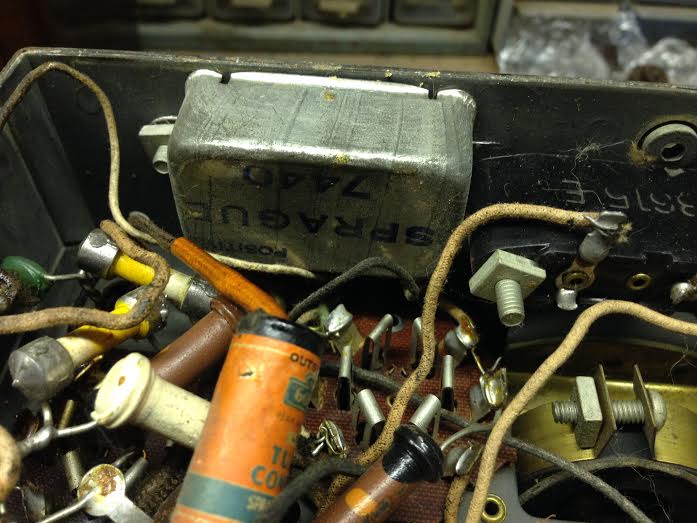

I took a look at the chassis and someone was in there already.
There is a Sprague mounted underneath the chassis which I believe is #11 on the schematic and is 10 uF. I have never seen one like this before so do i open it and put a new cap inside it?
I also see #5 but where is this? that many caps inside 1 can?
I see a long list of caps on the schematic but only see 2 blocks, 1 replacement cap (which is a .02 and could be a jimmy rig?), the Sprague, and the 2 Filter cap cans (#30 and #31 but don't see the values on the schematic?).

You do not open the Sprague.
Looks like an oil cap.
Measure it, if good - keep using it if it is what should be there, otherwise replace, but it might be a good cap nevertheless.

I think I'd replace that Sprague with a 10 uf capacitor just to be safe, or at least make sure what you test it with can measure leakage because that is a very old capacitor.

Last is the 10UF e-cap that is mounted to the side of the bottom. Should I use 160V or 450V?

If 10uF is the #11, then 160V is plenty. It can even be a small lytic, plus up, minus down (as shown in sch).
