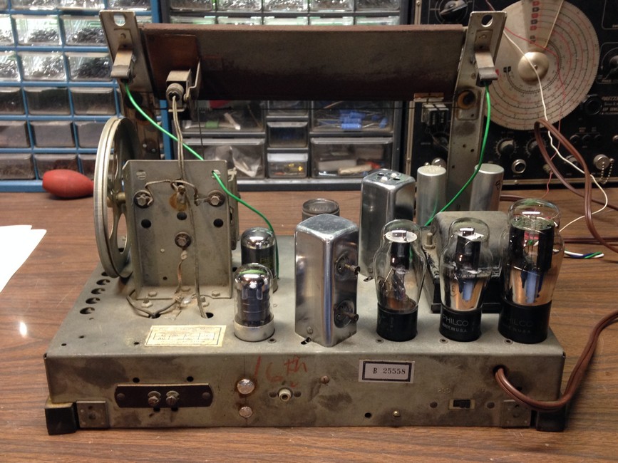

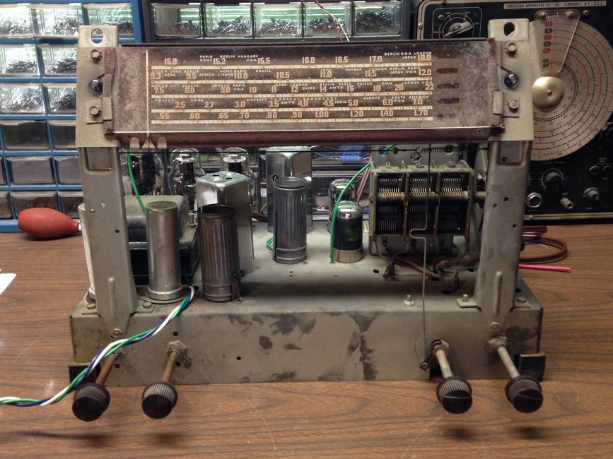

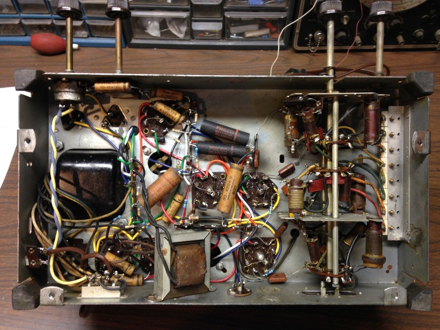

Well, I've done everything but attach the speaker connector to the new speaker wiring harness. Electrolytics reinstalled, audio output transformer reinstalled, new AC cord installed. I've tried it out with the 80 removed and everything lights up as it should.
Photos later. I'll probably try it out tomorrow afternoon.

Indeed it does, Ron! Excellent work
Seeing your dial glass, with the typical rotted and crumbling gaskets under the mounting clamps, reminds me of how I've been fixing that problem for quite some time now. I use rubber bands! A standard rubber band is the right width, so all I do is cut it apart, cut it into strips and apply with a light coat of spray adhesive. Works like a charm.
