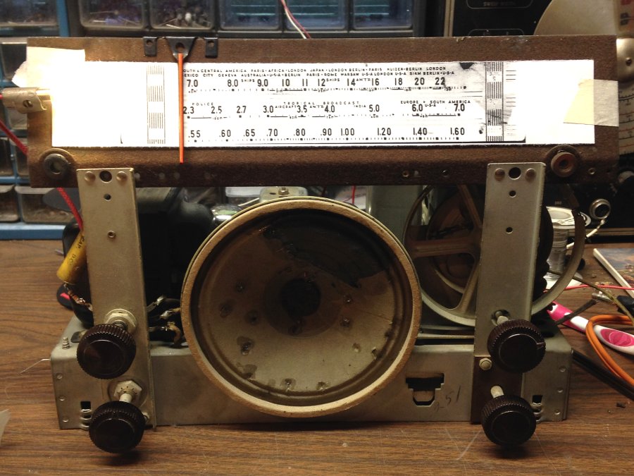

Philco apparently expected the service man to align the set inside the cabinet. But there is a problem with that - when in the cabinet, it is difficult if not impossible to reach all of the adjustment screws.
So I improvised - I took a photo of the front of the radio, focusing on the dial scale. Then, using Paint Shop Pro, I made a negative image of the scale, printed it, and temporarily taped it to the dial back plate for alignment purposes. This really made performing the alignment much easier. Icon_thumbup
The alignment was way off. Once the IF transformers were adjusted back to the proper 455 kc frequency, the AM band was then way, way off. A local station (WITZ, 990 kc) was coming in around 650. I could no longer hear my SSTRAN which is set at 660.
But once I went through the entire procedure, I not only managed to get the AM band more or less back on track (pun intended), the problems I initially experienced with very broad tuning at 660 and oscillation from 670 to about 750 kc disappeared. All three bands really came to life once the alignment was completed. As with every Tropic I have worked on so far, this one is very sensitive and is now an excellent performer.

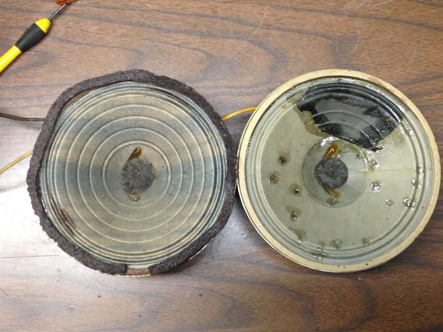

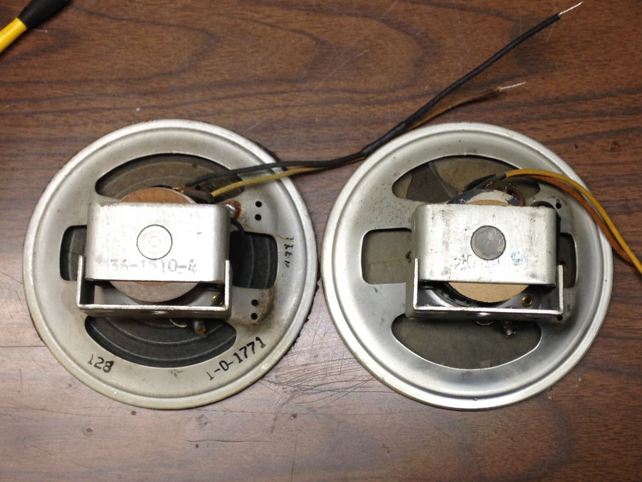

Sam was kind enough to send along a 41-240 speaker that is in excellent condition. Many thanks, Sam! Icon_thumbup
[Image: http://www.philcoradio.com/images/phorum...e00014.jpg]
[Image: http://www.philcoradio.com/images/phorum...e00015.jpg]
The 41-240 speaker is part no. 36-1510-4 while the 35A speaker is part no. 36-1504-something. Both appear identical and are electrically identical as well.

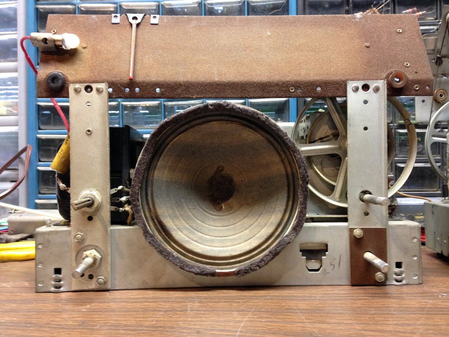

So after a few minutes of surgery, the transplant was complete:
[Image: http://www.philcoradio.com/images/phorum...e00016.jpg]
The "new" speaker sounds excellent. Mind you, the original speaker looks bad but also sounds good, so I'll hold it for future use.

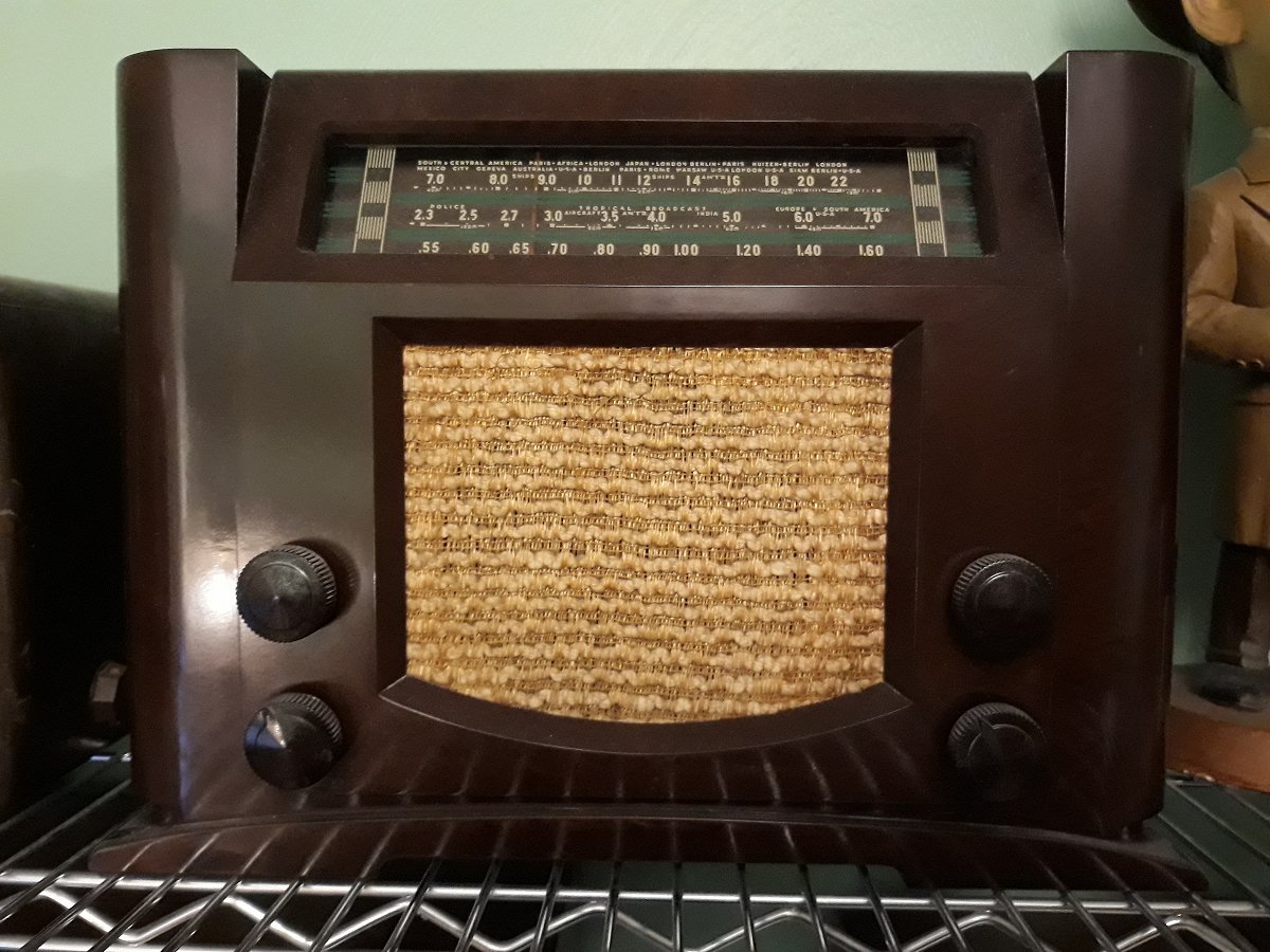

I found a 42-121CB at an antique shop in Corydon, IN a year or two after I finished the chassis of the 35A/41-712.
The 42-121's cabinet was in good shape. I did switch cabinets between the 42-121 and the 35A, so now the 35A has a nice looking, polished cabinet. I gave the 42-121 with the painted cabinet to Sam a couple years ago.
Here's the 35A as it has looked since the cabinet switch...
Looks really nice Ron.
Gregg Icon_thumbup
