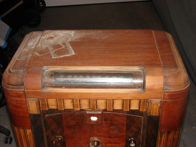

   I actually bought this last month , but I just received it.

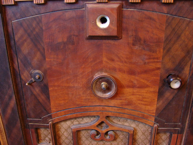

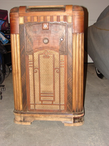

  it is a 1936 Rogers  model 6R932.  Someone had started to strip it and the marks on top are where they set down the can containing stripper.. I do have all the knobs and the cover for the tuning light.
    After I recap it and do the cabinet  it will be a keeper because these Rogers cabinet's are very nice ,made with
real wood..
a good looking SOB, for sure, and not too low in tube count, has potential.
Good find, congrats.

Nice looking radio , that's going to beautiful when your finished post pictures when done
Wow Dan, that has some lovely wood and a chassis that should be a great performer. We all wish to follow your restoration.
Best, Jerry
Very nice wood grain patterns on cabinet. Bet that dial will look sharp lit up in the dark. Good luck.
Mike your right great wood grain on the cabinet. I have not seen or heard one of these radios in person though. Hope it turns out great!

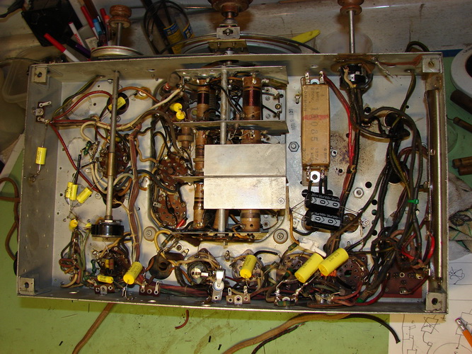

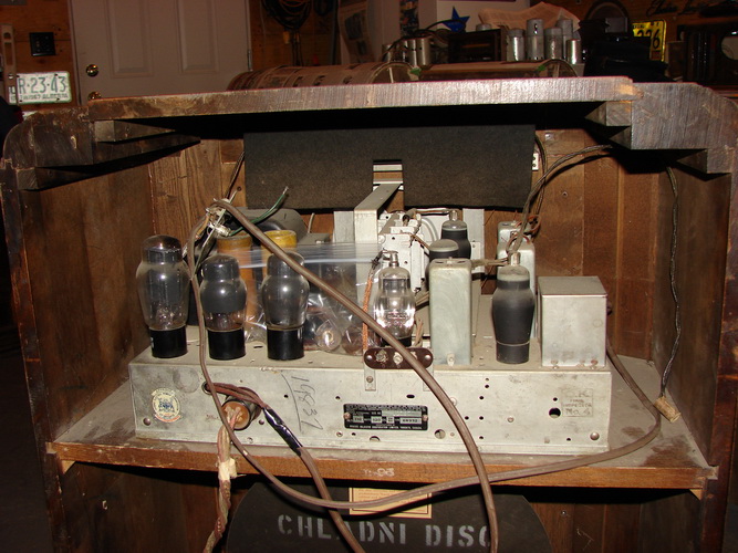

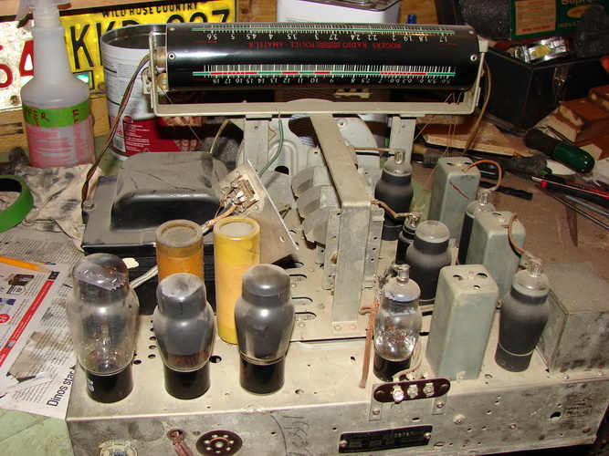

I will post photos as I go along. someone has been in the chassis and did a bad job of soldering and the work is quit sloppy.. I have checked it over and fired it up and it picks up stations all across the dial, so everything is there and working. After the caps and the bias cell it should perform quite well.. All of my Rogers set have a very nice sound. The more I work on these Rogers sets the easier it gets

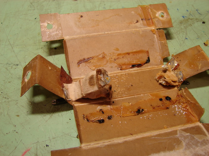

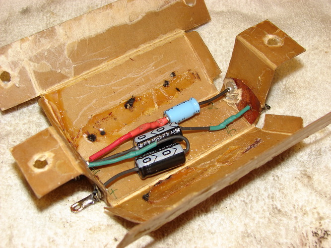

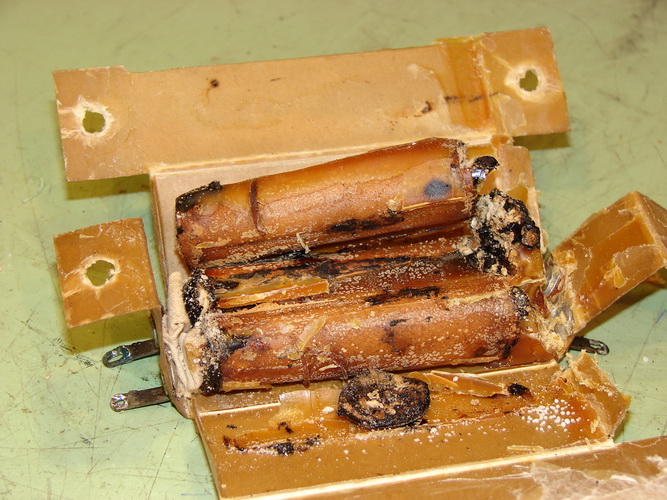

    I have this Rogers all recapped . All that is left to do is the cabinet.

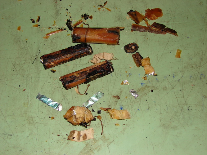

      Here are some photos of one of the cardboard boxes that contained three caps. The radio did work with this in it.
        The dial scale is in very good condition and now the radio plays very good.
